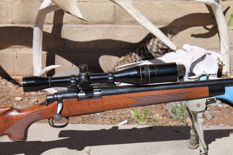

What are the specs on that? Looks handy!
Trued Rem 700
#3 contour Brux, 1-9" twist, fluted & finished @ 22.5"
McMillan Classic Edge in brown & black speckle, red recoil 1", ADL
Ti flute on bolt and Camfire bolt knob by Kampfeld
Graphite black Cerekote
Jewell trigger, Talleys.
Weight with scope is 7 lbs 4 ozs and balance is about perfect IMHO:)
Smith - Jon Beanland @ Beanland Custom Rifles,

I also delved into the 7-08 category. Will post a pic when I get it back from the smith. Mostly hunting rifle and went off the beaten path to a model 70. It is getting accurized currently. Stock hunting rifle loaded with 140 gr Berger reliable to 875 for me

Specs:
Defiance Rebel
Bartlein #3 1-9 twist finishing either at 22 or 23"
Jewel trigger
McMillan game scout
R&D DBM
I was really tempted to go with a 308, but did the 7mm since I'll use it mostly for hunting.
I have a 7-08 that Turbo has actually shot. The thing is a hammer and every once in a while I get a wild hair and think about selling but I just can't do it. It's old faithful and the caliber's ability to buck wind is huge. I have come to the conclusion it will always be my main rifle for most competitions. Only complaint currently is that brass is a PAIN to hund down at the momment. If we could only keep the 260 guys from stealing our brass we'd be set.
BTW I run the 162 BTHP at 2780fps out of a 26" McGowen 1 in 8 twist. I believe the 8 twist is ideal because it can stabolize anything all the way up to the 180s.
