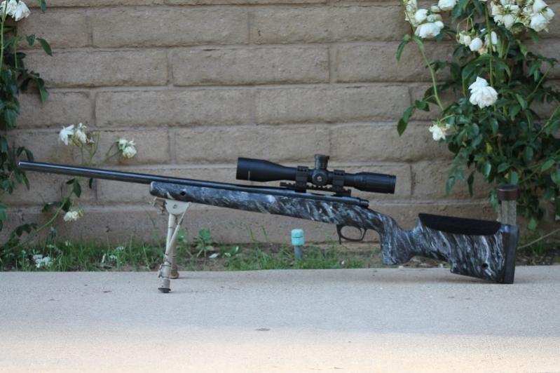

My "non-typical-ish" in 7-08 is now one of my favorite rifles to shoot. Rem 700, Bartlein 1:8.7 @ 24inches, Manners SL, APA RTG DBM. Mighty fine package. Flings the 140 Berger VLD right at 2800fps with Varget in a Winchester case into tiny groups at 200yds. Tough trying to decide if it'll be enough for Elk, or maybe just stick with the .300WM....

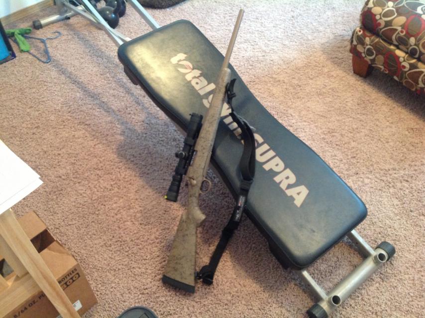

I get 2,800 with a 140 in my 22" barreled 700 Mountain Guide. This is just me but if I want 2,800 out of a 162 I'm going up to a 280 AI...
