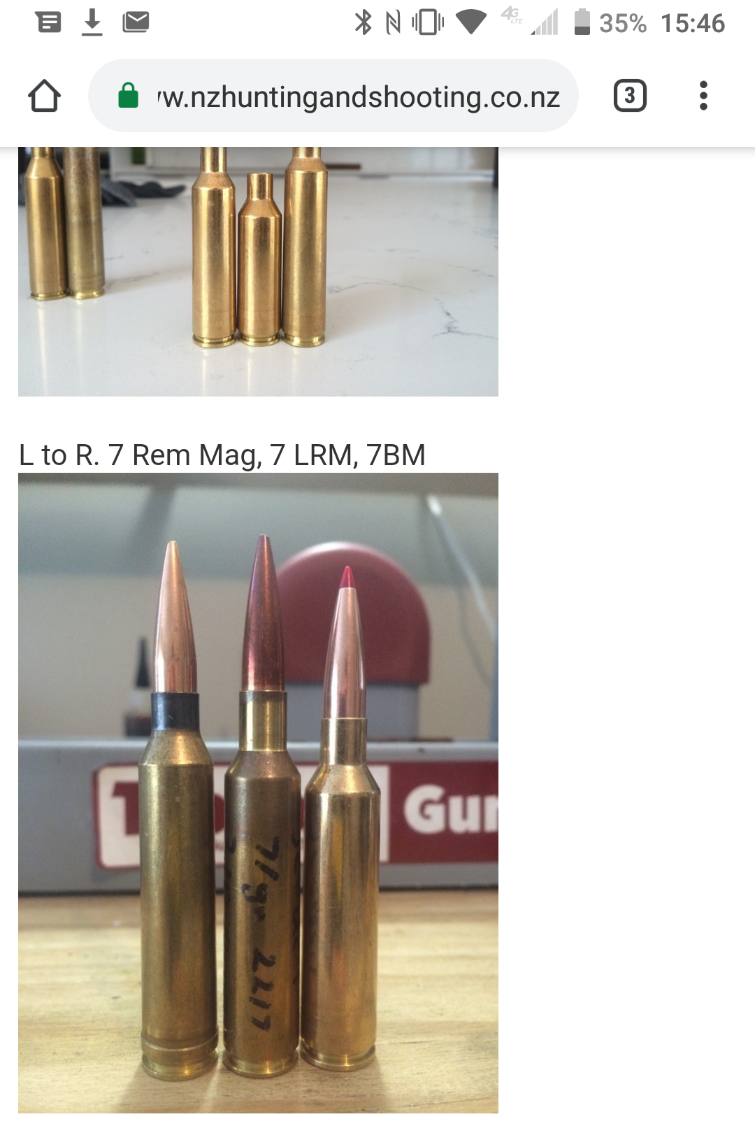

I’m curious if anyone has taken the 300PRC (necked down 375RCM) and necked it down to a .284 or .264 caliber bullet?
I’m interested in trying out a wildcat for my next build...
You guys think it would be too much case capacity for a 6.5mm or 7mm bullet?
7 LRM by Gunwerks.
Left to right:
7 RemMag, 7 LRM, 7 Blazer Mag
