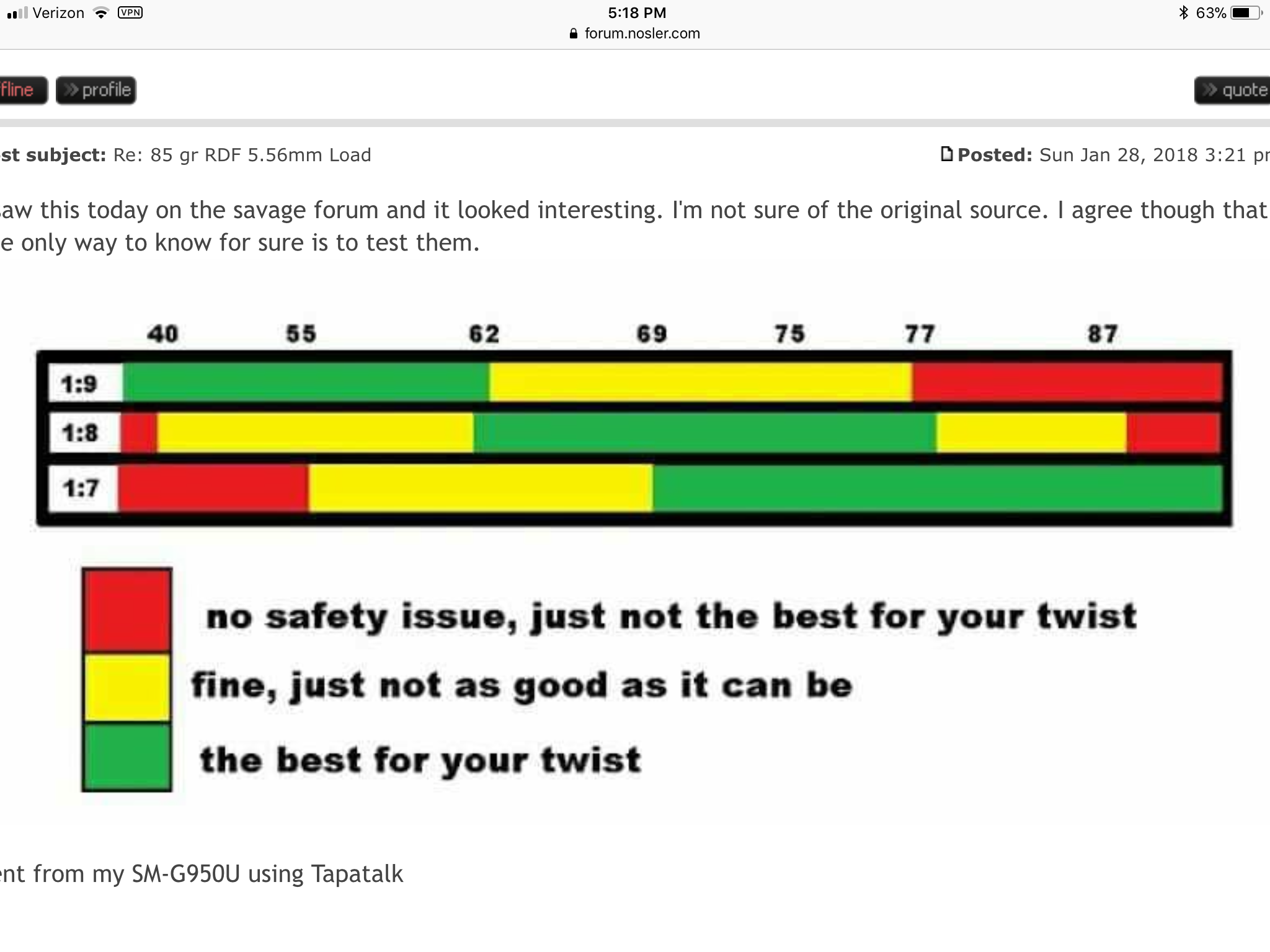

    Got this off another site years ago. It’s a decent generalization.
