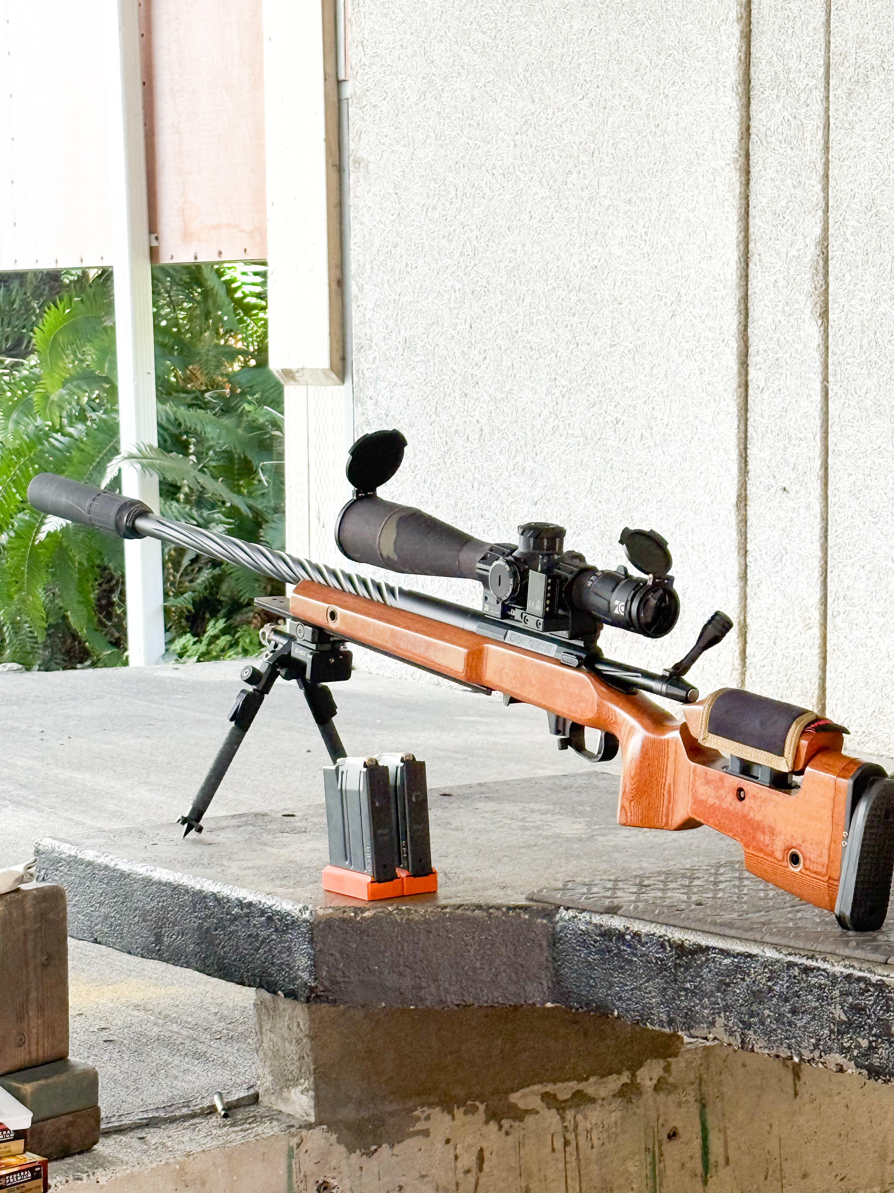

My 223 is an Impact/CRB/ Foundation Centurian. What is the plans for this rifle. Hunting, that would work for a Carbon barrel. Match use probably go with a conventional barrel. With a carbon barrel this will be a tail heavy rifle. Go for a .080 - .100 if you plan to spot anything longer than a 77smk. If

My 223 is an Impact/CRB/ Foundation Centurian. What is the plans for this rifle. Hunting, that would work for a Carbon barrel. Match use probably go with a conventional barrel. With a carbon barrel this will be a tail heavy rifle. Go for a .080 - .100 if you plan to spot anything longer than a 77smk. IfView attachment 8669638
That is one pretty rifle i have to say... always liked those stocks

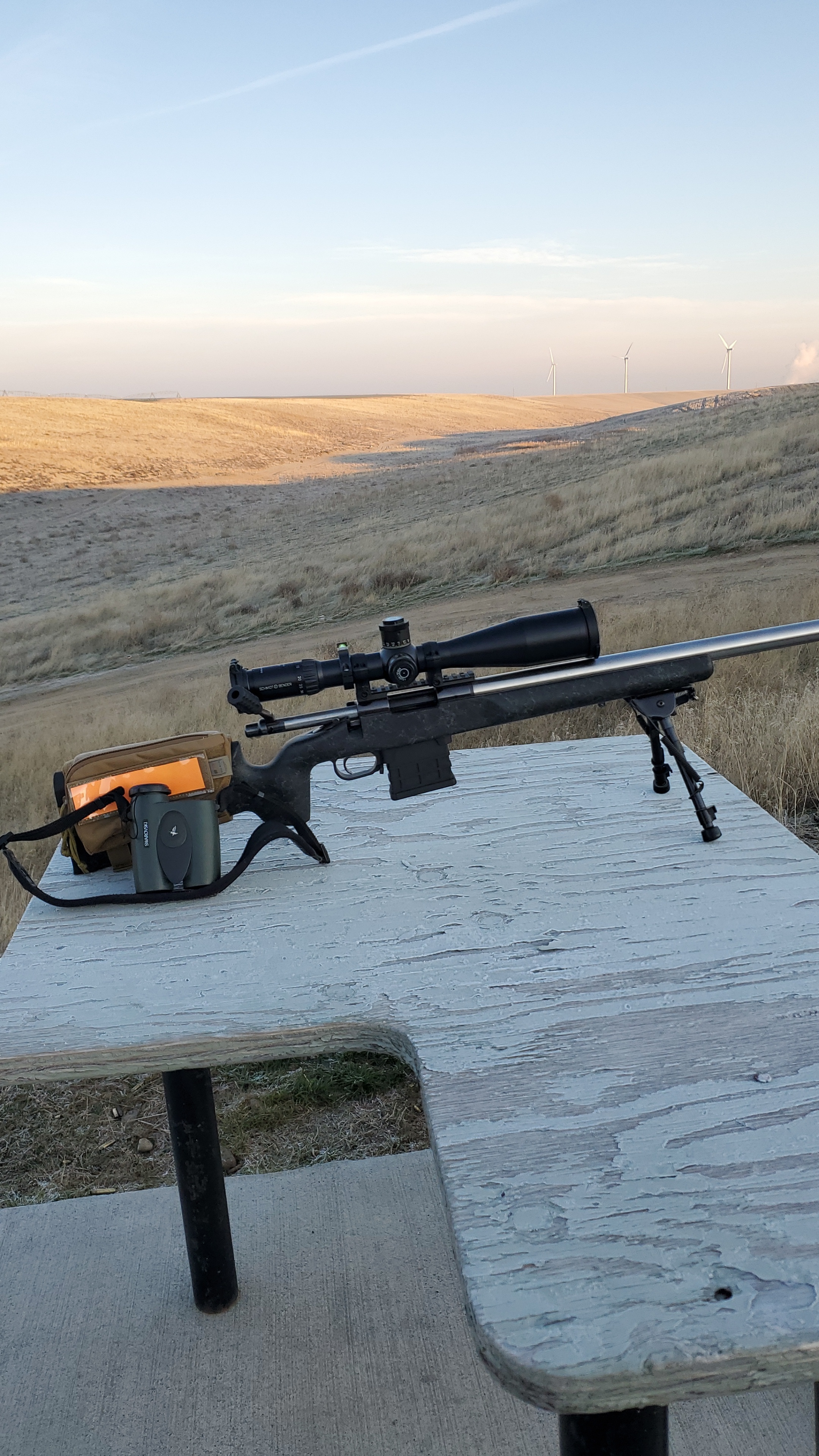

A few thoughts. My background on the subject:
  • Past owner of a .223 Tikka T3x Varmint upgraded with MDT 20MOA rail, LSS-XL chassis, ARCA rail, Anarchy Outfdoors bolt handle.
  • Currently VERY pleased with Terminus Apollo-based custom .223 with Bartlein 1:7 barrel and TriggerTech Diamond in MDT ACC chassis. Current optic is Vortex gen-3 Razor 6-36x56 on 20MOA rail.
  • I also have a .223 bolt and barrel for my Defiance Deviant-based rifle, but since I built the Apollo-based rifle with much help from a prize table cert and Black Friday sales, those bits have gone unused (the Defiance usually wears 6BR or 6.5CM barrels).

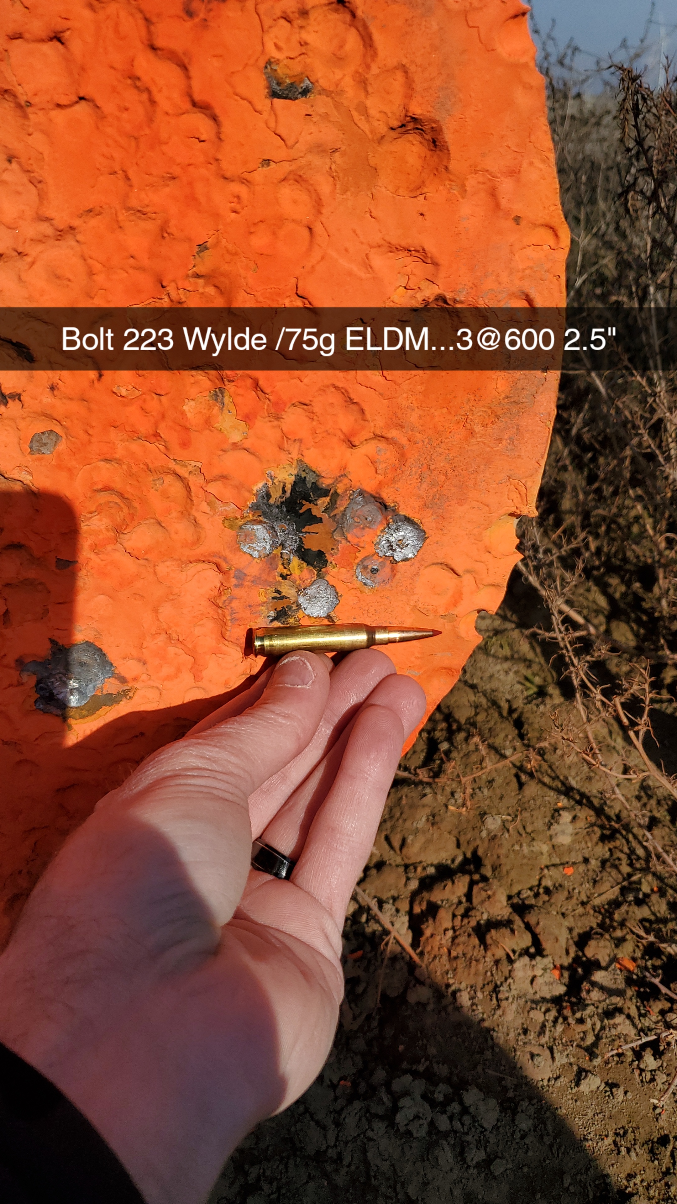

    • I regularly shoot to 1000 with Hornady 75 ELDMs running about 2850fps. I can easily get more velocity, but this bullet with 22.8 grains of N135 and CCI 450 primer gives a relatively inexpensive load that is fairly gentle on the barrel and brass and is as accurate as any load for any caliber I've ever messed with.
    • This load's trajectory is nearly identical to my 6BR out to 700ish yards.

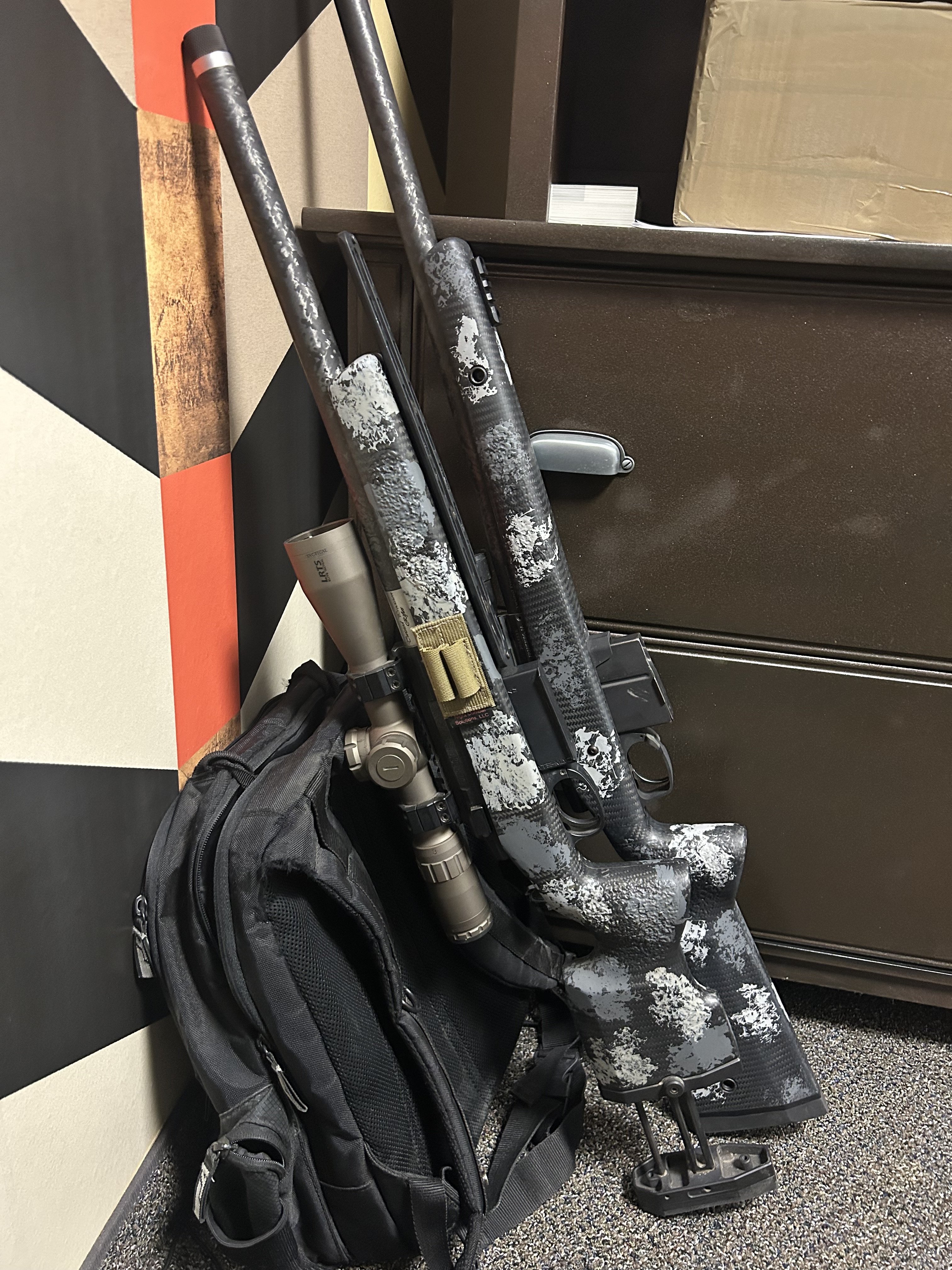

I have an 7.5 twist Bartien carbon 20” in 223 AI, currently having the throat lengthened a bit as the original chamber didn’t leave me much room to seat bullets out. Are you having any problems with the AI feeding from the magazine?

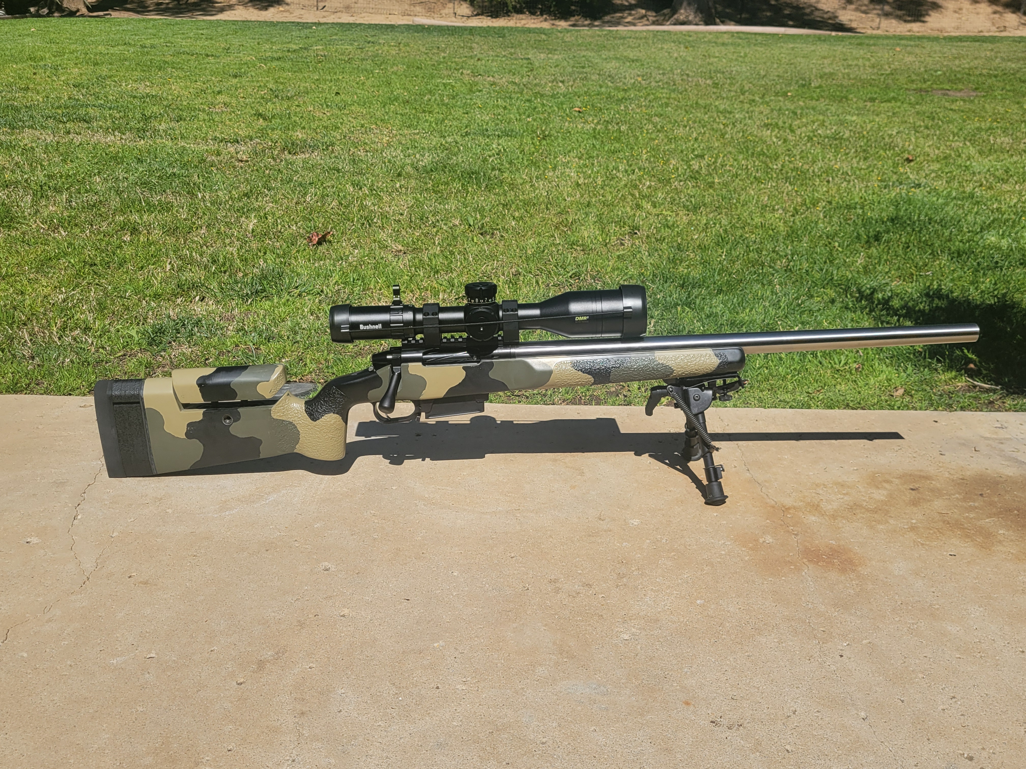

I shoot a 223 Wylde in a R700 with a 28" Bartlein 8 twist, in a Grayboe A5 style stock using poly MDT mags. Timney trigger set at 1.5# S&B PMII 10-50x. It has a custom .080" Freebore and I shoot the 75g ELDMs at 3000fps with N540. Loaded rounds are 2.480" It does fairly decent out to 1K as long as the wind isn't blowing to hard. Definitely one of my favorite rifles to shoot.

To touch on freebore and give an example, I use 75 ELDs and with the .62 wylde chamber I am at 2.470” at .020” off the lands. Fits fine in the MDT mags which can take to 2.550”. Figured I would toss that out to give an idea for people wanting to pick a chambering and using similar weight bullet.
