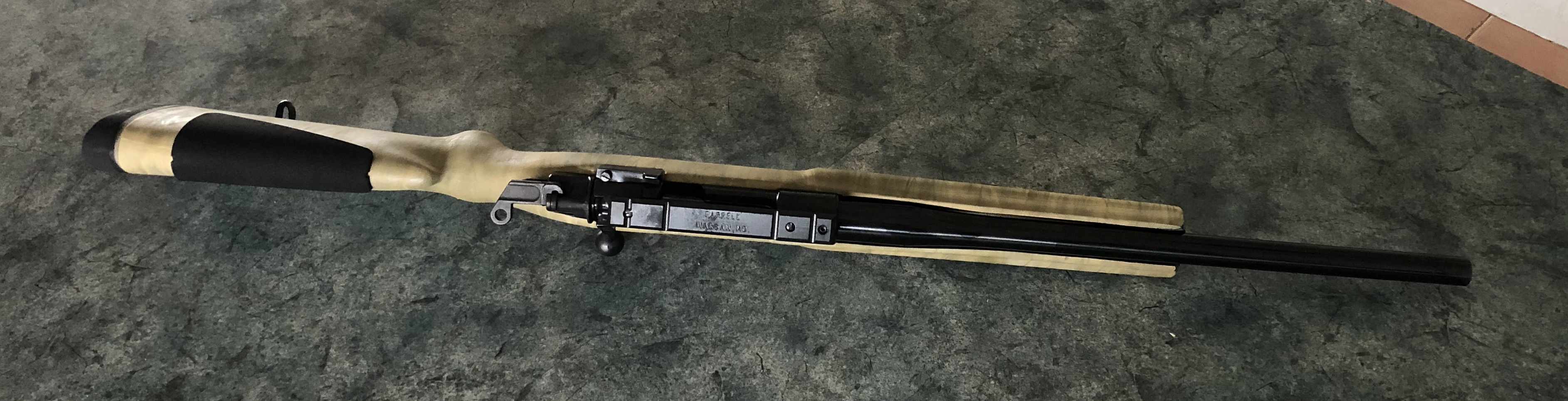

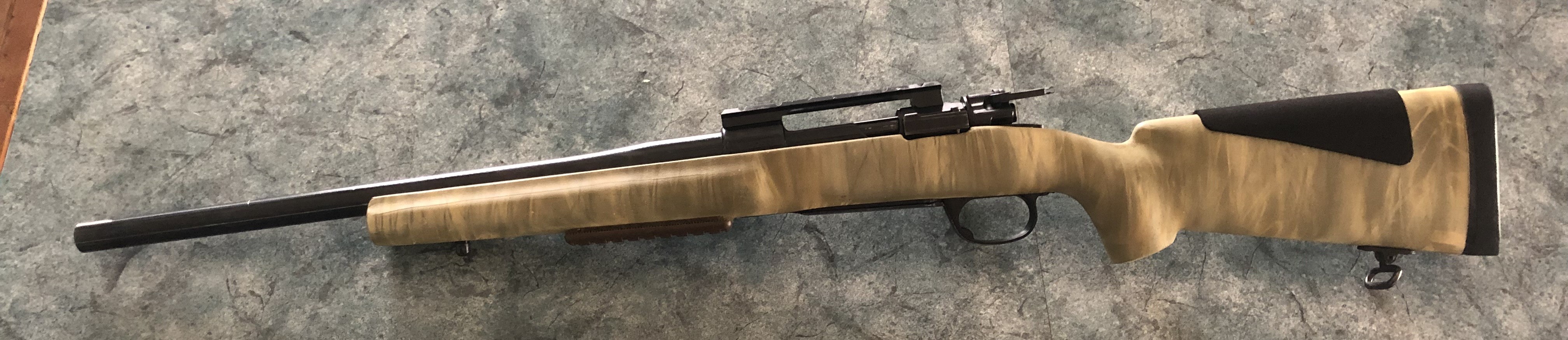

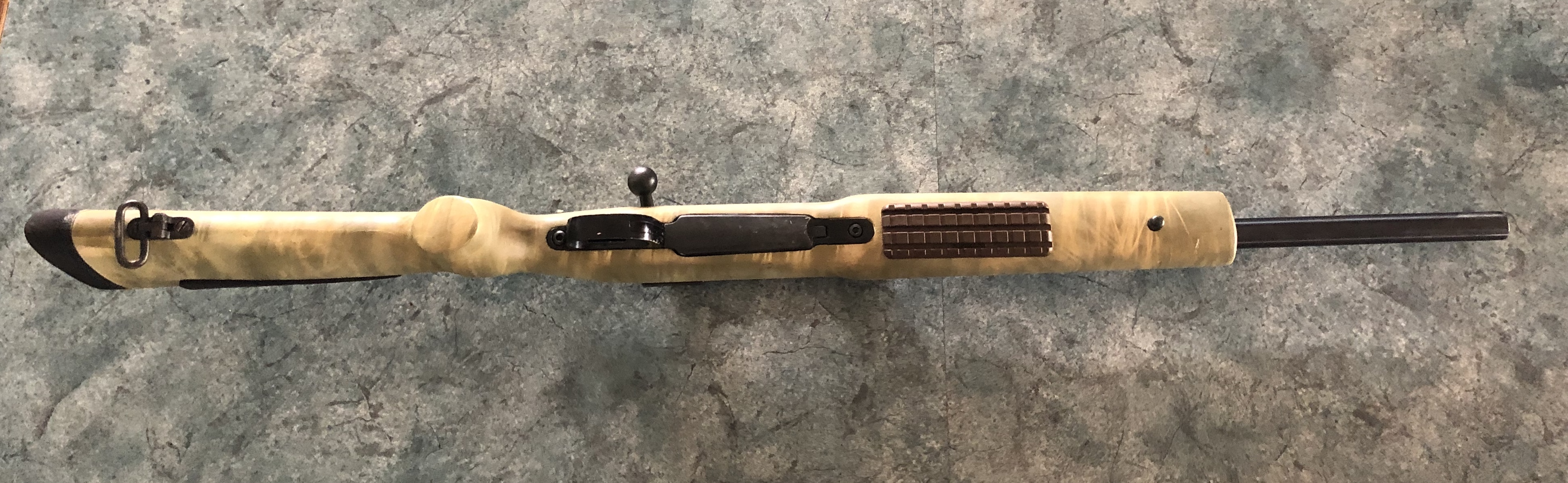

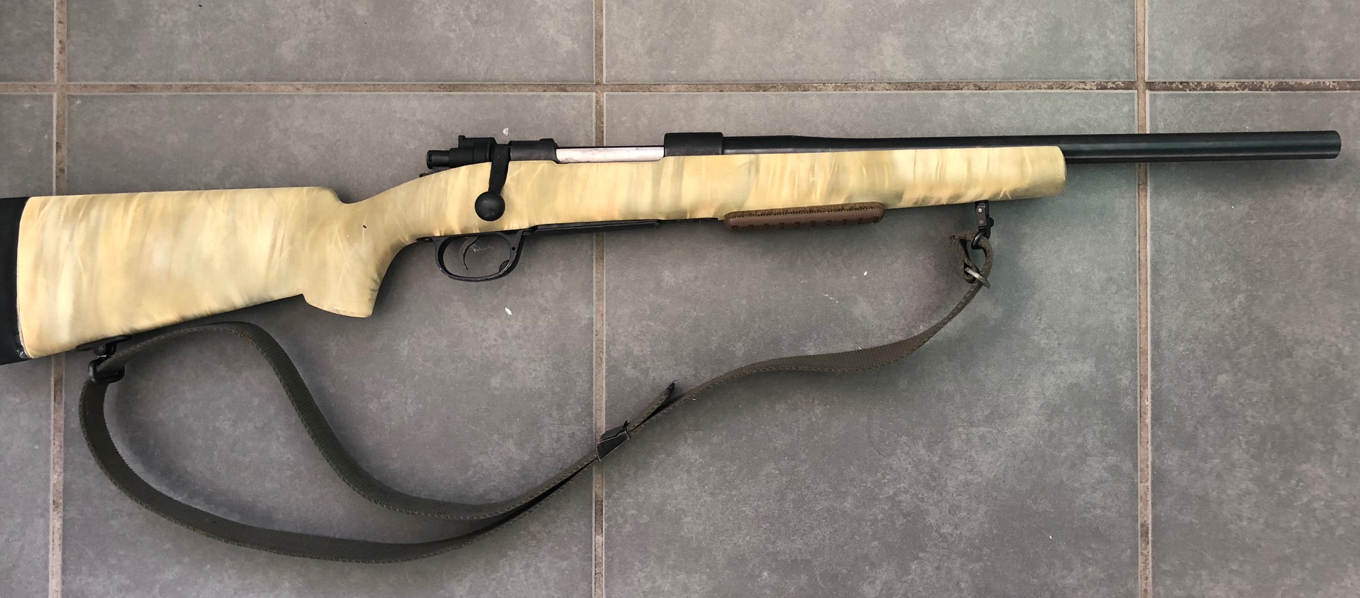

I built a rifle off a pretty rough loose Mauser action that had already been drilled and tapped, dirt cheap.
I ordered a pre chambered Lothar Walther .308 barrel and shortened to 18".
Locally made stock by TRM which is similar shape to HS 700P stock.
Fitted a K98 2 stage trigger, used farrell rail, Parker Hale hinged floorplate.
Black oxided the action and bolt, barrel came blued.
All used parts from bargain bins and the thing shot very well.

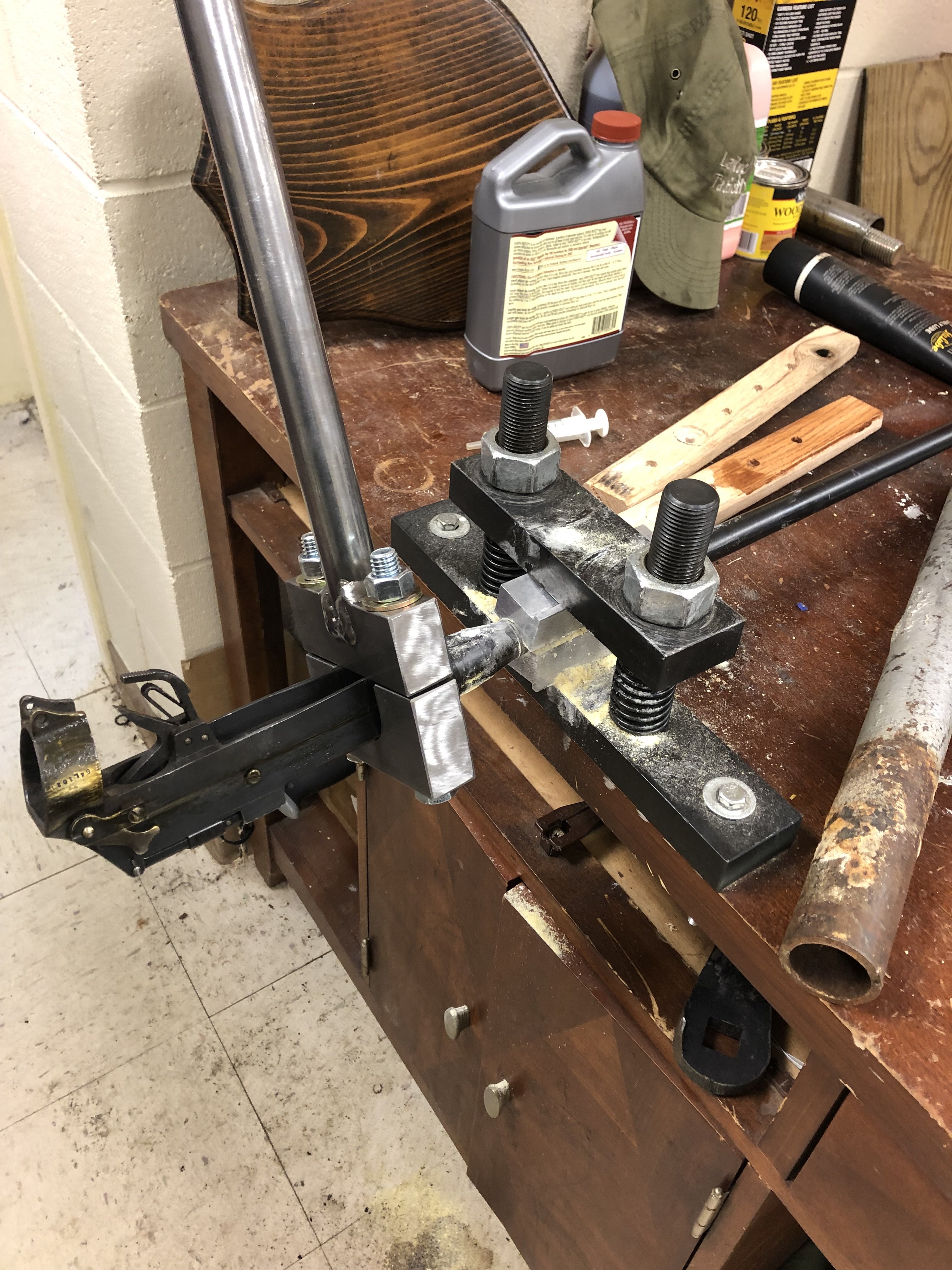

You bastards are just trying to turn me into a gunsmith aren't you...

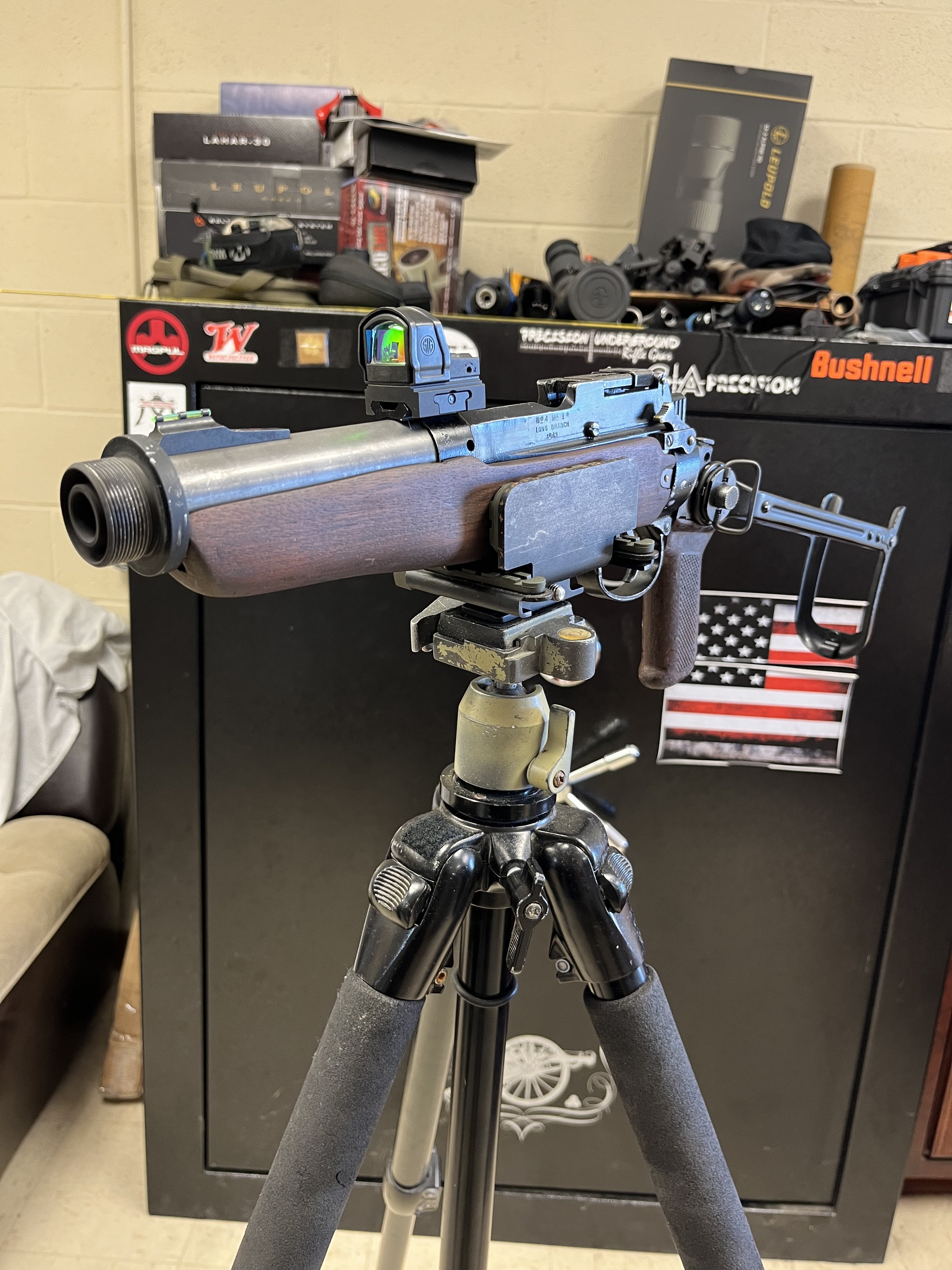

That is an ugly hack job of a nice rifle. Even though you were trying to build a DeLisle.
It was a shitty two groove barrel that needed to be wrapped around a telephone pole cause it was trash. The wood had been butchered long before I bought it and it had no sights whatsoever.
Ugly is such a mean word. Try something else and I wasn’t trying to build a delise. I was trying to use the 45 acp conversion kit I had laying around, it runs and shoots absolutely amazing

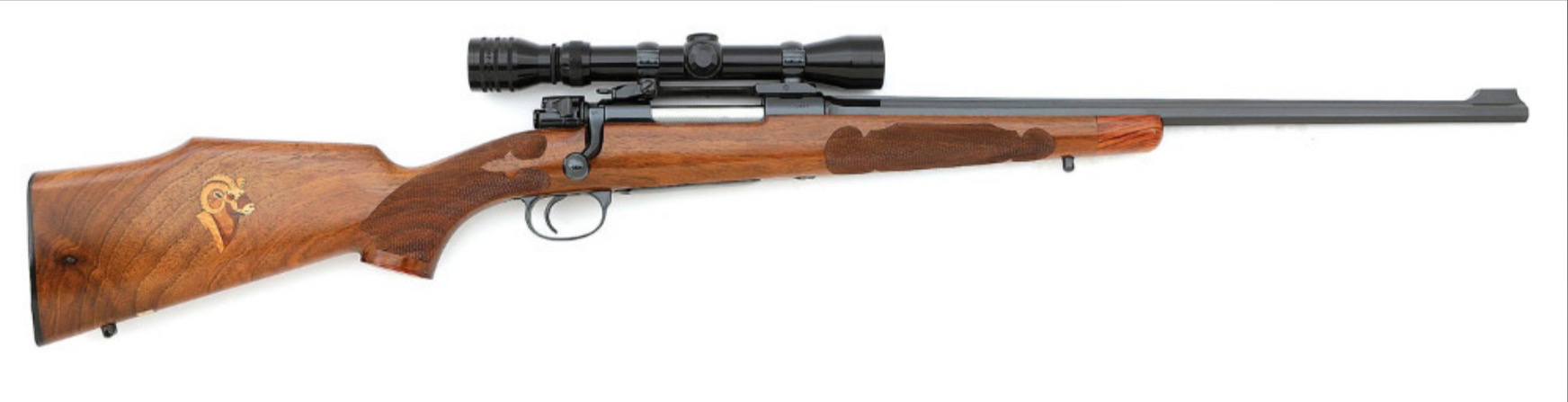

Mauser style build on EddyStone action. In the style of Rigby. From a few years ago. Still not hunted with it. But it is lovely!
Cheers!
Sirhr

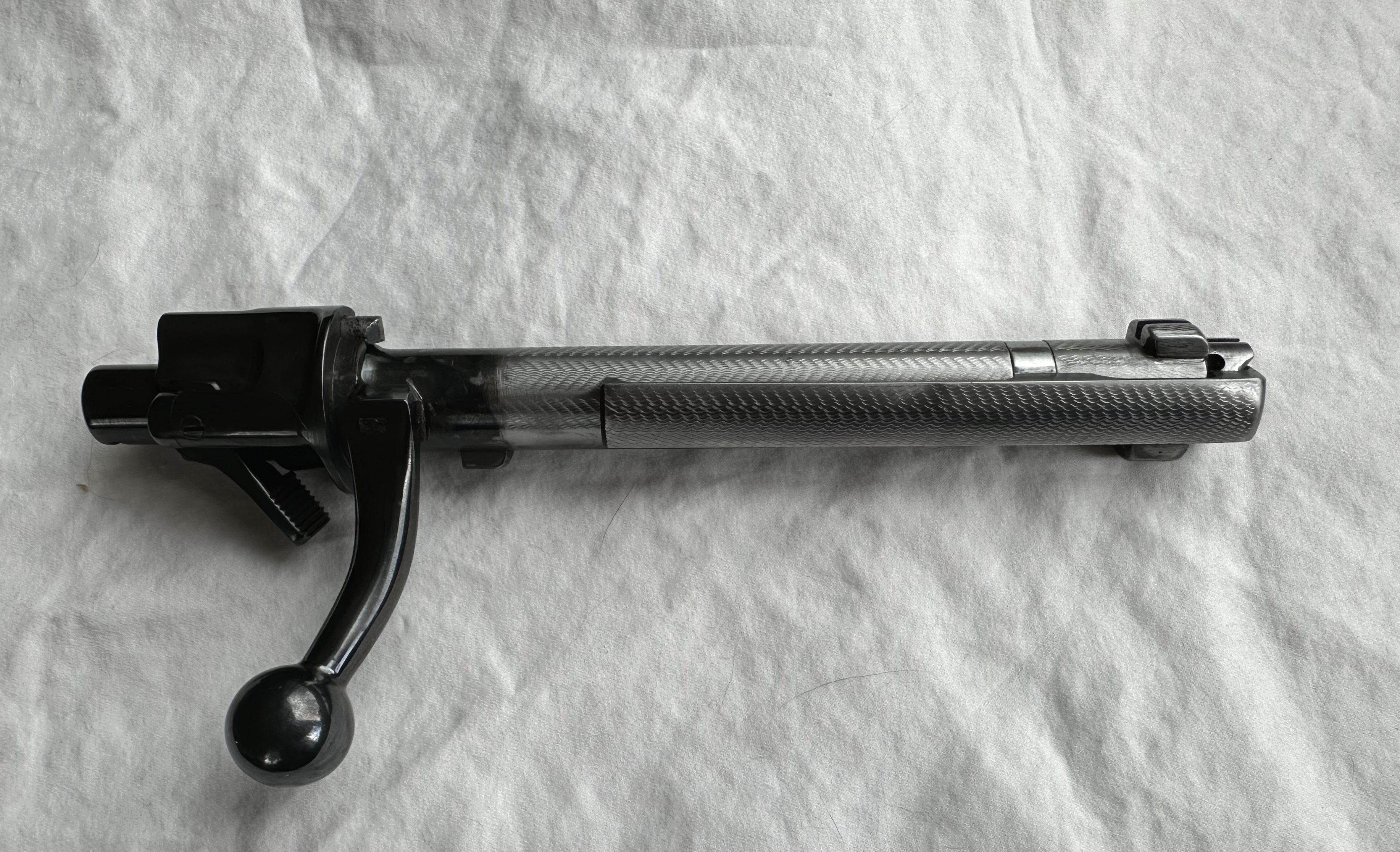

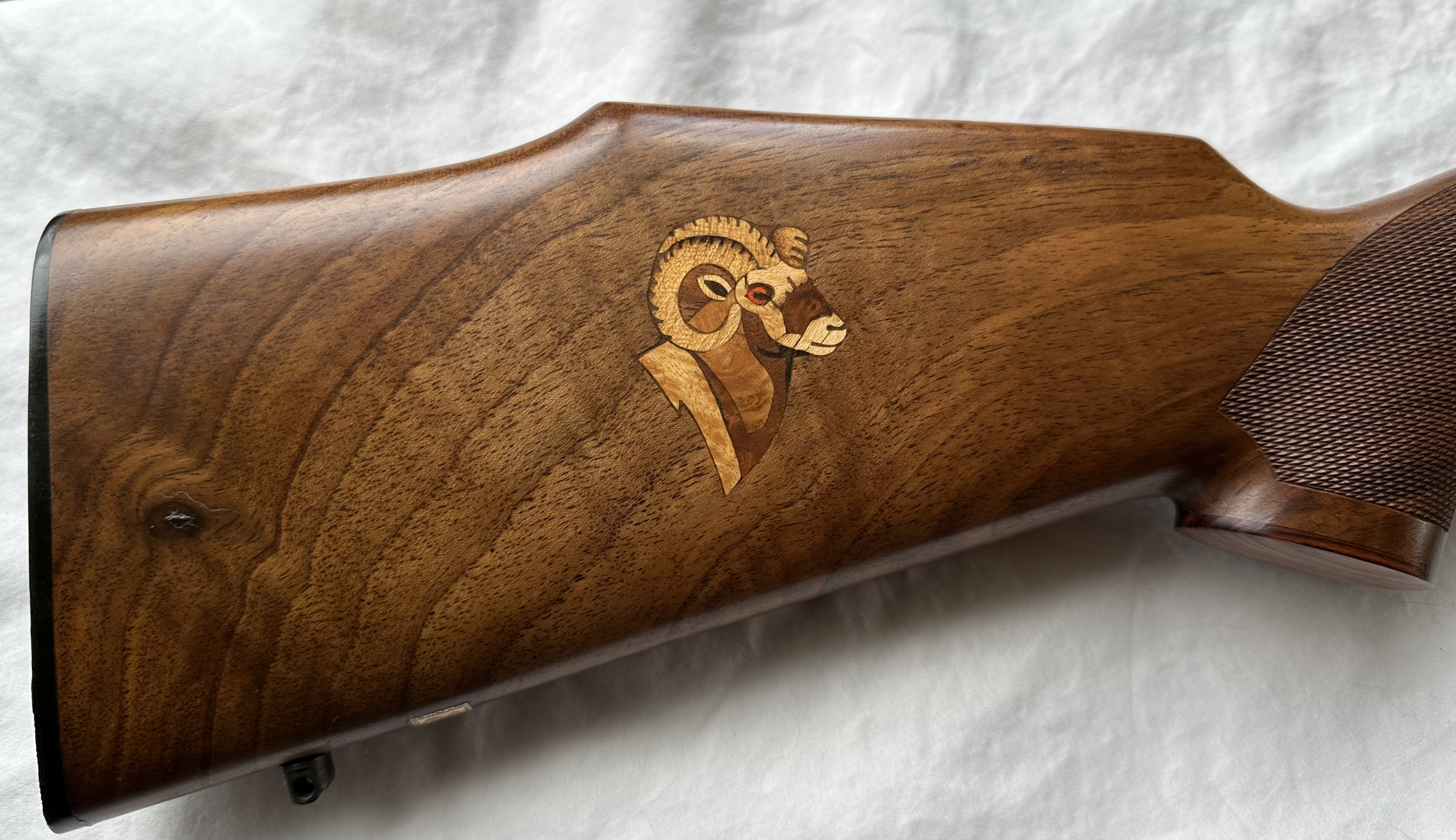

I didn’t build this - Roy Vail did. Mauser action with a tapered octagon barrel in 7x57 Mauser. Just giving you guys something to aspire to…
I confess that I didn’t even realize that the bolt is not jeweled until I got it home. It is engraved in a very fine, shallow herringbone pattern including on the extractor.
