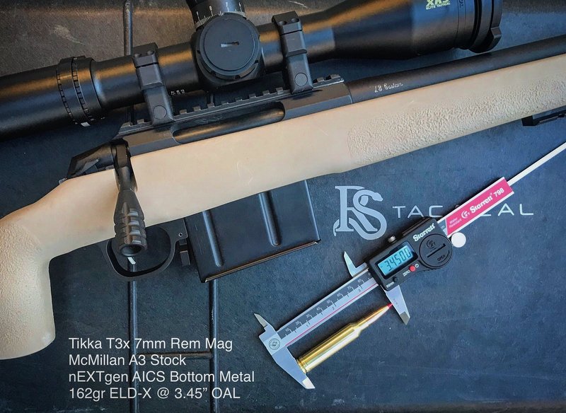

    I have a Tikka action laying around with a magnum bolt face and I’m tossing around ideas for a hunting rifle, has anyone tried the 7mm LRM on a Tikka, I am curious if the action would be to short. I may end up just doing a .300 wsm as a long action if length is an issue with the bigger 7mm’s

    whats coal for 7lrm? red snake has dbm for t3 that can go 3.5"
    searched a little: Gunwerks just gave me their data for 180 hybrid. H1000, 70.5 grains, fed 215, OAL 3.430"
    at least with the RS DBM, doable, and I have a tikka at home I might want to tinker with. got me thinking now.

    From some basic looking I've done, it looks like an OAL of 3.43 with Berger 180s is realistic with 7 LRM without intruding on powder capacity too much. I don't know about the 195s.

    I have one. Shoots the 195s great.
