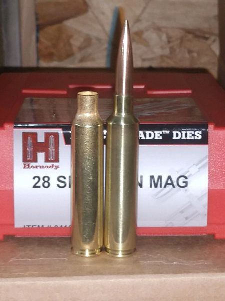

Another option without the wait Would be to just build a 28 Sherman. It’s a 300 PRC necked to 7 with a 40 degree shoulder & a little less body taper.
That’s my plan. Have action & a cip mag chassis already, but 308Win Tac class build comes first.
If they release a 7PRC great, then you can shoot factory ammo in the Sherman to fire form just like the 30 Sherman with 300PRC.
Till the 7PRC is released, 28 Sherman head stamp ADG brass and dies are in stock.

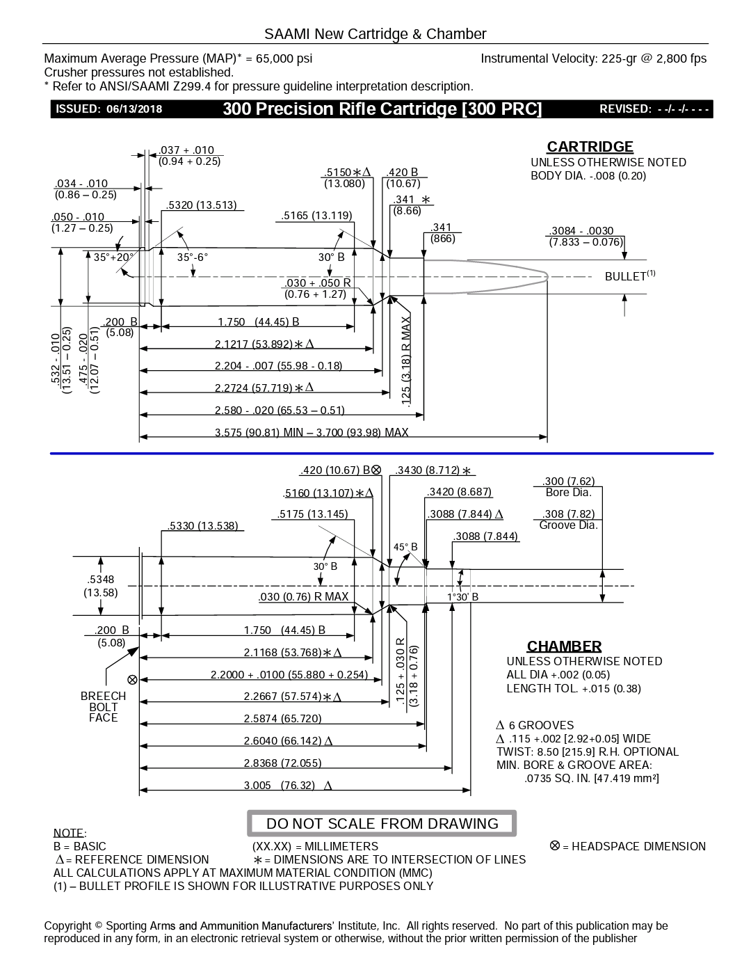

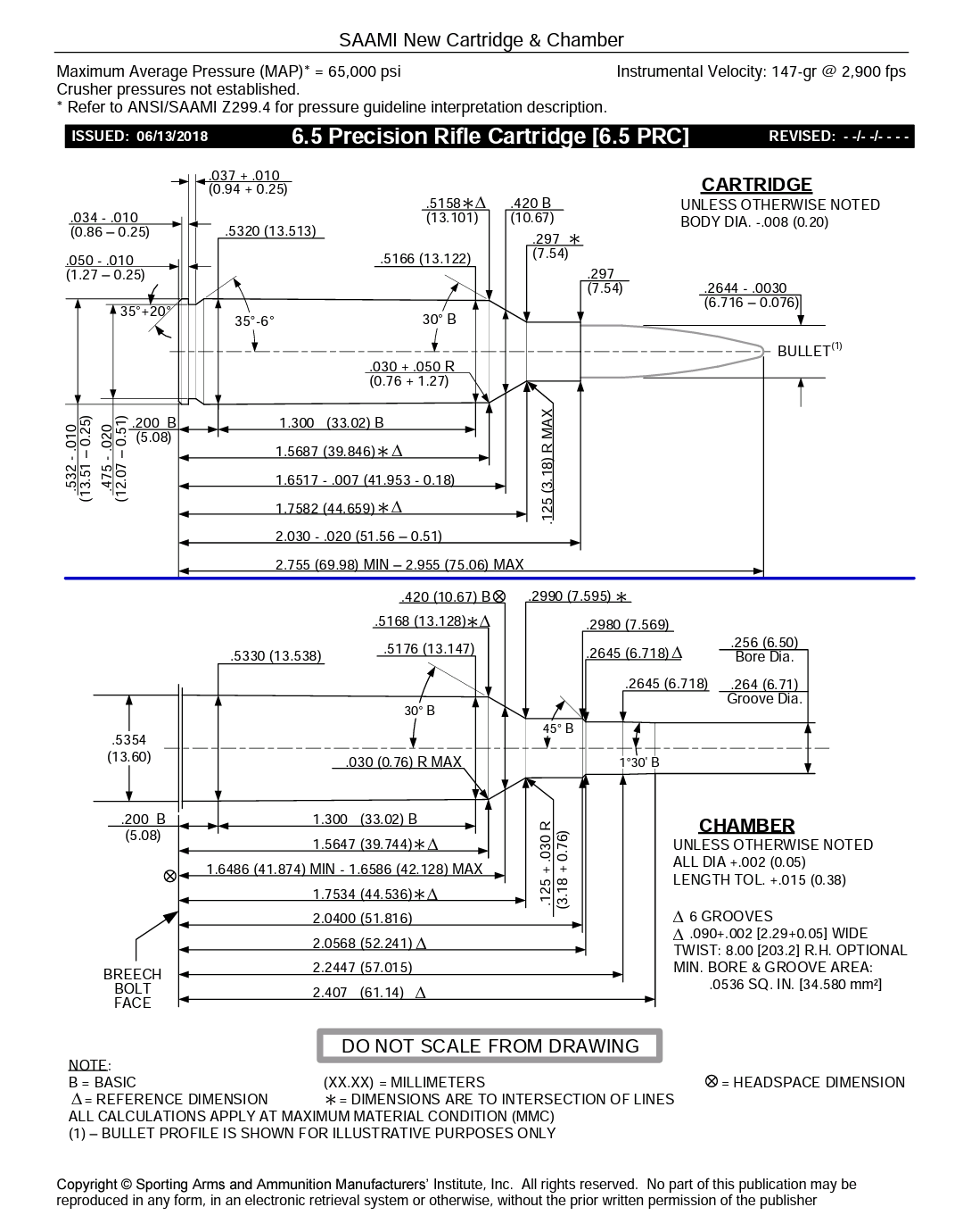

The saami 7prc. It's actually a dang near knock off of the 7 blaser mag thats a design back from 2011. The 300 & 338 blaser mag case dimensions were pretty much taken by Nosler when the 28/30/338 noslers came about. Nothing new here.......
Removed images, guess I wasn't supposed to be sharing them. @Gtscotty if you'd do the same over on accurate shooter I'd appreciate that. If not, whatevs
The saami 7prc. It's actually a dang near knock off of the 7 blaser mag thats a design back from 2011. The 300 & 338 blaser mag case dimensions were pretty much taken by Nosler when the 28/30/338 noslers came about. Nothing new here........attached first is 7prc, second is 7 blaser.
View attachment 7891944View attachment 7891945
Interesting, it's still not on the SAAMI new cartridges page, where did you find it? Do you have the cartridge drawing as well?
Looks like it's not a straight neck up of the 6.5 PRC or neck down of the 300 PRC.
Also not exactly a 7mm LRM.
Don't think I've ever seen a rifle chambered in a blazer cartridge, or a even a Blazer cartridge itself, so the PRC being similar to an unobtainable pre-existing cartridge is neither here nor there for me. The case size itself looks interesting to me, in between the 6.5 PRC and the LRM.
