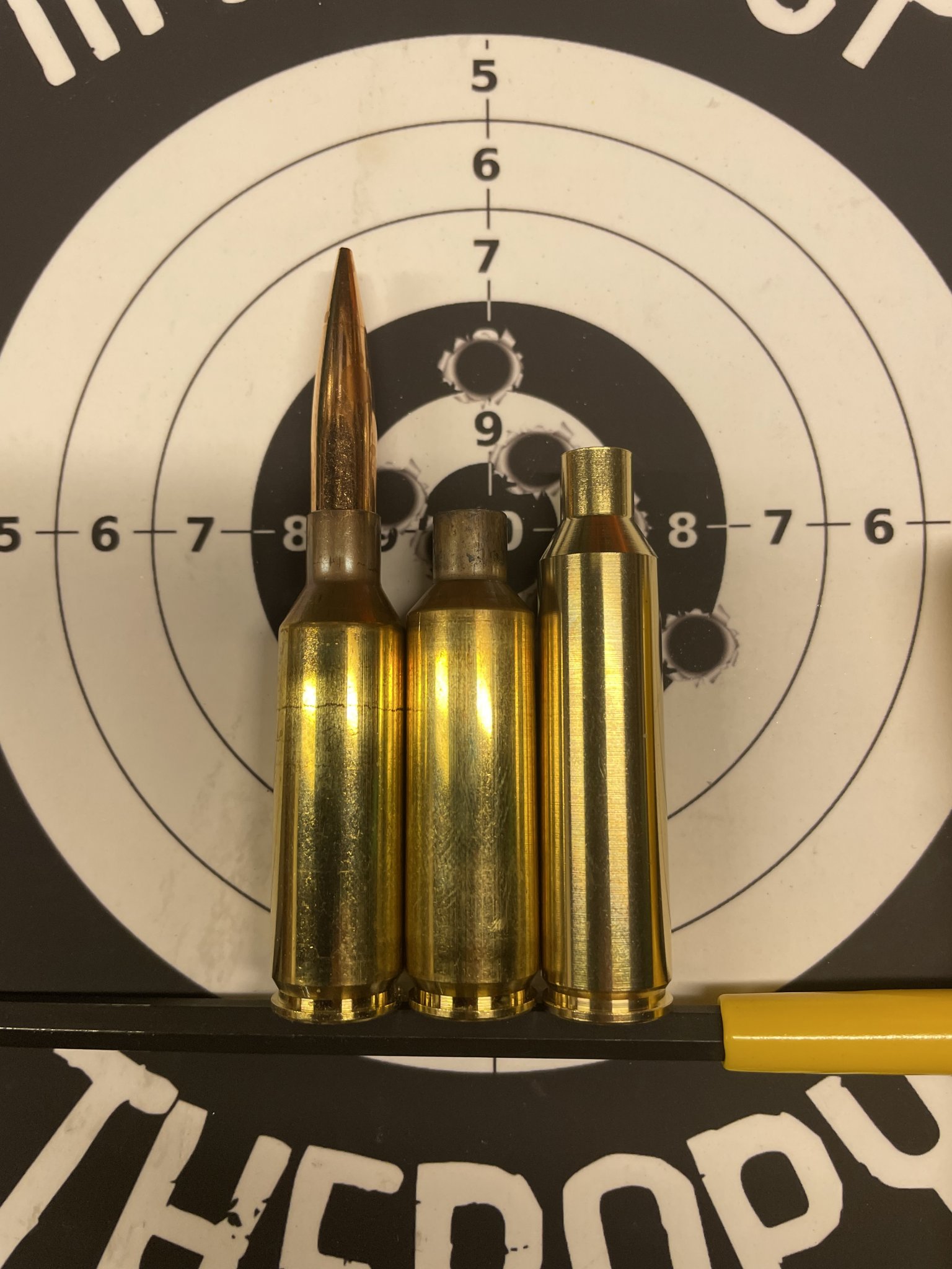

Yes, i posted the RCC 7 PRC brass next to my 7 MAX brass the other day. Just made a dummy round for the fanboys..... Still debating if I'm going to spin up a barrel in 7 PRC. One of my smiths has a reamer on order. Waiting to hear back from Whidden on dies. I have a modBB 7MM 1-7.5 twist on order.
I seen that pic I guess I just didn't think about it haha I'm just curious about brass
