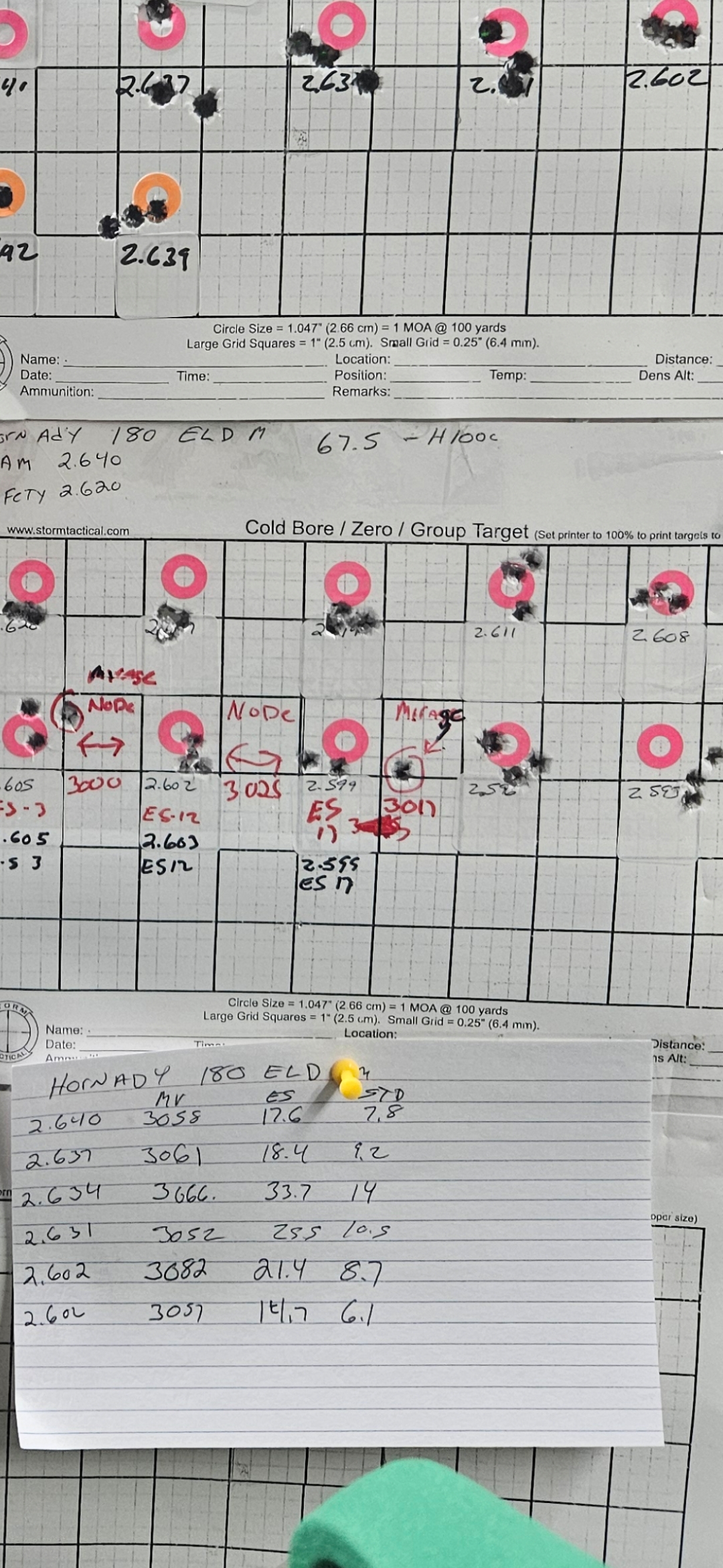

This is
180 eldm
rl26. 66.5gr
Norma brass 2x
215m primer
Gives 3015 and SD 7
Was actually fussy about seating depth. Shot well at. 005 and .050 and nowhere else.
Bergers 184 worked across a broad range of powder charges. This was 66.5 and 66.8

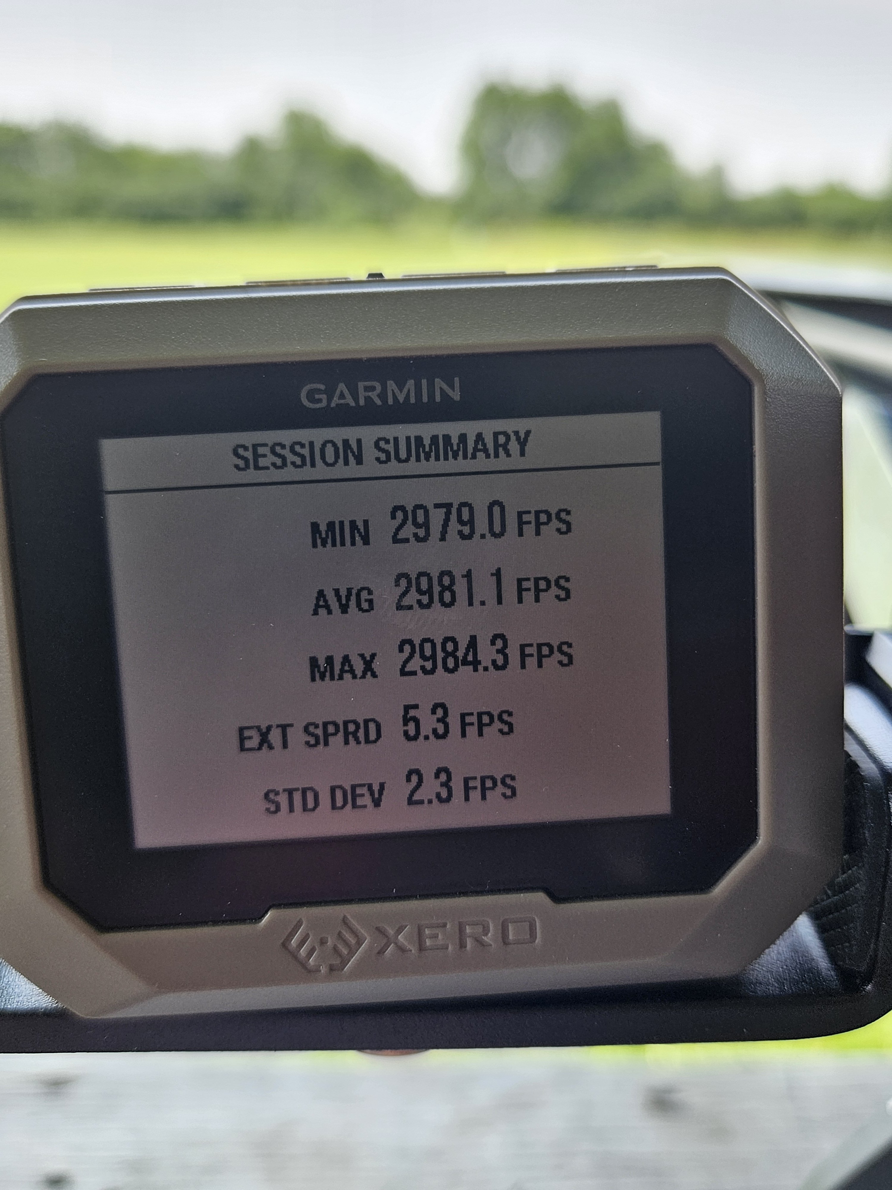

What bullet weight? I’m using Retumbo for Berger 190s and it is getting near 3000 fps in a 30” barrel. SDs are a bit higher than I prefer, but results on target have been very acceptable.
