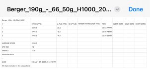

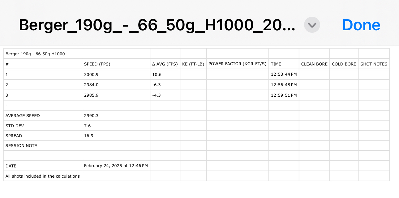

Range report:
Berger 190g LRHT
66g H1000 (x3 shot group)
66.50g H1000 (x5 shot group)
Believe I found a solid node here, but still need to confirm that it can repeat itself. Plan to load up 66g, 66.2g, & 66.4g and see if I can repeat similar groups. Muzzle velocity was hovering 2950 +/- 12fps with very acceptable ES. For this being a hunting rifle, I’m extremely pleased thus far.

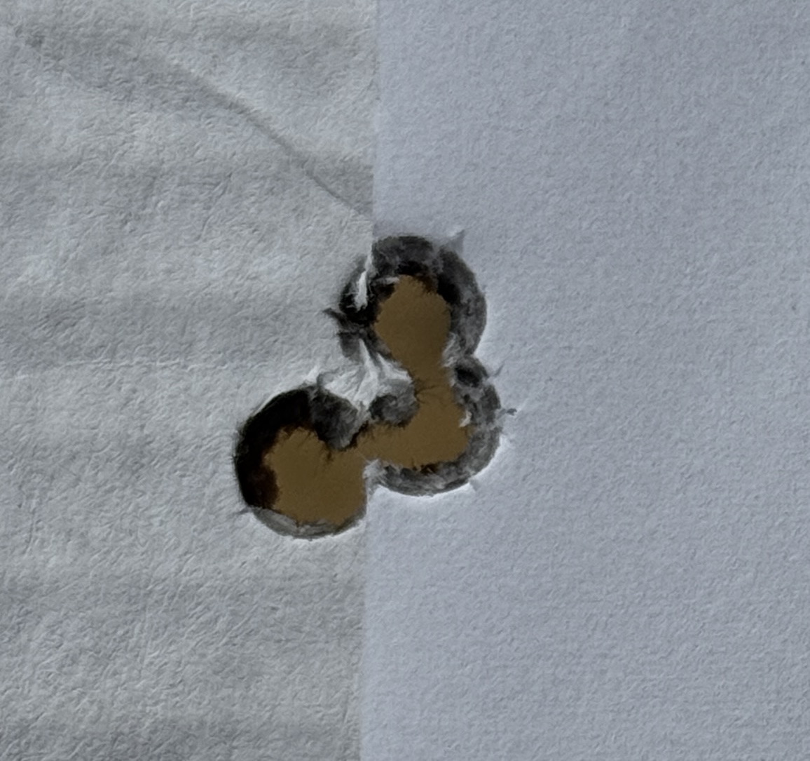

Thought I would share my load for my MPA Matrix Pro II 7PRC 26”
185 RDF loaded .03 off lands.
Hornady Brass
Remington 9 1/2M
VV N570- 68.7gn
MV 2940fps
ES 19
SD 7
The group was 5 shot and measured at .172” after removing the .284” projectile diameter.
I have since shot 700 of this combo out to 1250 yards and it has been the most consistent load in any rifle I've ever shot. Daily still get 1/3 inch 5 shot groups when I recheck for various temps. N570 has proven to not really give me issues with temps… 110 degrees down to 17 degrees in the past year of shooting. Something I was not expecting…

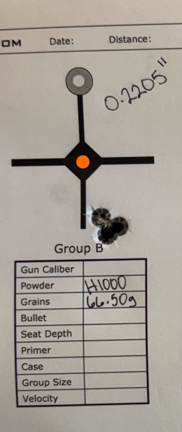

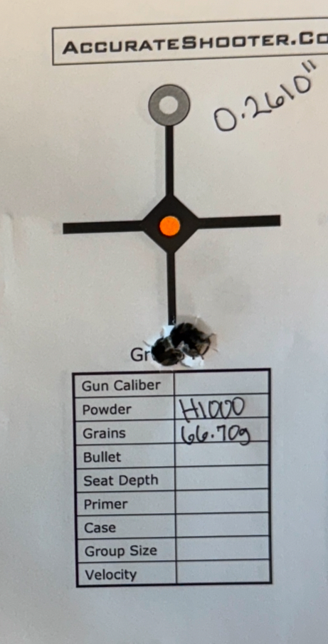

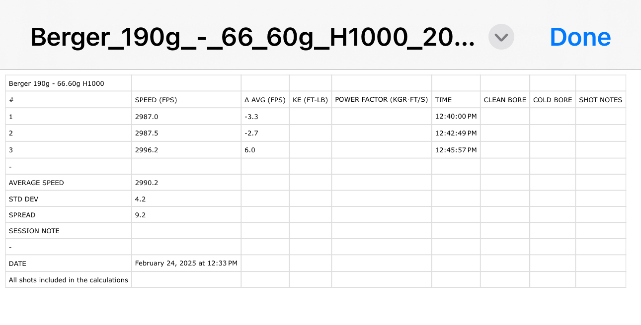

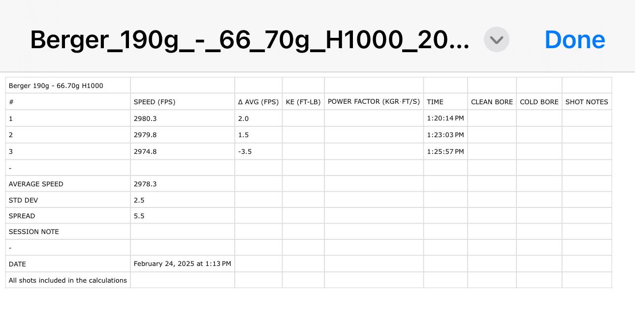

Range report:
Loaded up the previous charges and they blew apart along with a retest of 65.50g which did repeat followed by 66.60, & 66.70g of H1000. Seemed to have found a wide velocity node here, and I plan to load up 9 rounds of 66.60g and test the middle node to see if potentially have something, followed by seating depth testing. Here were my results with an average velocity of all three charges being at 2985fps:
Berger 190g LRHT
Federal 215M match primer
Gunwerks (ADG) Brass
H1000 powder

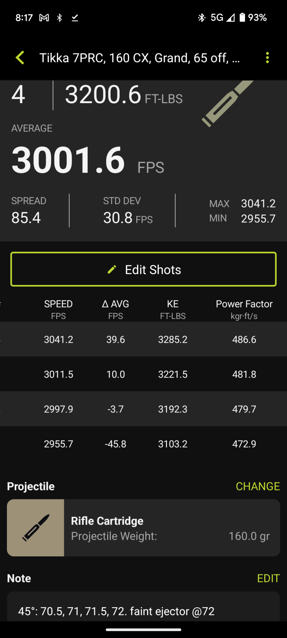

Anybody have experience with 160CX and H1000?
Initial tests with 67 and 68 gr were not very encouraging. Hornady book max was 69.5 for this combination, but seems low compared to other projectile results reported here…
I've been playing with the 160gr CX a little bit, mostly with Grand, which is right next to H1000 on the burn rate chart. I think that's probably a good burn rate for this bullet but I also would expect to see velocities a little lower than similar weight lead bullets, or at least that's always been my experience shooting copper bullets. How far are you loading off the lands? I still have more work to do on my 160gr CX loads, but so far 65 thou and 85 thou off seem to shoot better than closer to the lands.
Here's a spread I shot with Grand before I started load work, obviously similar burn rate doesn't mean same charge weights, in general Grand charge weights are higher, but I'd expect H1000 to pressure out a little bit slower. This is a 19" barrel, so if your barrel is longer you might see higher velocities with H1000. I'd have to check my notes at home, but I think 71gr 65 or 85 thou off was the best group so far. Accuracy hasn't been as good as 175gr ELDx, 175gr ABLR or 180gr ELD yet, but not wildly bad or anything. I think I need to fiddle with seating depths some more and maybe try H1000 with these bullets.
Reactions: lash

Very initial results. Not yet testing seating depth. Seated to Hornady published COAL of 3.290, which is about 0.075” off the lands. Rather than wasting bullets and powder, I thought I’d get some leads here.
67 gr: n=5, avg=2901, SD=4.7, 2” group.
68 gr: n=4, avg=2968, SD=28, 2.5” group.
For comparison, immediately after the above, with the same rifle, the Barnes 160 LRX Factory shot:
N=6, avg=2998,SD=15.8. Group=0.65” OAL=3.320.

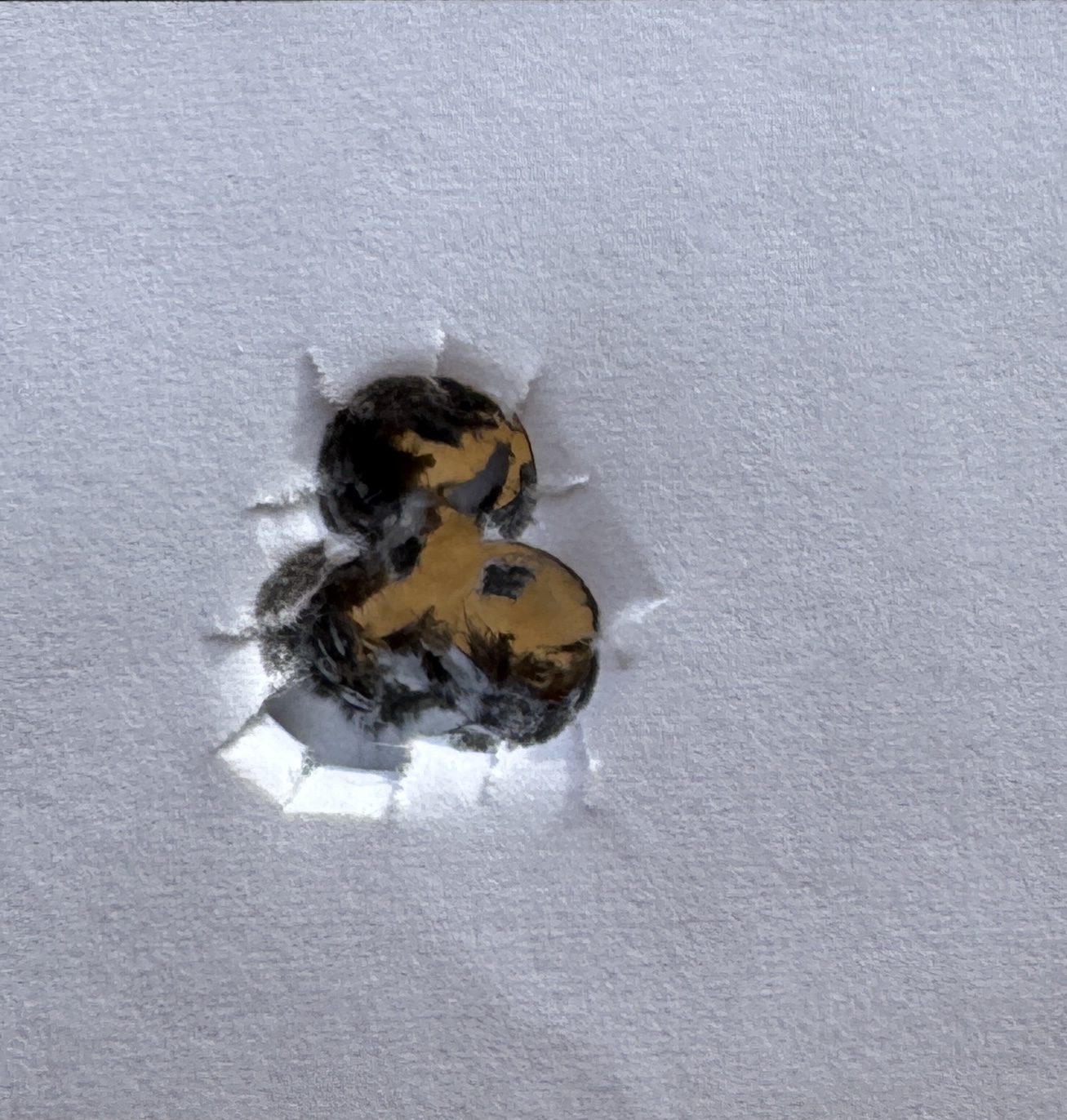

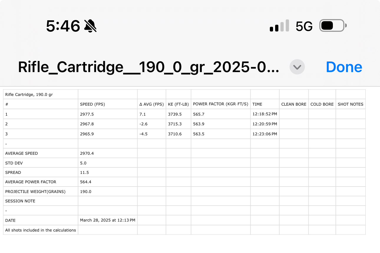

Finally had time over the last 2 weeks to finish load development on my custom 7 PRC. Here is my load I worked up in my rifle:
Peterson Brass (2.2630”) trimmed (wet tumbled, & annealed)
(3) thousandth neck tension
Federal 215m Match Primer
(66.20g) H1000
Berger 190g LRHT
AVG group size: (.25”)
AVG muzzle velocity: 2970fps
(Chronograph data was taken today for the 4th confirmation group)
(66.20g) H1000
Berger 190g LRHT
Impressive!
