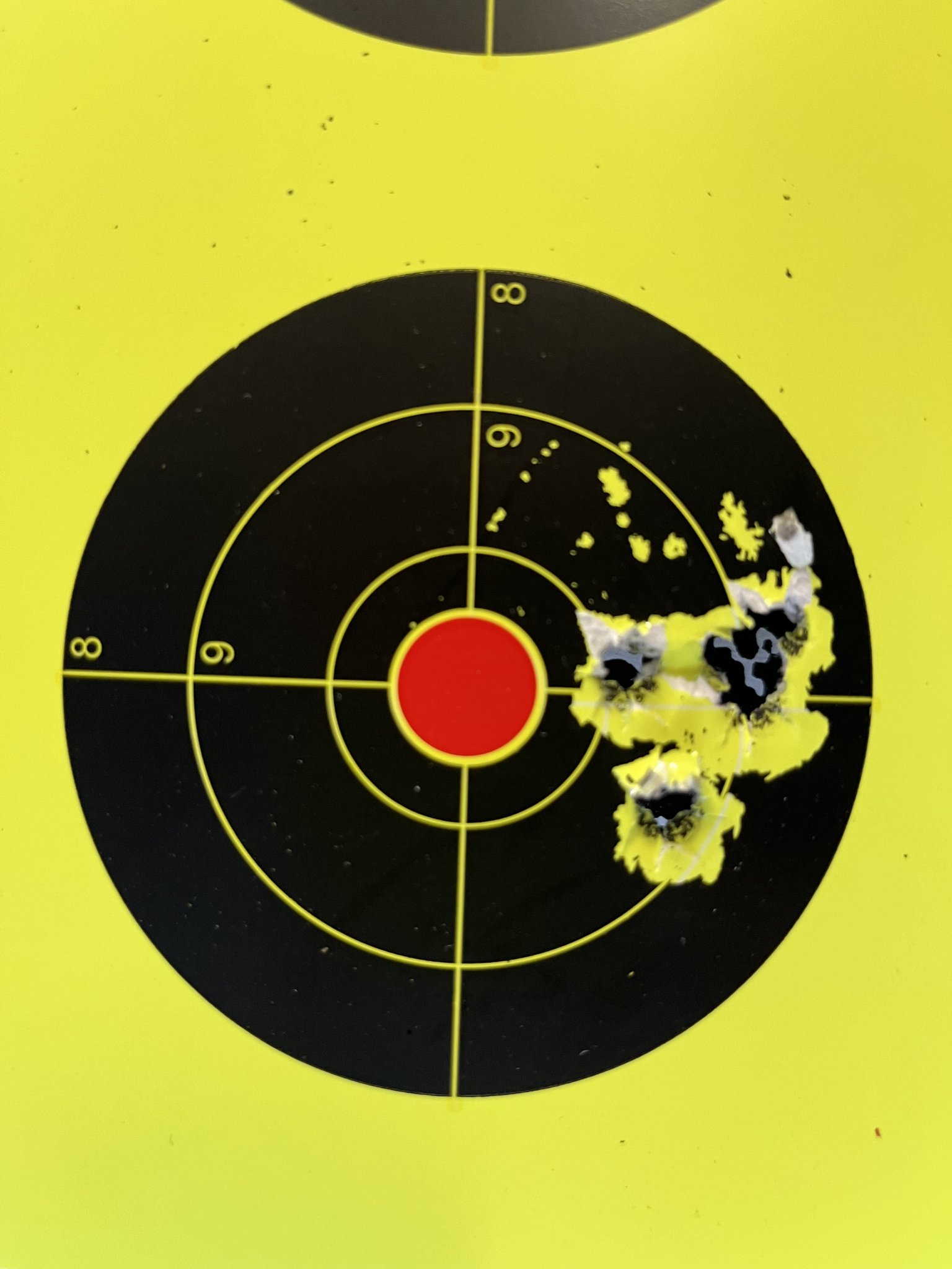

1.10 MOA @130 yards (6 shots, finding paper on first 3)

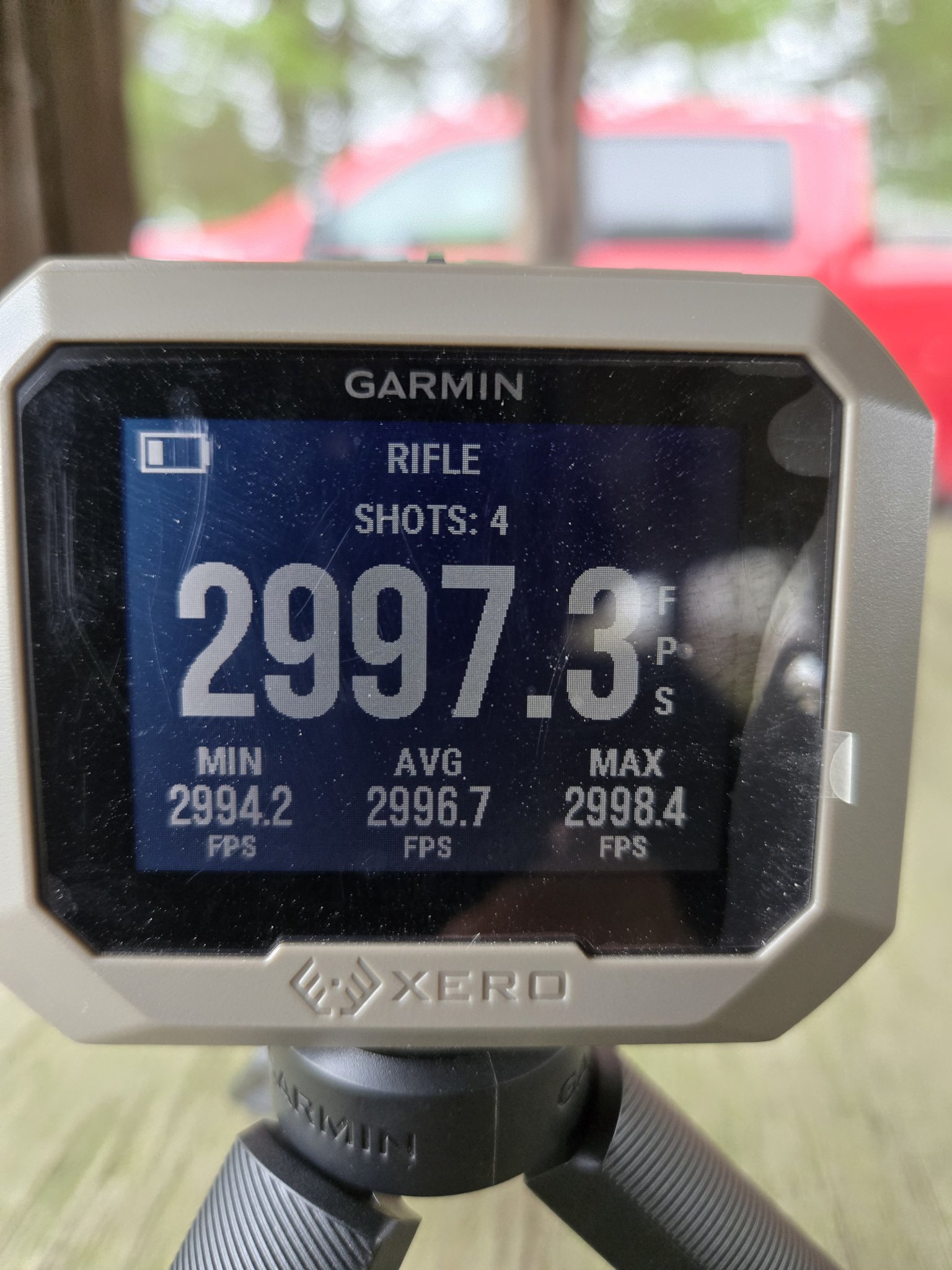

2933 FPS
SD- 16.1
ES - 45
How were the groups with the 165tgk? Mine didn’t seem to care for them

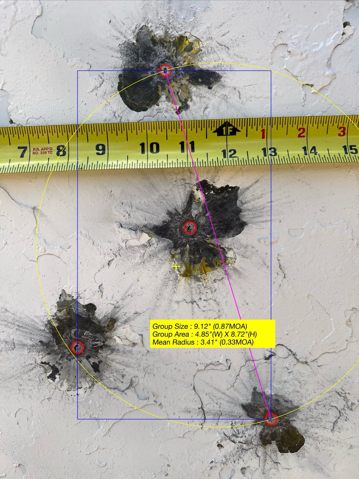

73gr n570, Peterson brass, cci250, 2.5935 cbto. Seems to be hanging around 2850fps out of my 18”.
Obviously work up to the 73gr. I started around 69gr and found great accuracy all the way up to 73.5.

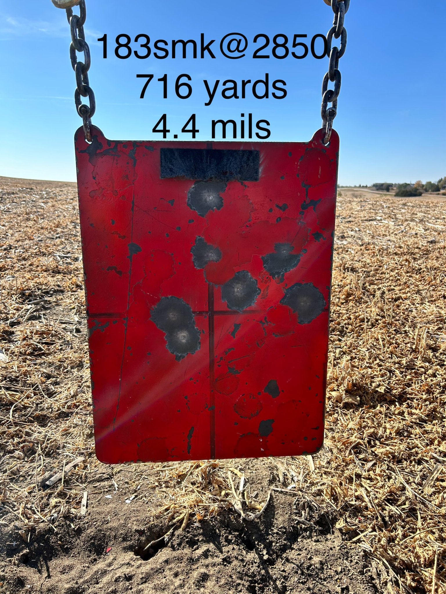

900 (3 shot) and 1000 (4 shot) yard groups attached.

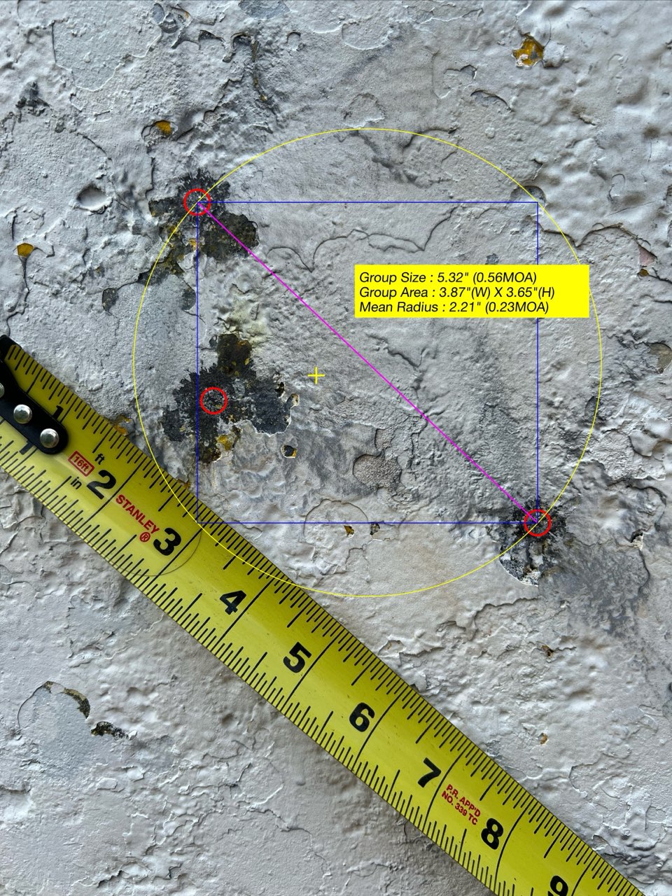

I realize they aren’t specifically a hunting bullet, but the Barnes 177gr shot really well in mine. 10 at 200:
And yes, I realize that my windage was off, but I was verifying a load and didn’t want to change during the string.

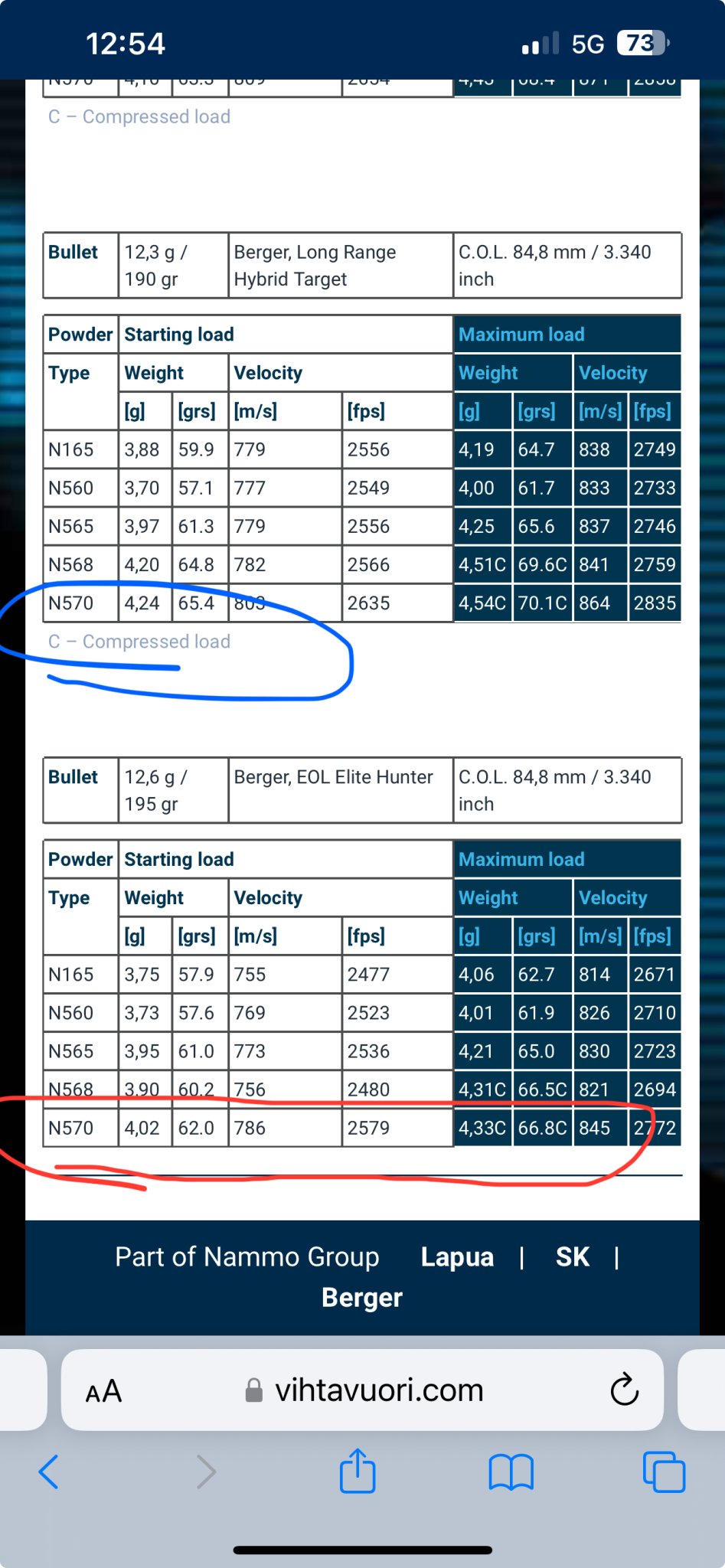

I'm curious about N570. I know guys are having great luck with that. How is the Temp stability? I'm seeing N560 loose 1fps per degree drop from 85-40 degrees. Which is disappointing.
Second question is about primers. I just can't seem to get my velocity spreads acceptable even being very particular and double weighing every powder charge. I'm beginning to suspect the CCI O.E.M 250 Magnum rifle primers I got in a plain white box labeled "not for resale" are not very good. Maybe they're belt feed machine gun primers or something? who knows. I think I'm going to try a batch of my precious remaining federal gmm210's from my reserve stash (from 2018 $39.99/1000 🥹) to see if that makes a big difference. Of course I just had to use what I could find.

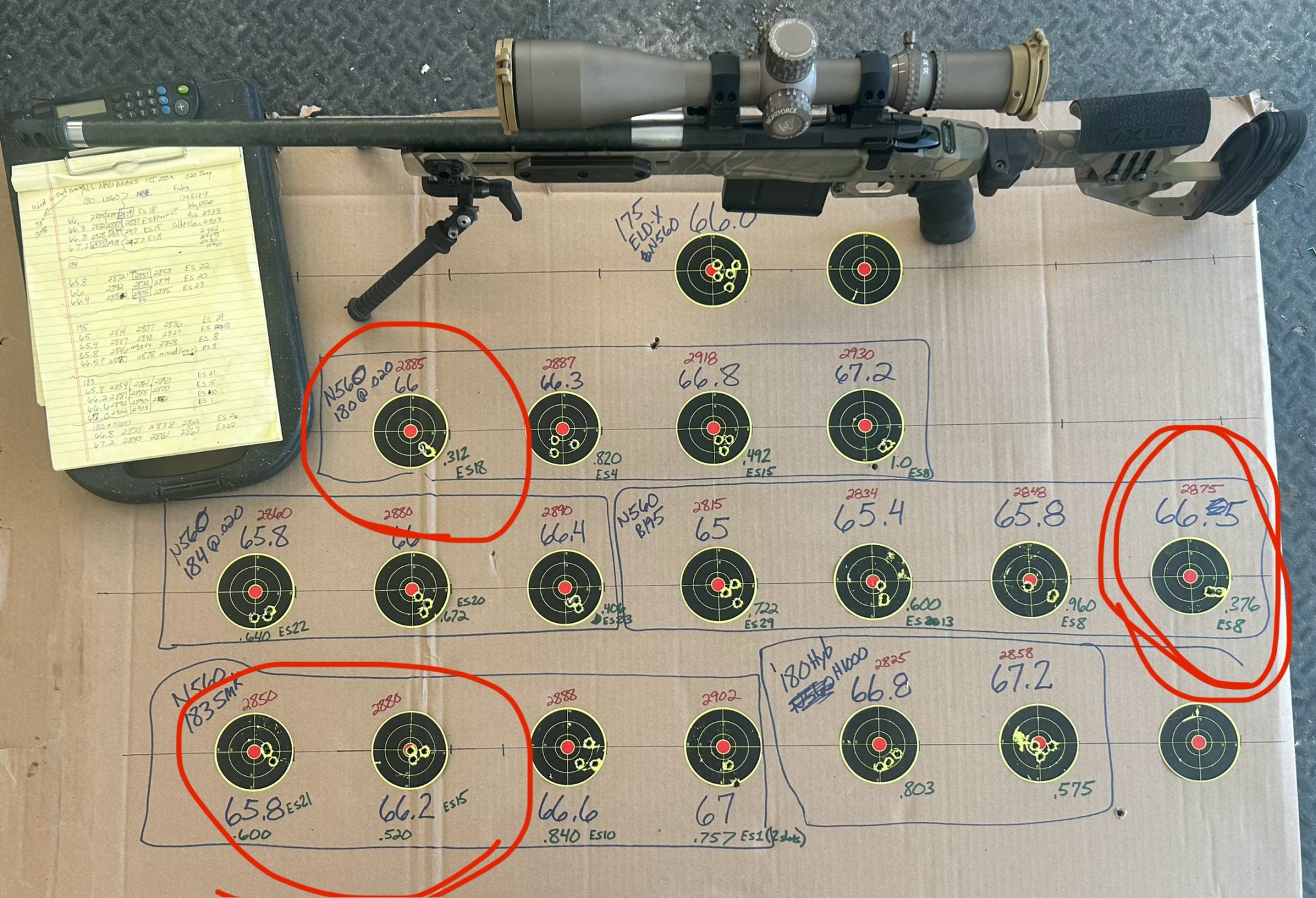

For your Information:
Well after getting pretty far into development I've learned....
N560 is a little temp sensitive.
@84F 66.5g put my 195 berger @2880 from a 22" carbon Bartlein through a TBAC Ultra7.
@43F same load is getting 2830. :confused: This was a long range sessions I'm not sure how that velocity change effected accuracy but I'm left wondering what the steel groups would look like if I had kept in that 2880 range. Bummer. BTW that steel above was in shifty 5-20mph wind so I was pretty much looking for verticle dispersion.

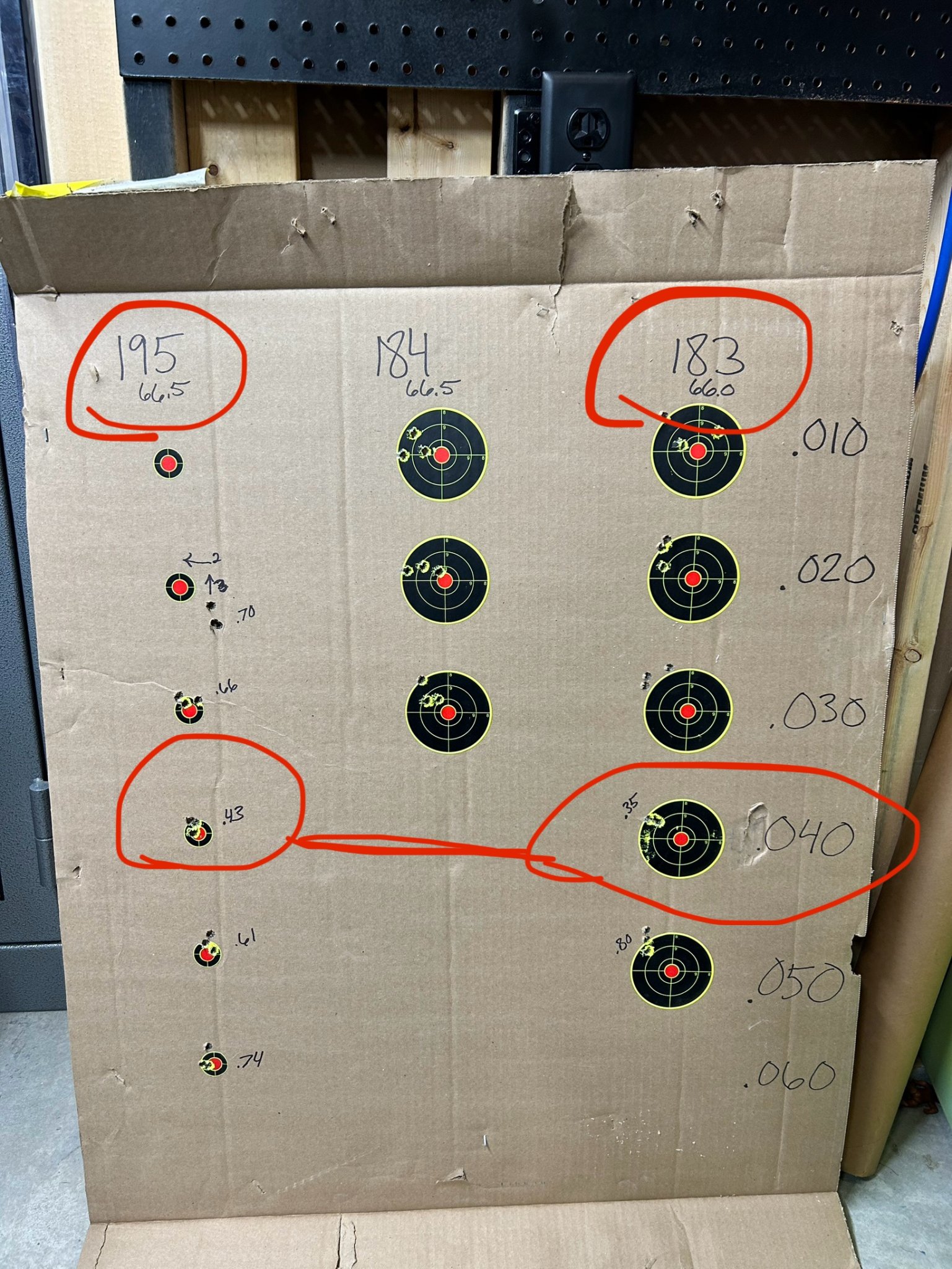

Seating depth on my rifle for these (berger 195 EOL hybrid hunter) was forgiving. .030-.060 jump was good.
With the Sierra 183smk it wanted to be right at .040. it really did not like less. .010-.030 opened up to over an inch groups.

Unfortunately I think N560 is less temp stable than I'd like.

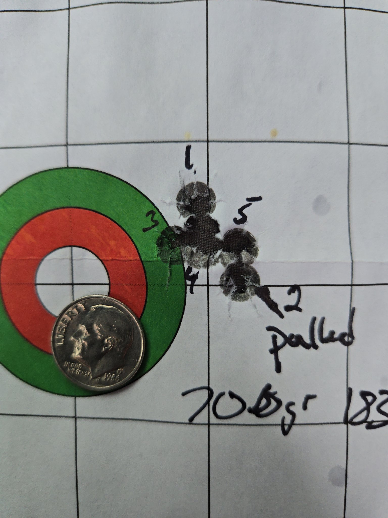

Range report: factory savage with 20” Proof

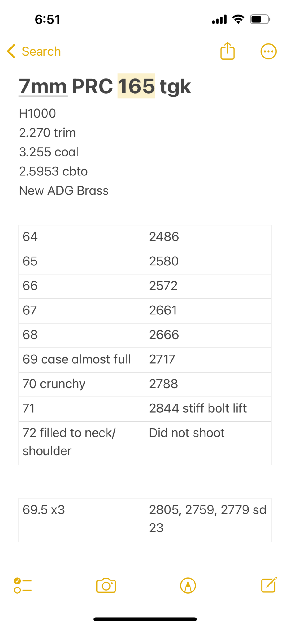

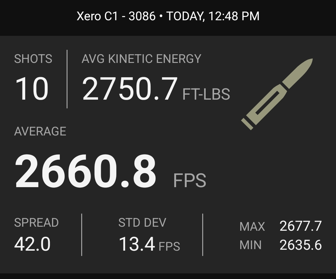

67 grains H1000 with 180 ELD-M gets 2650 fps. Not a hint of pressure
Was a little surprised. Maybe H1000 is a tad too slow. Can probably work up to 69. N
Accuracy was good. Recoil not as bad as anticipated with an 8# rifle and TBAC 7 ultra can

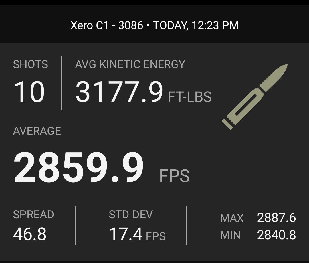

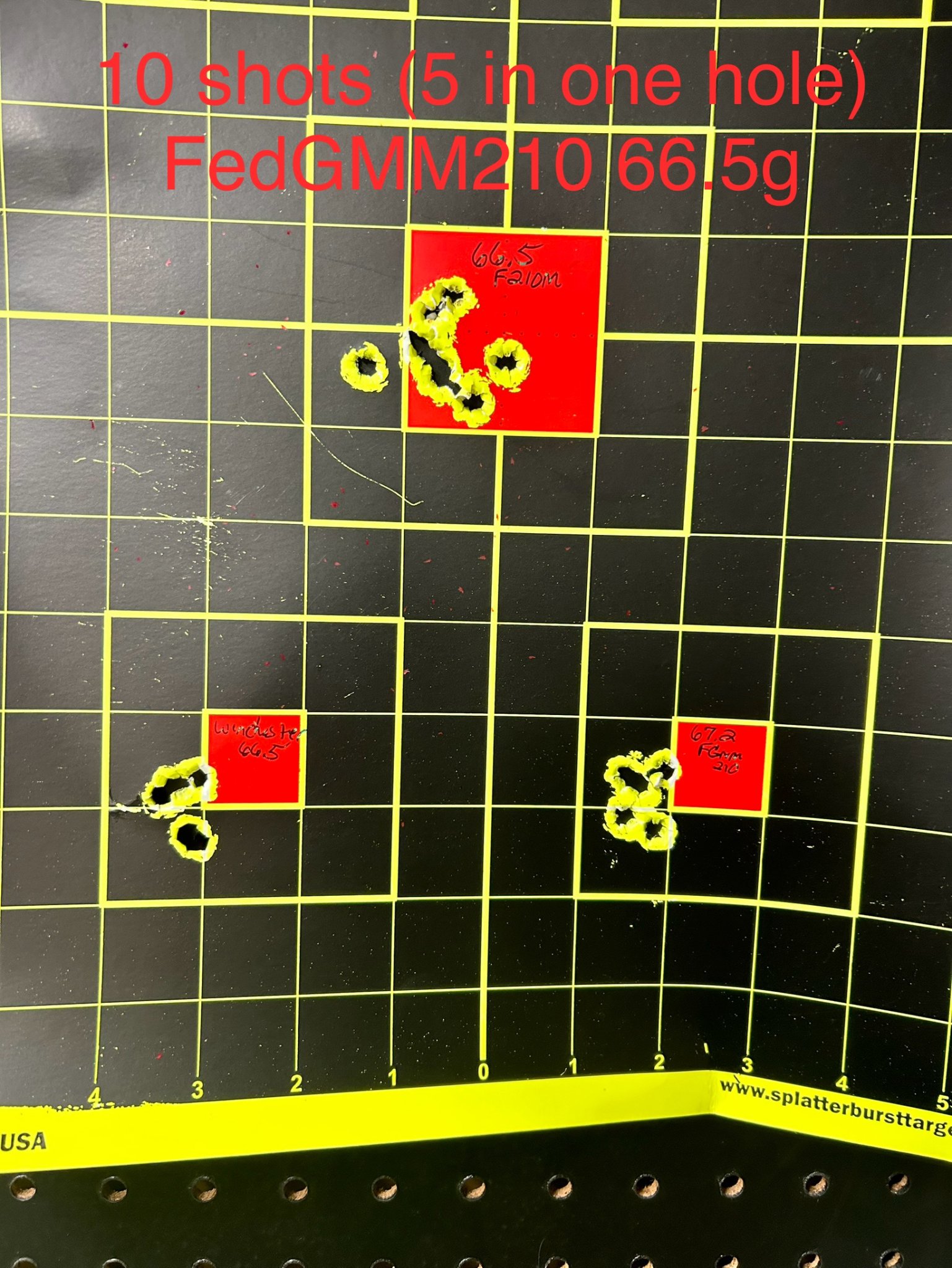

I tested 3 different primers. Winchester LRM, cci250, and federal GMM210. Results were very similar. I also did 5 rounds at a higher powder charge to try to move back up into my velocity node (2870-2900). This did make a big difference. In the summer at 85F 66.5g of N560 put me around 2885 and decent sd’s. Now at 45F same load has dropped to 2830 average. So by upping my charge to 67.2g I got back to 2890 and that 5shot string was sd6 ES16 👍🏼. Accuracy at 100 was equal. I may try N570 after deer season. For now this will get it done. IMG_1733.jpegIMG_1734.jpeg
Reactions: Ronws
I tested 3 different primers. Winchester LRM, cci250, and federal GMM210. Results were very similar. I also did 5 rounds at a higher powder charge to try to move back up into my velocity node (2870-2900). This did make a big difference. In the summer at 85F 66.5g of N560 put me around 2885 and decent sd’s. Now at 45F same load has dropped to 2830 average. So by upping my charge to 67.2g I got back to 2890 and that 5shot string was sd6 ES16 👍🏼. Accuracy at 100 was equal. I may try N570 after deer season. For now this will get it done. View attachment 8545752View attachment 8545753

That’s a possibility. I like that the N570 is bigger and will be closer to filling the case. I think generally a fuller case yields more consistent ignition and lower velocity spreads. According to vitiviouri, N570 will be a compressed load at 66.8g
But yes seeing how I’m 3 grains over their max N560 load, N565 may be the ticket. I don’t have either but I know N570 is available locally.

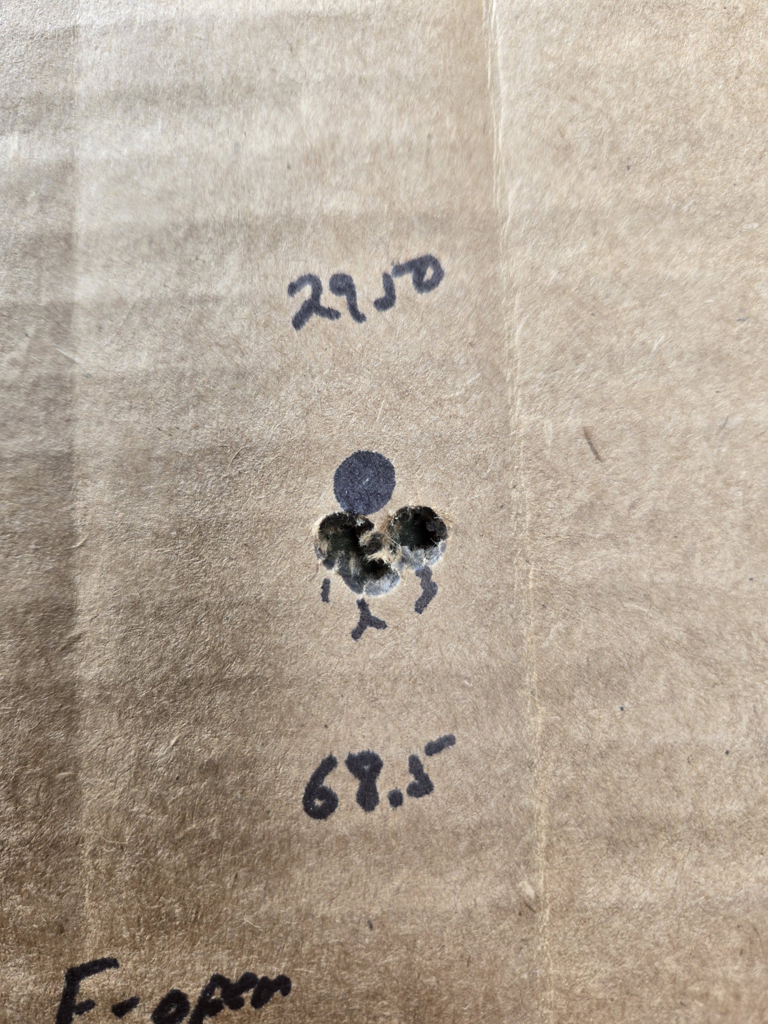

Loaded up some N565 to find pressure. Had a heavy bolt at 69.5g. Brass looked fine. Probably
Shoot a couple groups next to see if accuracy or velocity spread is any better than n560.

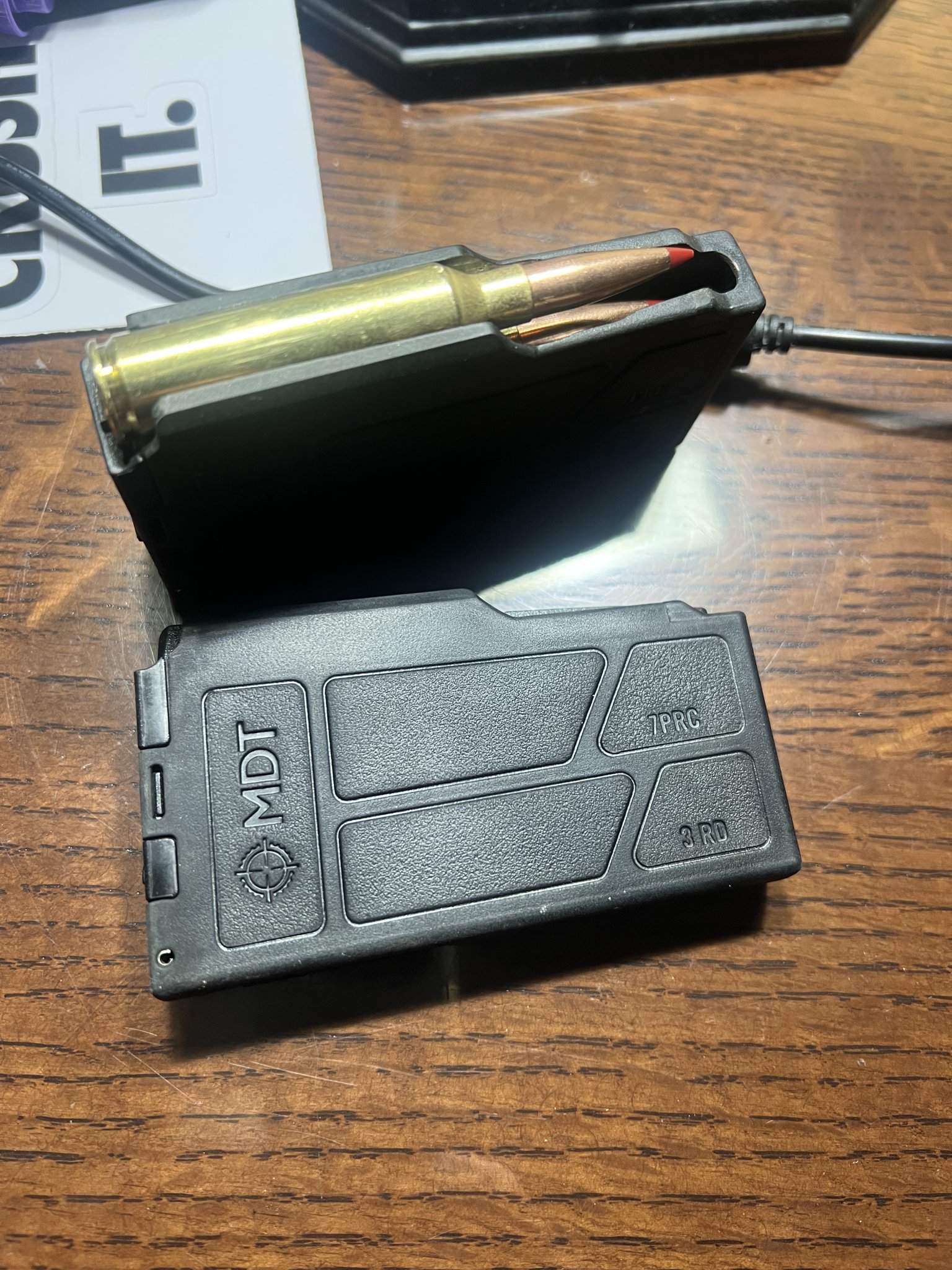

By the way guys, these are the magazines that you want for your 7 mm PRC if your chassis accepts them. The XLR chassis and the MDT chassis both take these MDT magazines, which are specifically marked 7PRC. They feed flawlessly and smoothly, they weigh next to nothing, and they’re only $49 each. They also do not rattle in the chassis.
On the other hand, the metal ones on the XLR website are heavy as shit, cost $80 each, are not designed specifically for 7PRC and are frankly way too long, and they rattle in the chassis. And of course you have to trudge through their giant chart to figure out which one you actually need and there are two different ones lol
Do yourself a favor and just get the MDT magazines that are marked 7PRC
They are just catching up. I use an Oryx chassis for 7 PRC and at the time, they did not have this type of mag that I could see. So, I had to get the 5 rd metal mag for .300 WM and the 7 PRC is a smidge shorter than that.
I agree with this IF that person doesn't have mags for their PRC yet. I bought 2 of those MDT mags to compliment my existing Accurate RUM/PRC 3.850 mags and had to remove material off the MDT's so they can latch properly.
-When the Accurate latches, the MDT's wouldn't latch.
-Adjusted the mag latch down on the XLR chassis so all mags latch but started having feeding issues with the Accurates.
-Went back to original latch position and removed material off the top of the MDT's. No problems.
Is that for a short action chassis?
Long action
I suppose you could do the 30 Ott six size action and I debated that, but this defiance machine anti-X action was $2000 and I wanted to have lots of versatility for other cartridges in the event I build it out to something else in the future
Plus, those medium actions Keep changing up and I just was not comfortable, jumping on the latest bandwagon
Reactions: hseII and lash
By the way, those rounds are loaded to 3.320 inches.
My gunsmith used a Manson reamer, the standard one they have off the shelf with a slightly different base diameter, and he did not add any additional free bore. My COAL for a 180ELD – M touching the lands is 3.330“.
Just an FYI, for anybody considering getting one of these spun up. That COAL puts the top of the boat tail right at the bottom of the neck for that bullet. I wouldn’t see a point of extending the free bore unless you were shooting a solid or a 190 class bullet that is longer.
