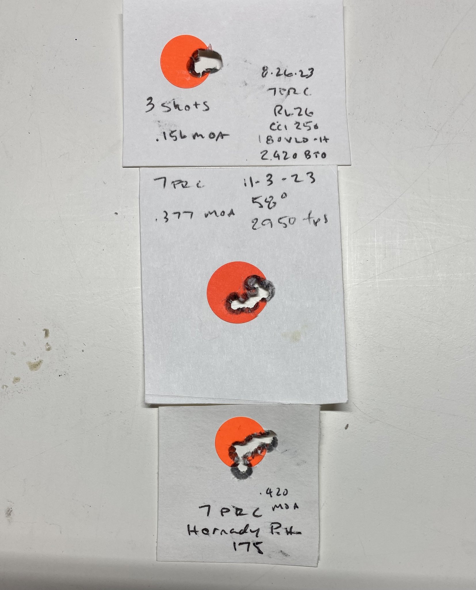

4 shots, 4 kills for me on the 7 PRC with the Hornady Outfitter load this last season. All of them were deer, no elk. Pretty happy. 3 of the 4 went down where they stood. #4 was dead on his feet, he just didn’t realize it for a little ways. If you’re looking for factory, definitely try it out. It was crazy accurate in my rifle. A lot of penetration too. Shot a muley doe facing me at 360 yards. She toppled over and rolled with her legs in the air. That was it. Around 30” of penetration, ending up in the spine.

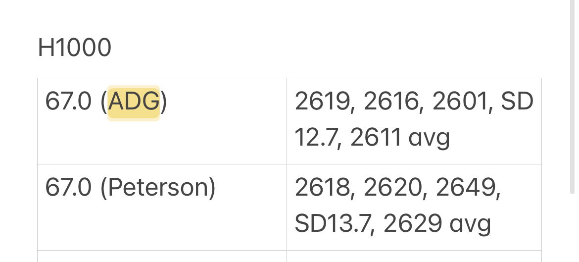

I’ve only used Peterson for my 6BR and it’s been Flawless. I’ve only used ADG for my 7PRC and it has been great too. The ADG 7 PRC was read to load out of the box except for ID/OD chamfer. Very consistent case length and weight on the few random I measured. Box to box.
The ADG primer pockets are tight, which led me at first to think they were too shallow. Pin gage and mic measurements showed them to be in spec and I just needed to adjust my primer seater.
For those who have used both, which is better? Peterson, or ADG?
Currently have both in 7 prc. Both are great. I can’t say either is definitively better than the other.

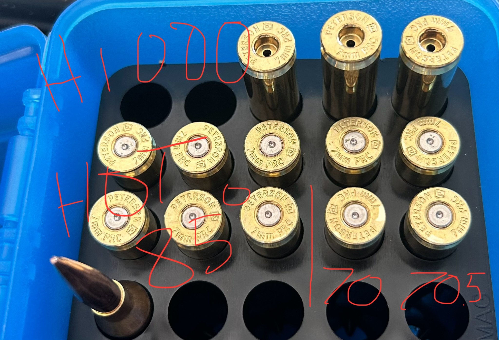

Edit pic below is for the same load, in my 18” 7prc shooting a 180 hybrid. I’ve since redeveloped the load using only Peterson brass and N570 and have gained 220-230fps.
Did you not try to push it up to 69 grains with H1000?
That’s what I plan to shoot. I will not use N570 because it eats barrels like a hungry little bitch.
I did not. Had a ton of N570 leftover from a rifle I sold so gave it a shot. It shot everything accurately I just wanted to use the n570 and gain some velocity. It’s an 18” hunting rifle so I wasn’t planning on getting 2000 rounds out of it
Edit to add- when I did the h1000 load development on the ADG it had great groups and very low SD. It met what I was seeking to achieve with the build so I just stopped. When I got the Peterson brass I just wanted to compare apples to apples at the same charge and see how it would do.

I also like Peterson brass as noted above, but I can’t see a distinct difference between the two.
I have tried ADG and the brass was harder to work with when resizing. It seems much harder if that makes any sense. I really had to force everything on the press. Also, my dimensions on the Peterson brass seem to be truer. I am able to get almost perfect COAL when loading with it. Sorry I don't have a more scientific answer, but all I can say is use Peterson with confidence. I also shoot a lot of Lapua, but consider Peterson as good or better.

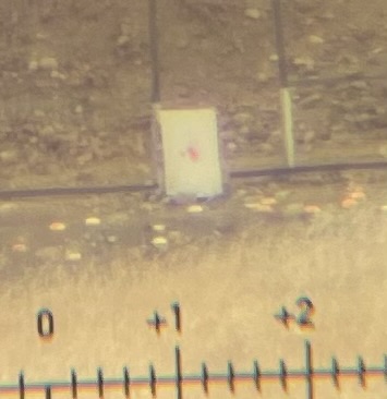

There is a new friend at out local range that bought a Christensen Arms MPR in 7prc with a carbon barrel. Has anyone got one of these carbon barrels to shoot a 1/2 moa 5 shot group?? He can get 3 sometimes 4 shots in a 1/2 moa but never 5. He has tried 165gr to 190gr and still no use. I have advised him he probably need to re-barrel with a 26-28 Bartlein, Kreiger, Rock Creek or even Schneider steel barrel. What are the Hide's thoughts??
Yeah I have one and have had good luck with the 180g eldm 13ths off touch adg brass retumbo 69.0 g and br2s. 3114 fps. See short for last round of 5 shot groups. I tested a lower load at 30deg from January top left, 1st 3 rds clustered then the next two speed up alot (mid 90 temp) then shot the rest with that last 5rd string back to back, grouping around 0.5 inch

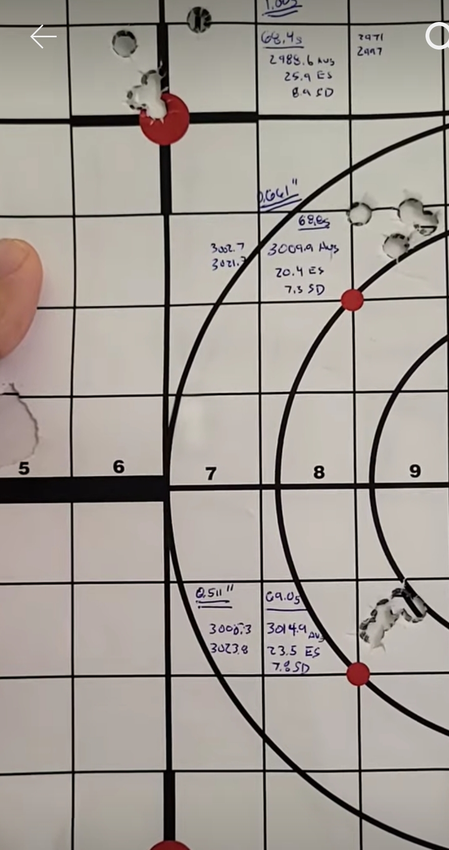

5 shots at each charge weight out of a 26" Bartlein. Peterson brass, Berger 180 hybrids, H1000, Federal 215 primers. Important info to keep in mind here - These are shots 10 - 49 out of a new barrel. Things have sped up about 65-70fps since then.
62gr - 2671
63gr - 2735
64gr - 2777
65gr - 2830
66gr - 2874
67gr - 2920
68gr - 2975
69gr - 3031
FWIW I thought I’d be good at 67.5 no pressure on single shot ladder test. When I went back with 5 rounds I had pressure on 4 of 5. Dropped .5 grains same thing pressure on 3 out of 5. Ended up having to drop 1.5 settling at 65 to get rid of pressure signs on shot strings of 3-5 rounds.

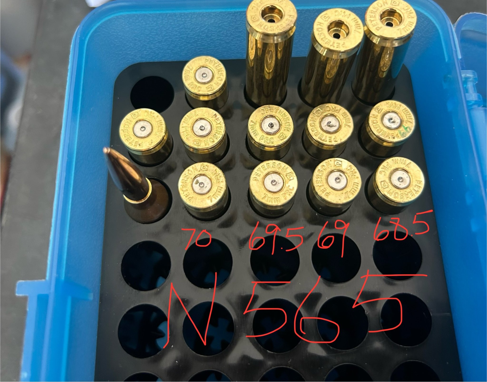

Loaded up some SMk 183g with my 22” bartlein carbon today. N565 and H1000. Pardon my daughter’s handwriting, she’s 8 😎. Thought I’d share the info. Haven’t shot groups yet. Pressure showed at around 3000fps on both powders which is better than I expected with a 22” tube. Also it was hot out 85-90 degrees at 1100 elev. But nothing too bad. Even over 3100 was just a slightly tight bolt lift. Ejector smear and craters were marginal. Hornady match ammo was shooting .4moa at 2850-2900 out of this rifle. I took one of those match180’s apart and it’s got 69.8 grains of something (n570?) not h1000.

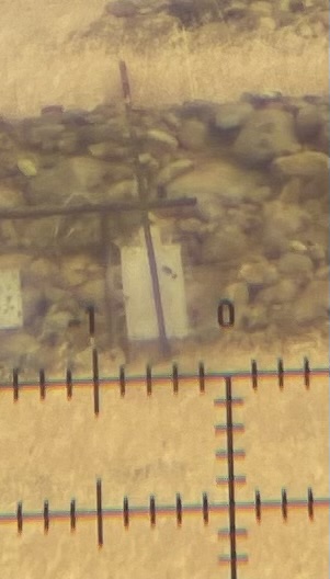

9/1/2024
22”proof Research
Round count: 360 (end of day)
Temp: 83f
Humidity: 72%
Pressure: 29.97
Altitude: 775 ft ASL
165TGK/H4831sc/ADG/F215
61- 2815
61.5- 2833
62- 2882
62.5- 2896
63- 2908
63.5- 2927
64- 2970
64.5- 2968
65- 3001
65.5- 3025 (Hornady book max on 162-166 @65.2gr, no published load data for 165TGK in 7mm PRC)
FACTORY 160CX
10 shot average
1.10 MOA @130 yards (6 shots, finding paper on first 3)
2933 FPS
SD- 16.1
