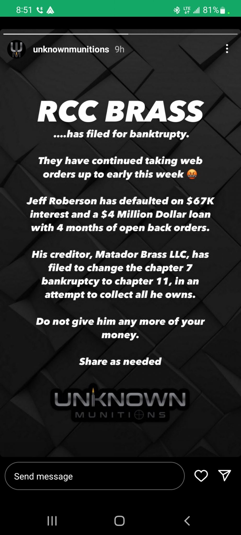

Unknown Munitions posted this earlier on their Instagram.
