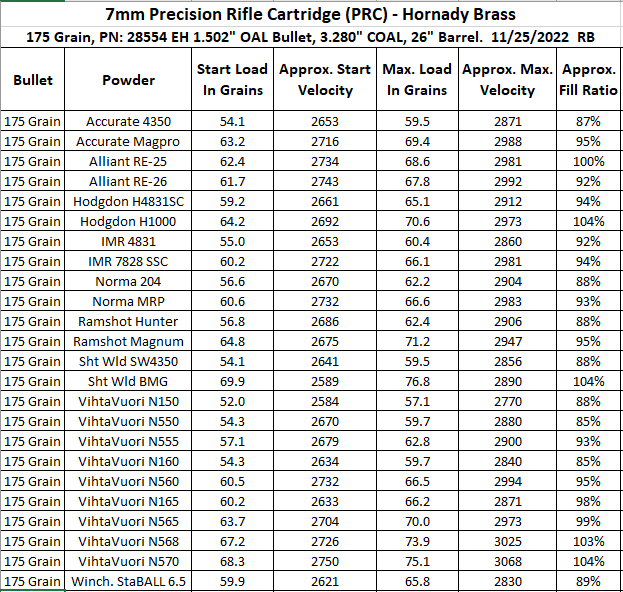

I did get to 3100 fps with a 24.5” 1-8 twist barrel, RCC brass using the 180gr ELDM, 67.5grs of R26/215M primers,
DEFINITE OVER PRESSURE SIGNS AT THAT LOAD.
I stopped at that load in my testing.
So maybe with a slightly longer barrel it’s possible with no pressure… I thought RCC was done for …
So ma
As always you’ll have to test and load develop in your own rifle to determine what’s safe, I’m just pointing out 3100fps with a 180gr bullet is definitely on the upper limits of this cartridge.

That's impressive. I wonder in hornady brass if you could get that speed? I know rcc brass is tough
Originally the first loads I tested I was only getting 3050fps at the 66.5gr load but last time out it’s settled at 3100fps, I’m at a little over 200 rounds on the barrel.
I have some factory 175gr ELDX ammo to try out as well.
Reactions: Schw15
Awesome I'm curious what the factory ammo will do. Gotta love the extra speed from barrel speed ups lol
