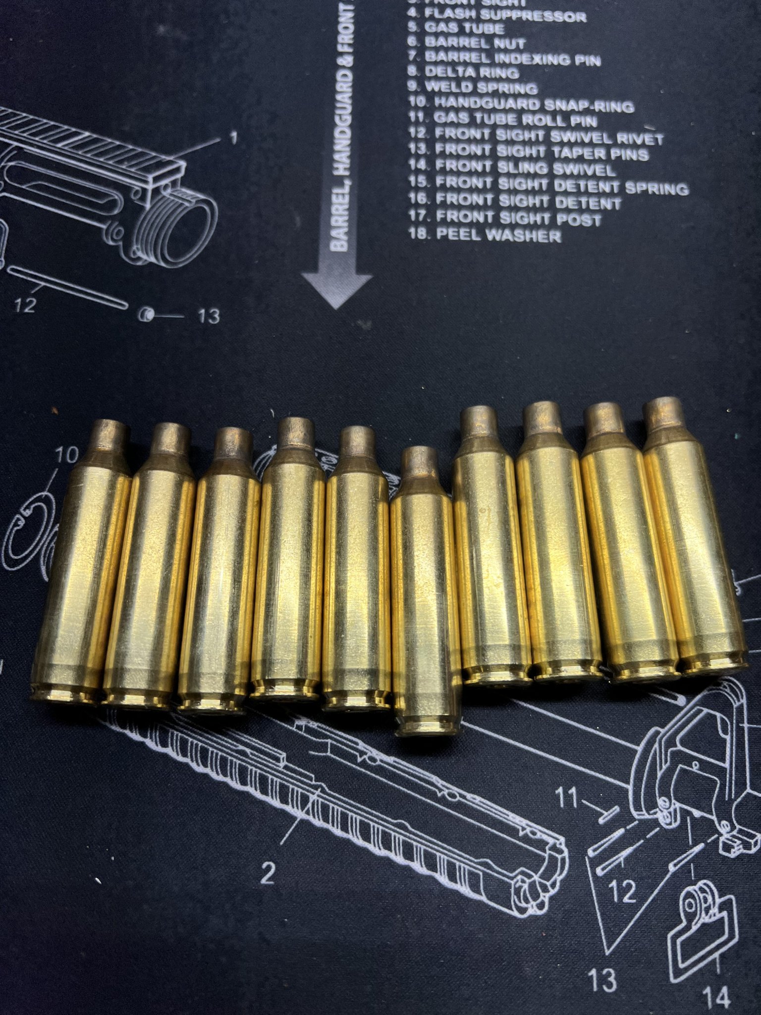

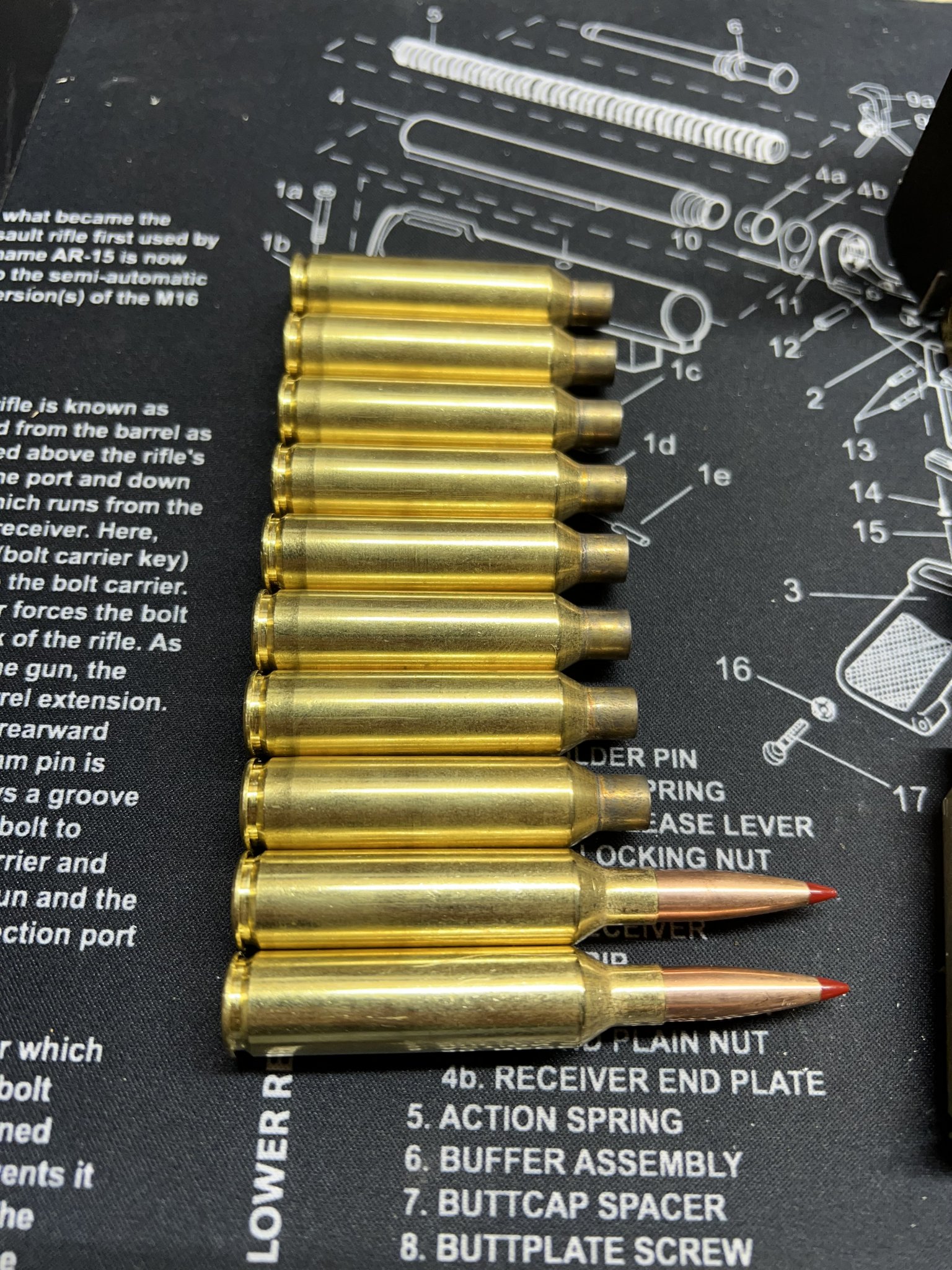

Posted on rokslide as well, but anybody else seeing pressure issues on the factory eldx? On my once fired brass I’m seeing a ring that looks like the beginning of case head separation. I can’t feel anything inside the case that would indicate an issue. Is this the ring you mentioned @Schw15 ? Also seeing ejector marks on several pieces. None of these pieces have been run through a sizing die, only a decapping die. Is this a chamber issue or overpressured factory ammo?

Yeah if these had been resized then I wouldn’t be questioning it. These haven’t been run through the die yet though. This is how they came out of the rifle
That is very strange do you have a virgin brass to measure and then measure that to see how much it swelled up?
.534 at the ring, .530 just below it, right before the case head. Same locations on unfired brass is .527 and .529 respectively
ETA: measurement at the shoulder/body junction is .518 on fired and .514 on unfired
Reactions: ma smith
That ring should be close to the .200 line and my fired brass measured .5305 usually and sized .5295. .534 is pretty big did you get a aw reamer? What is the barrel
Unless I am misinterpreting the chamber specs, it should be .532 +/- .008. That would put it right at .534 which checks out with what I’m seeing. Maybe it’s not oversized, just maximum sized?
Read that thread
Reactions: TxLite
Read that thread
Helluva thread but it sounds very similar to what I’m seeing. Out of curiosity I ran 2 pieces through the FL Hornady sizer and bumped the shoulders back .002. The ring on both is measuring .531 and the shoulder/body junction is showing .516
Reactions: Schw15
Could it possibly be where solid case head transitions to the case walls? You get some flex there at the "web" upon firing. I doubt it's over expanding in saami chamber. Virgin brass should measure 529, fired 530-531 max, sized should get you to 530 or less for chamber clearance. This is typical of soft Hdy brass. Been experienced in 65 and 300prc.
Reactions: tho98027
that’s where it appears to be. I’m getting .534 and the Hornady sizer brings it to .531. Unfired brass is measuring .529.
What is your fired brass vs sized brass. Clickers are a huge plague for any caliber now with thicker brass. But basically the die doesn't size the fired case enough and then when opening bolt at the top your primary exacting kicks In and pops open with a click. My prc was .5305 fired and .529 sized
