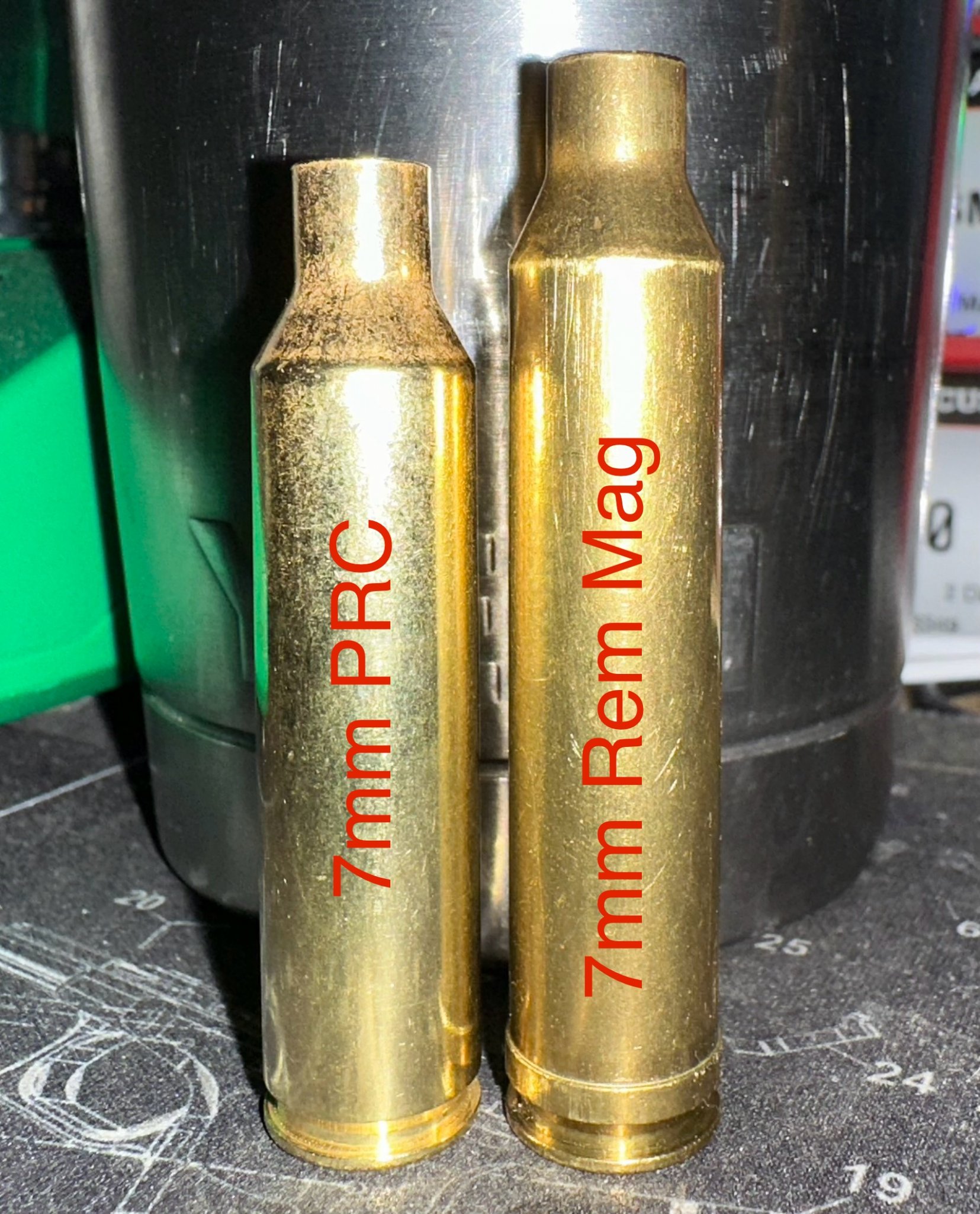

Took this the other day just to compare, as I'm a life-long 7mm RemMag hunter, and the 7mm PRC should be the perfect precision hunting cartridge for long action 700 style rifles, because you should be able to seat the 175-195gr bullets just off the lands and still fit and feed perfectly in the magazine. Ran ballistics on them both, and performance seems damn-near identical, but you get a shorter fatter case in the PRC, but retains nearly the exact same H2O capacity. I like the concept.
That and the 7 PRC is not belted.
I think most guys who already have a 7 RM don't have to get a 7 PRC. But they probably will because it is cool.

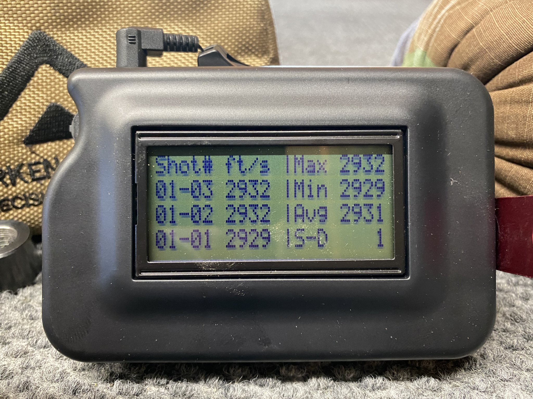

You don't have 3es 1sd ammo. 3es ammo has an SD of <1 and 1sd ammo has an ES of at a minimum 6fps. And ammo with a 3es would basically be the best ammo ever produced on the planet.
Kinda ironic to start a post off about misinformation with claims like this.

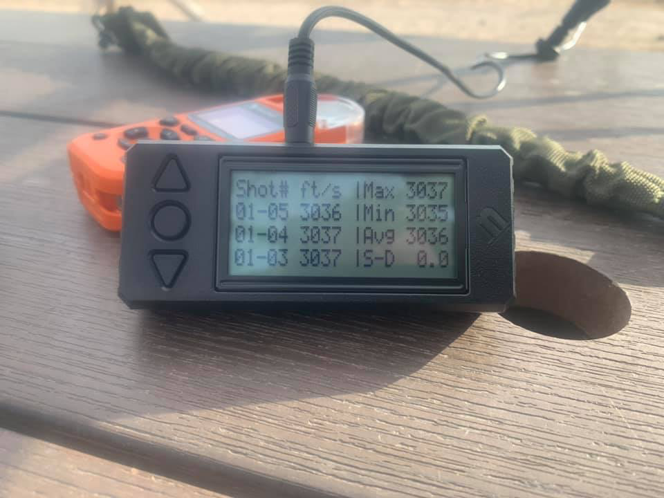

I'm getting single digit SD with two types of surplus powder in 7mm Mag (two diff guns, 5 shot groups). I most certainly can be done with good powder and loading techniques. I had recorded a SD of 2 using RL-22 and the 162 ELD-X. One is just barely acceptable! You need to do better!
Berger Target Hybrid180gr0.683.450"WC86079.02720/2711/2716 SD=4Rem 700 24"
Berger Target Hybrid180gr0.683.535" L
3.525"
WC857
72.5​
2962/2941/2949 SD=9PBB
Reactions: FuhQ

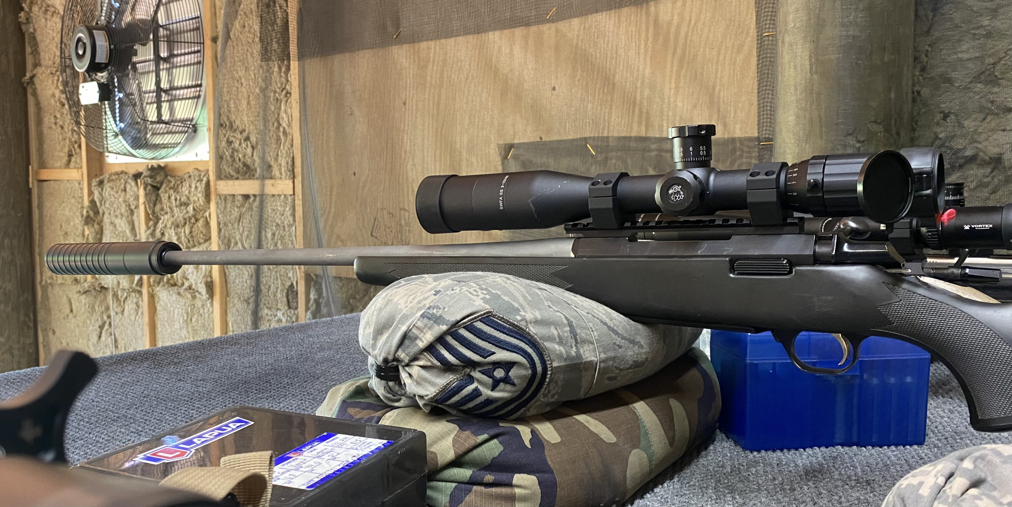

Ironically, that load is also from one of my 7mm RemMags. It's with Nosler brass (neck-sized only for consistency), with IMR 7977, CCI 250's, and Berger 168 VLD's. It's coming out of my custom-built Browning A-Bolt II that I had blueprinted and rebarreled and then cut down to 22.5" and threaded for a can. That group was with my Otter Creek Labs Hydrogen-L 7.62 hanging off the end. Before I had the Bulletseeker and now the Garmin Xero, I used to strap the chrono bayonet to the can, and set the proper height that way my results depict real-world conditions, exactly how it will be when I'm hunting.
Current configuration with the Zeiss V4 6-24x50...
I had the SWFA scope on there temporarily for load development while waiting on the new Zeiss V4 6-24x50 to come in...
LOL. We all have cherry picked chrono pictures.
I can post 20 or 30 pics of 1 and 0 sd.
That's not the true SD though. You're giving out just as much misinformation as you claimed you were helping prevent.
Your SD from that sample size can be up to 6fps (which would be around a 35-40es) 95% of the time....with the possibility of being higher the other 5%.

That's not your actual SD. That's a sample SD.
