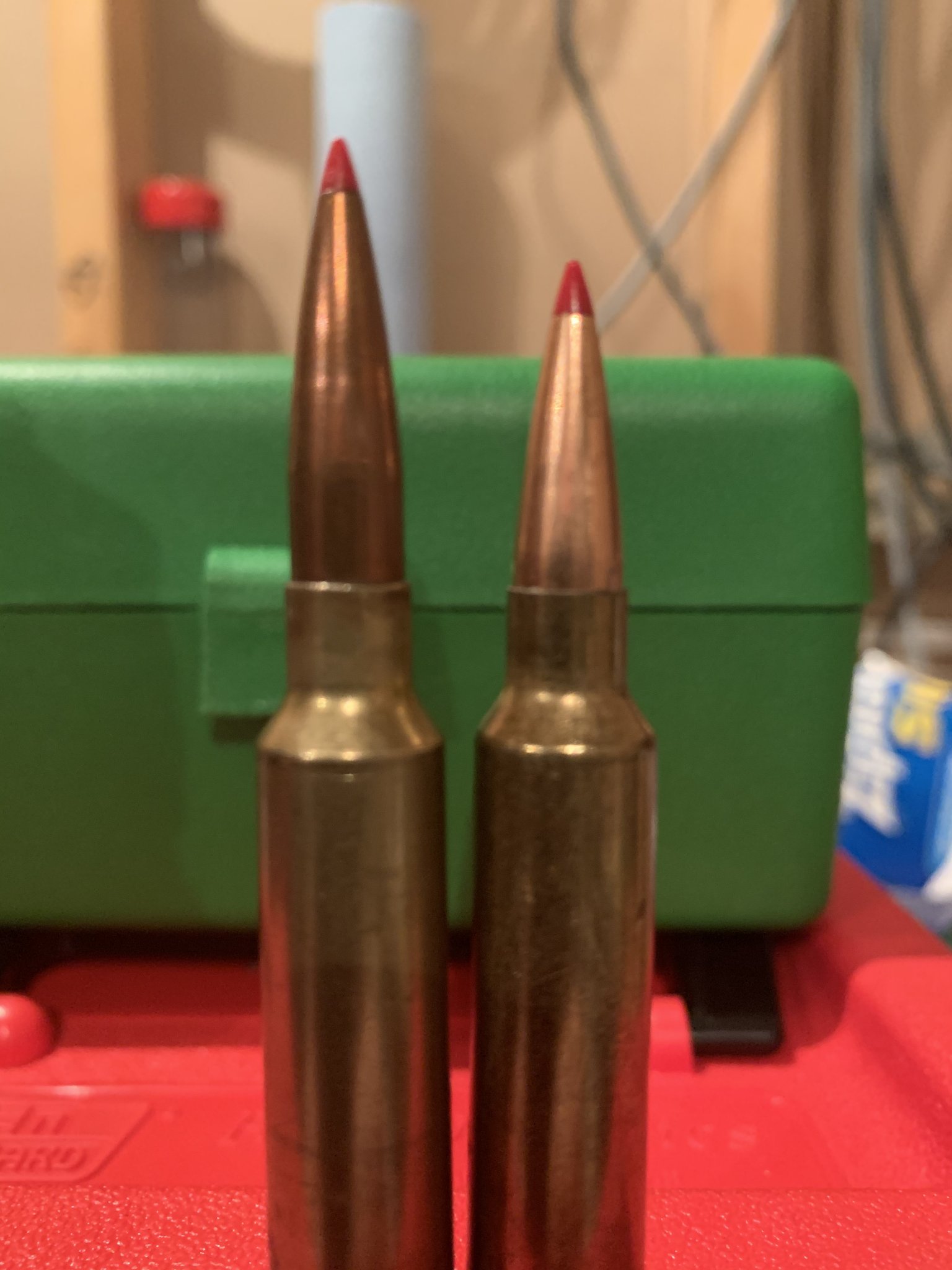

Be aware that the 284 will have a long jump on a short action if you don’t use a custom reamer. Here is an example of one loaded 0.02” off lands for one I had and one loaded to max magazine feeding length for an arc magazine. Both with 180 eldm
