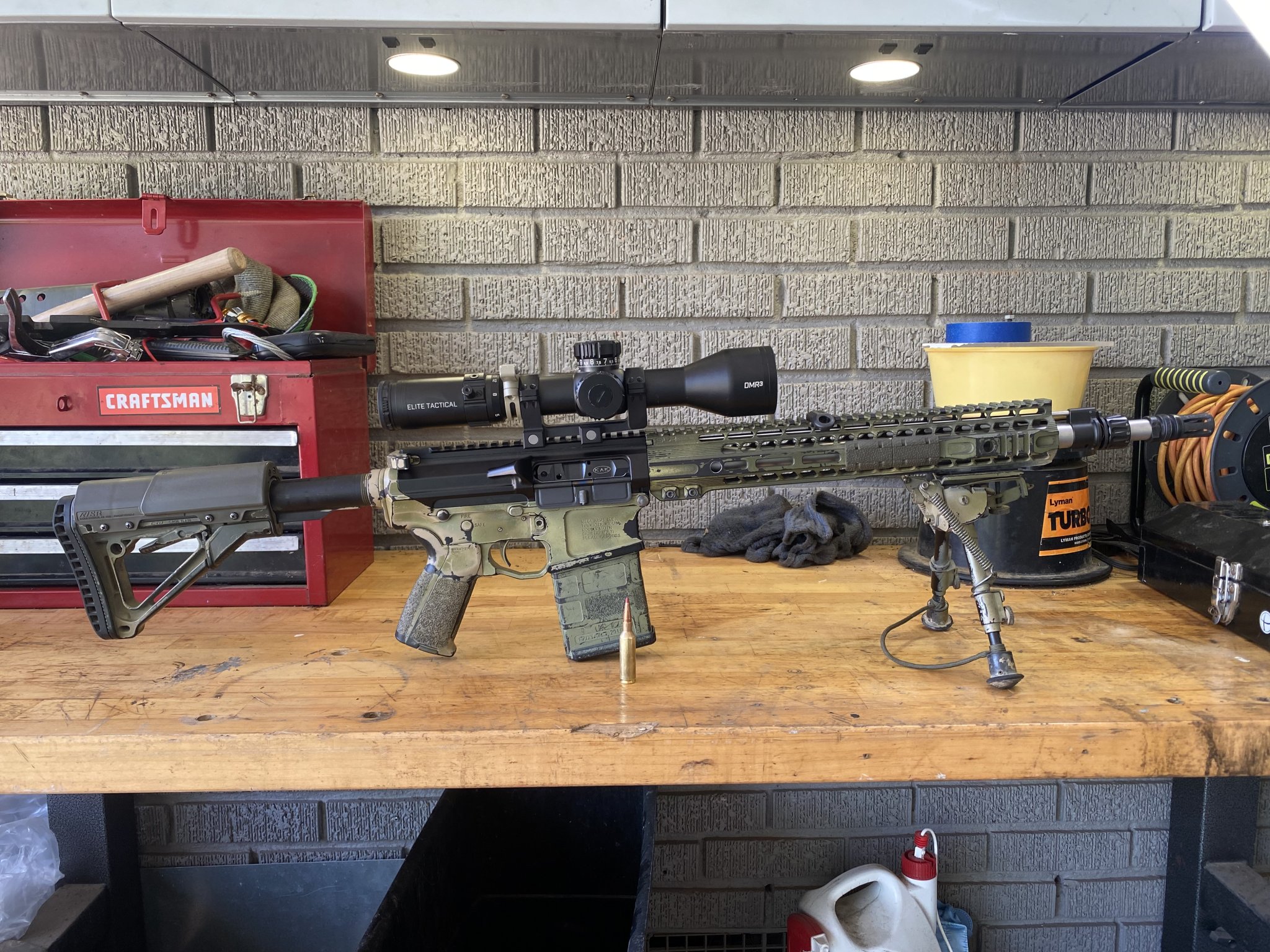

I have officially assembled a 7mm SAUM AR10. This whole thing started when I found an Aero M5 lower on sale for $98... I had X-Caliber cut a 24" barrel, using a KAK magnum bolt that I sent them for proper headspacing. While the barrel was in queue, I started gathering parts. I used a KAK magnum bolt carrier group, as stated earlier, and a KAK magnum stripped upper. They essentially just mill a larger ejection port. It's a little bit cheesy though, because they mill it AFTER anodizing. I really don't care, as it'll probably get rattle-canned somewhere down the line anyway. I put an adjustable gas block on it, as well as a jp heavy scs. It should be (relatively) tunable to ensure proper function. I threw on a luth-ar fixed stock because it was one of the few I could find with adjustable comb.
Dimensions are just shy of 46" and 12.5 lb. My plan is to shoot it suppressed, so the actual dimensions while shooting will be in the lower 50s and around 14lb.
Why 7mm SAUM you ask? The SAUM line has piqued my interest for awhile, actually. And full disclosure, had I been able to find 300 SAUM brass, I'd probably have gone with that instead. I like the idea of having a semi-auto magnum... maybe it just sounds cooler than it really is, but oh well. It's definitely capable of taking any game in my local area, and if I want to shoot it long range, I can do that too. I think the 7mm is incredibly adaptable to whatever you want It's use to be. I have larue SR-25 mags that have a COAL limit of 2.870, and book COAL on 7mm SAUM is 2.825, so I have a little bit of room to play with for seating depth. Let me tell you, those little bastards ain't cheap! Consensus on accurate barrel life seems to be about 2000rds. I picked up 300 pcs of ADG 7mm SAUM brass, that will (hopefully) survive the life of the barrel. I figured 6 loadings should be ok, and I only need about 60% of them to last a 7th. Time will tell, I guess.
Let me know what you think. I only took one picture so far, so that's the one I put up with it, but if you want anything specific, don't be afraid to ask. And if you want a full build list, I can do that too. Might even be able to throw a price list together, if desired.

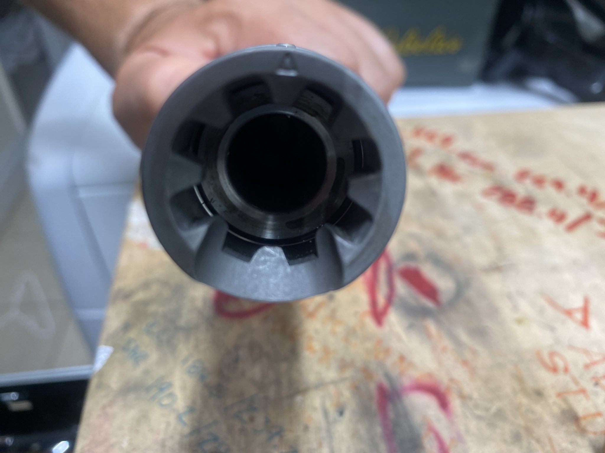

Something interesting I noticed tonight; the X Caliber 7SAUM barrel has a single feed ramp rather than the traditional “M4” style dual ramps. Given this I’m going to proceed with an MJF printed single stack magazine designed to fit in a “SR-25” mag well.

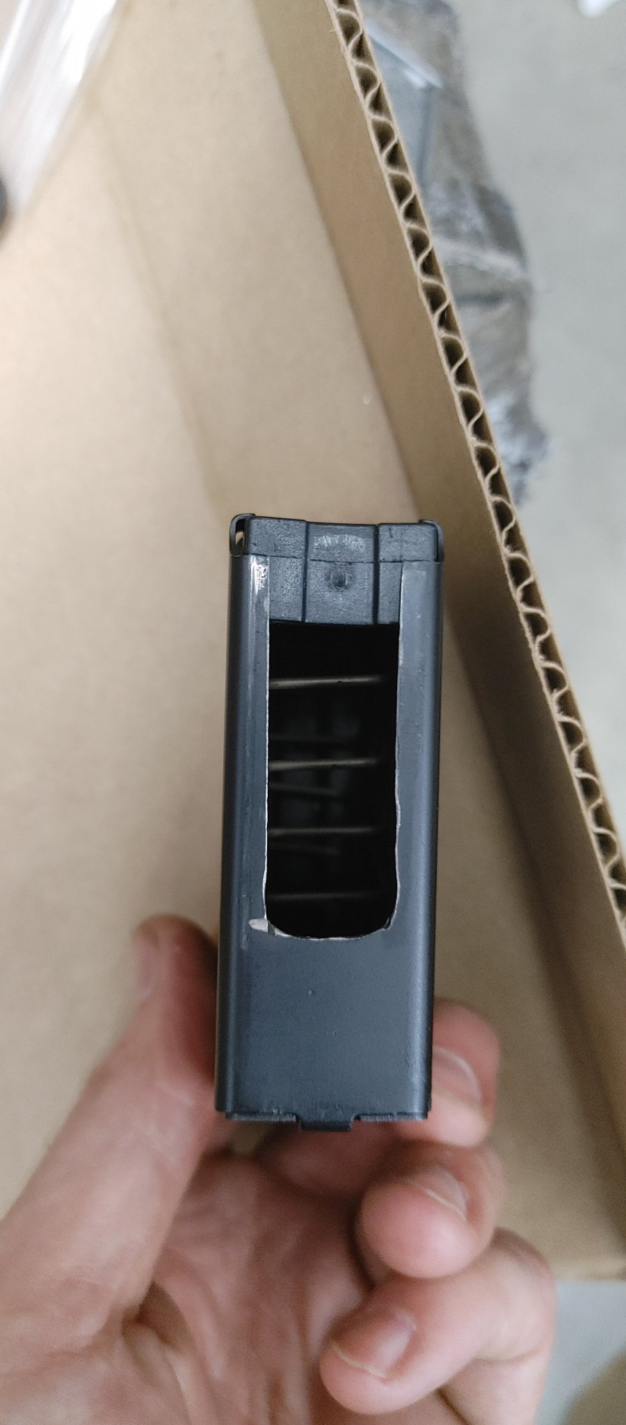

A prototype of the single stack mag may be printed this week as well.
Reactions: Jdowns0415
I designed it based off of some research and other magazine dimensions. The first print has some issues. The rear webbing being so thin allows the side walls to bow out.
This is just the first rev.

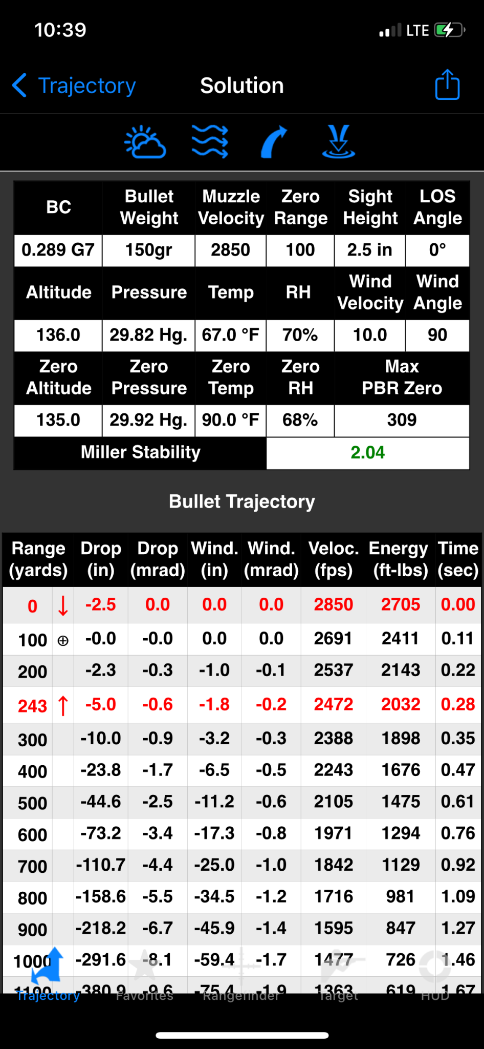

Now that I’ve got more data I’d like to get input from the site.
I’ve done ladder test with the 150 ELDX over H4831SC & 7828SC and a 10 shot string with 61.5 of H4831SC. The H4831 load had an average velocity of 2809 with an SD of 10, grouping was 1”. With 7828 I was able to get a velocity node at 50fps over H4831 with a max of 2923.
All that said if the 7828 load groups well I’ll be looking at a load with the ballistics shown on the attached screenshot. I’d like to know where y’all would take the load. Try a different powder or try the 162 ELD? I’d like to go ahead and try anything new now so I can dial in everything for deer season.
The 7828 load(external ballistics) is within my original “design spec” for 500yd capable deer rifle. Grouping will need to improve but the velocity is there.

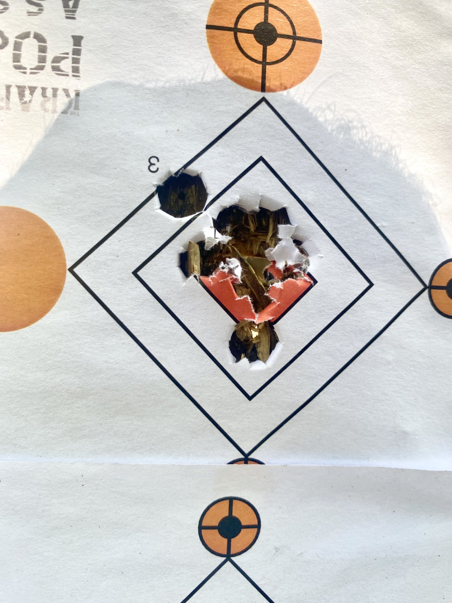

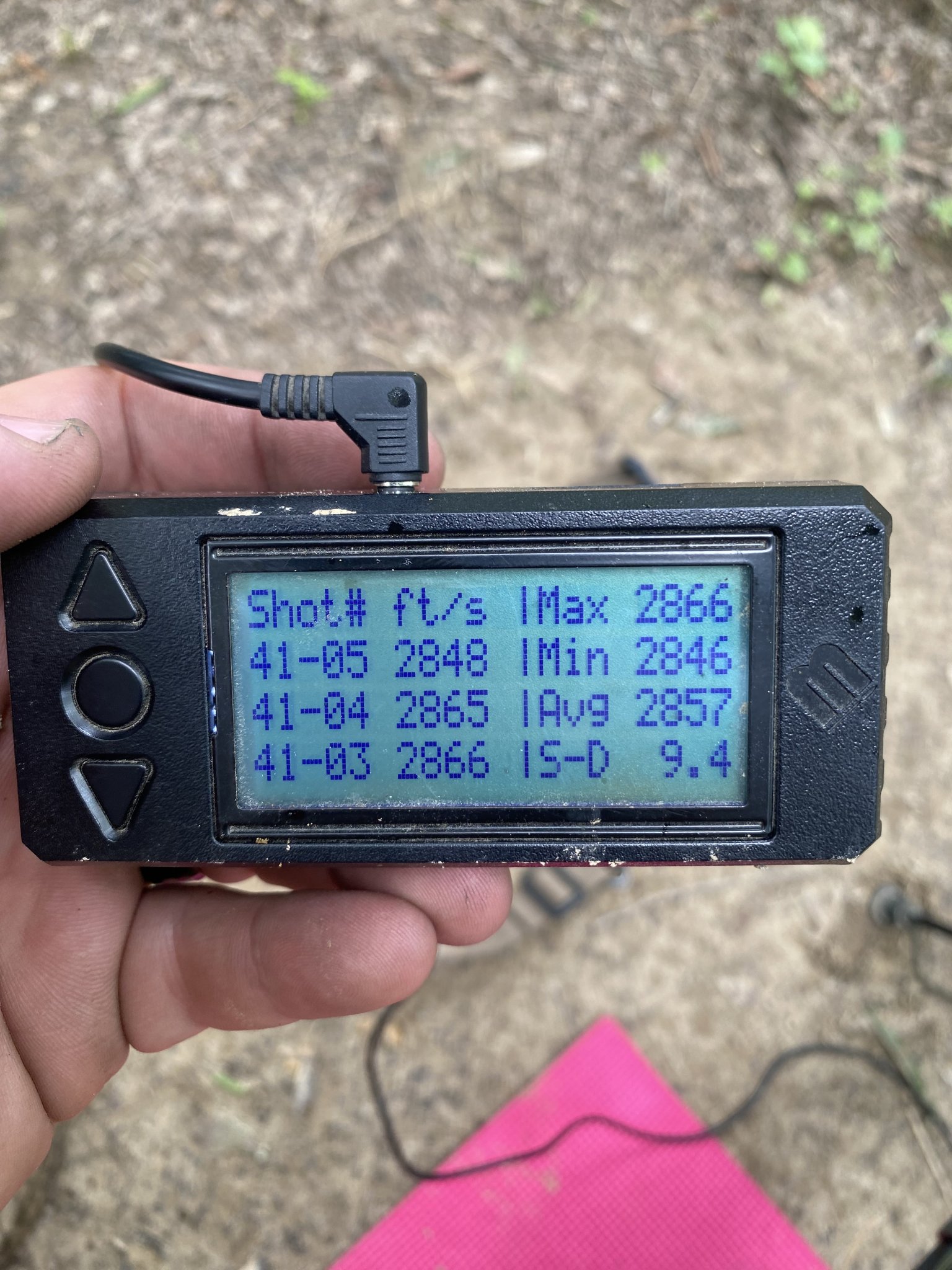

The 150 ELDX / 62.3gn of 7828 load did very well today.
Average velocity of 2857 / SD 9.4 and a nice tight group minus a first round flyer. I’ll load up 20 or so rounds and stretch it out to distance.
also tried the 162s /7828, found a velocity node around 2770.
I think I’ve solved the magazine issue as well.
