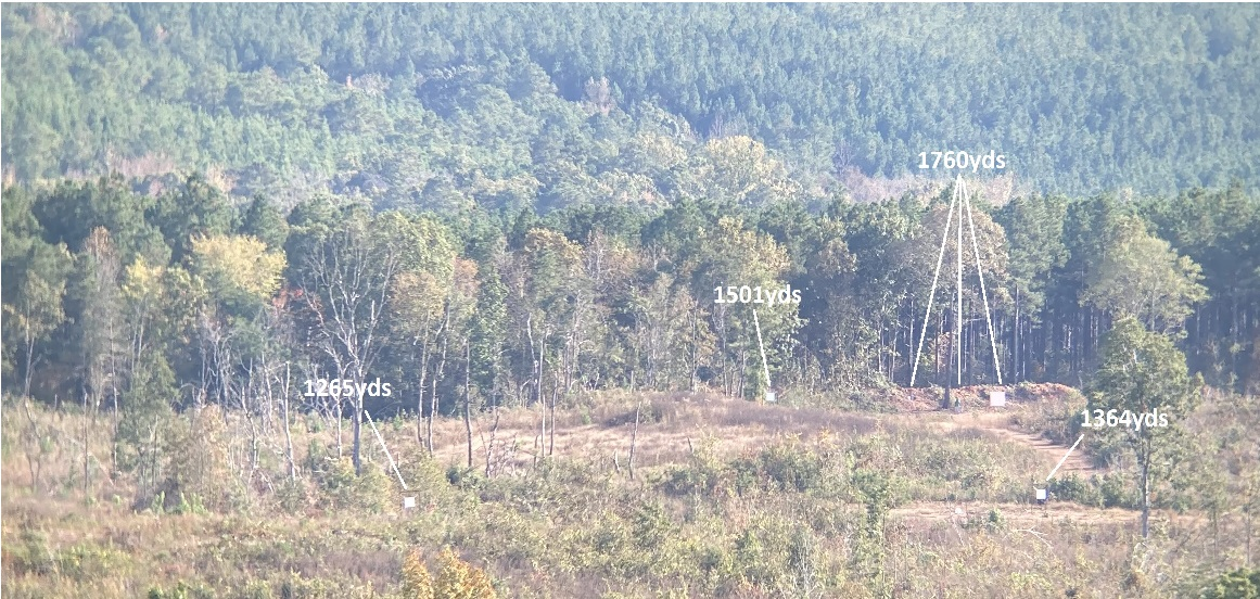

Looks like it's around. This thread's got me weighing my options between keeping the wife or building that saum. There's a range out to a mile about an hour and a half away from me now......

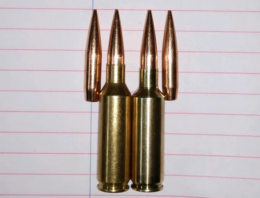

In my experience, couldnt get them to fit in a mag w/o stuffing well into the powder column. Also left very little flexibility for depth. 7SS alleviates all of those issues. Theres a reason so many build a SAUM on XM or LA actions.
Yea, this is 7SAUM on the left and 7SS on the right, both with 180 hybrid. Can see that in the 7SS it takes up a lot less of the powder column to get bullet to mag length. (this picture was taken from Rich's website)
What is the OAL for both? Why not build on a tikka or medium action so you're not stuffing the bullet way past the neck?

In that picture the OAL is 2.920" for both. You could absolutely do that. But it isn't need for the 7ss, it can get damn near max potential from the cartridge in a short action, no need for a long or medium action. In that picture, the 180 hybrid is loaded to what most people try to achieve, the boat tail junction right at the neck/shoulder junction of the brass, and it still fits in a standard magazine fed short action. Most short action AICS mags have the option (no binder plate) be loaded to 2.950" OAL.
build the SAUM....I was at Colemans Creek last weekend...it's awesome! I was smacking the 1 mile with Berger 140 hybrids from my 6.5 GAP 4S (aka 6.5 SAUM). Fortunately there was very little wind! :) The 1 mile targets are a 4'x4' plate with an Ivan and a 12" plate to the left.
That's the range I mentioned in my post. Small world. I have a 6.5 PRC that should do the job on the 4x4 plate.
