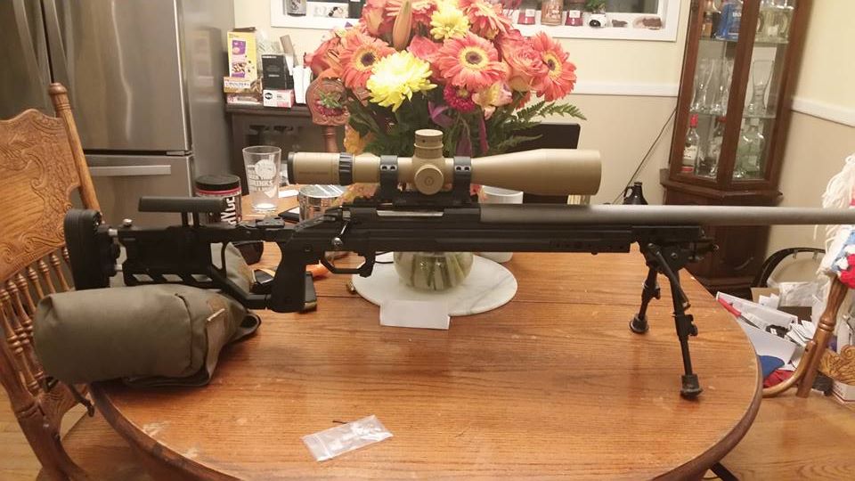

I have basically the same rifle you are thinking of building. A M995 in a KRG Chassis. I went 300 Winchester Magnum though. However I toyed with idea of putting another barrel on it and using it for PRS/making it modular/why not.
I would think that the CIP Mags would work just fine for SAUM, as long as you made sure to push them towards the back.
However, there is another option. KRG makes a space block that would allow you to use the 30-06 length single stack magazines/the non-CIP magazines.
Or you could really overdo it, and make it into a 7STW and launch 195gr bullets really really fast!
