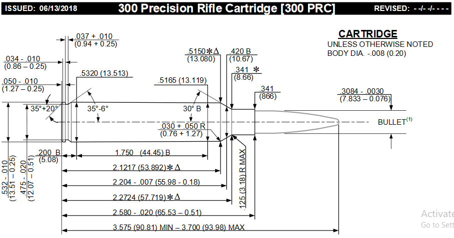

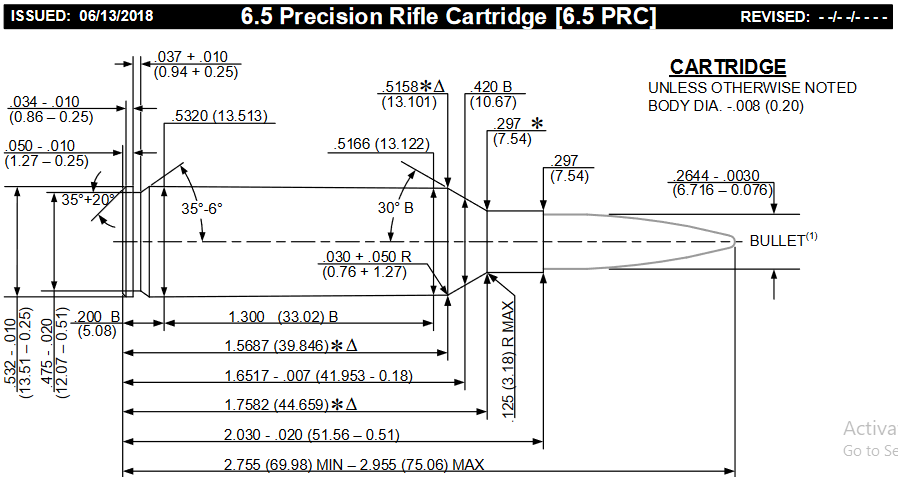

So many new cartridges to go with for the next build but which is truly best? Anyone out there running any of these and have insight? Accuracy? Reloading? Barrel Life?
7mm SAW
https://westtexordnance.com/7mm-saw/
6.5 PRC/300PRC
http://bulletin.accurateshooter.com/2018/08/its-official-saami-approves-hornady-6-5-prc-and-300-prc/
https://www.thefirearmblog.com/blog...tandards-6-5-300-wby-mag-6-5-prc-and-300-prc/
