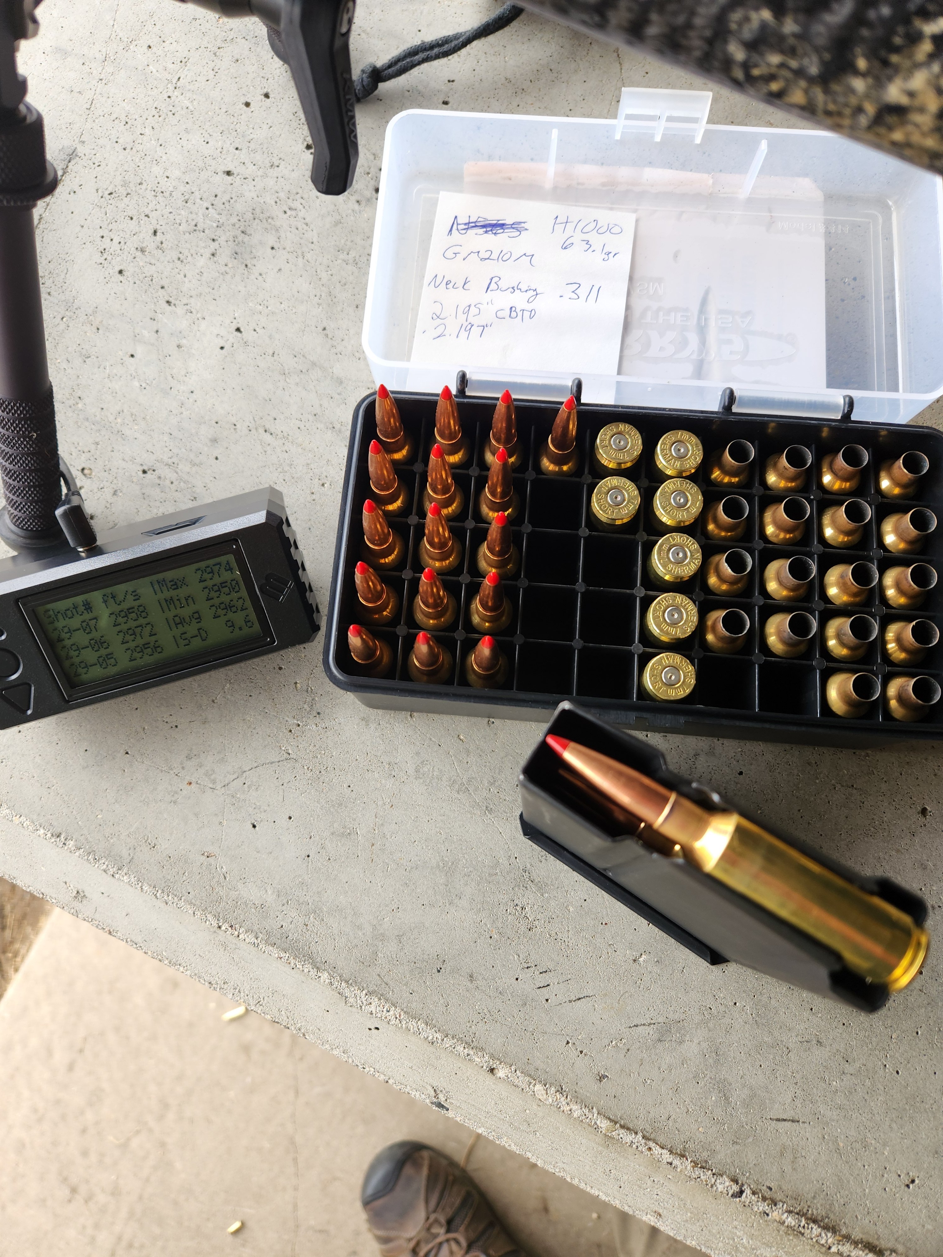

FWIW, a friend is building a .284/LA, 28” or 30” (can’t remember which) barrel of fairly heavy contour. He’s not going suppressed on this one, so he added barrel length.
Planning on 180 Bergers around 2,850.
Strictly a tool to hammer range steel way out there. It’ll probably work…..
175 ELD-X
63.1gr H1000
GM210M
.311 Bushing
2.196" CBTO
Reactions: Rothprec
