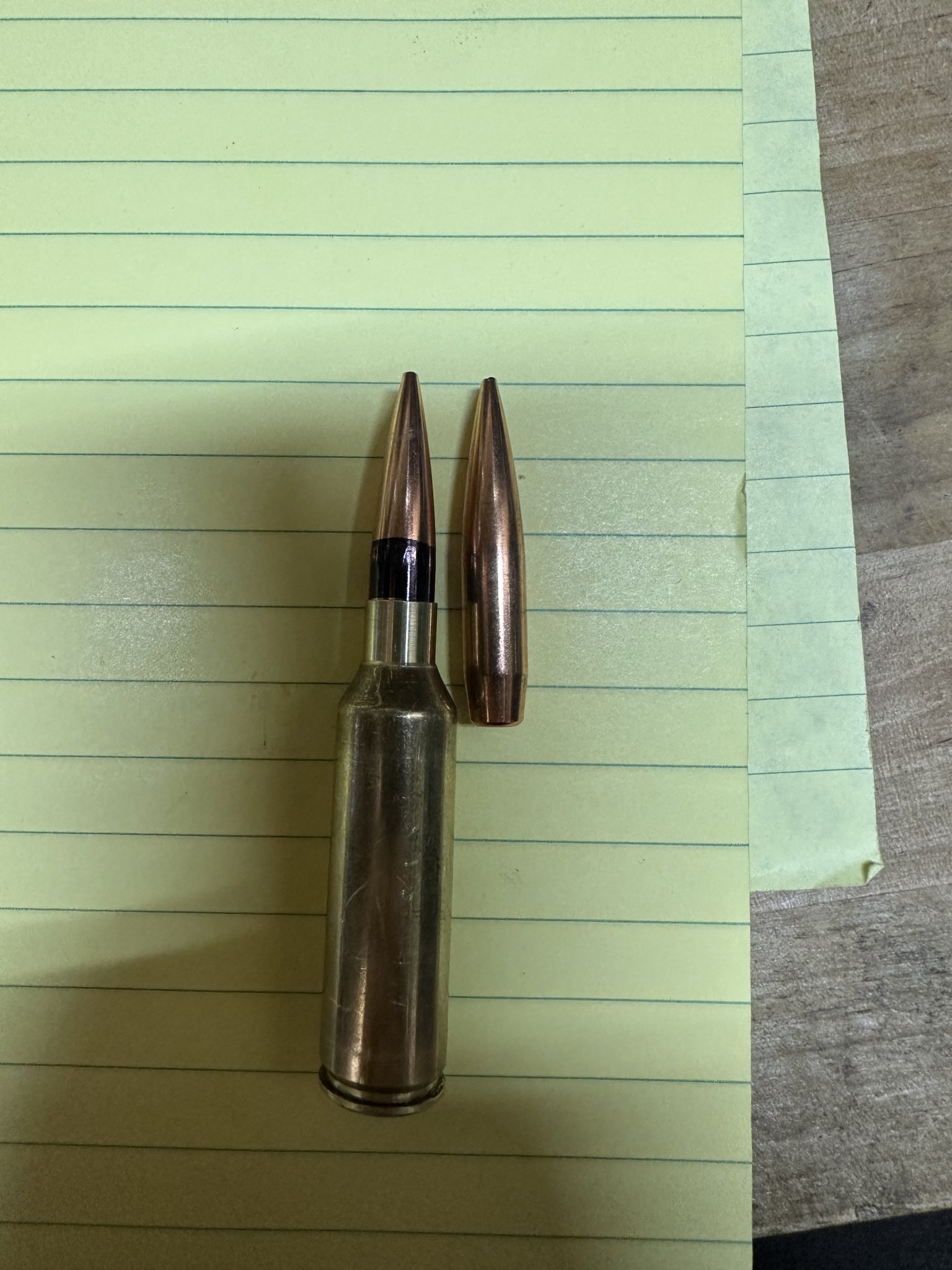

I'm setup for 7SS just haven't had a barrel spun up yet. Making mock up rounds with 180gr and 190gr rounds was impressive to see how well they fit in a short action. I don't plan on pushing it hard, I'll be happy with medium pressures. If I need more performance I'll bring my 300NM.
I don't like rounds where I feel I'm fighting mag length constantly. Plus brass was easily available, those are my main reasons for starting down the 7SS path.

Here's a 175gr ABLR seated 20 thou off the lands. COAL to the lands is 3.200 in this chamber. I asked the gunsmith 12 years ago to throat it for Berger 180's and this is what I got. I think it seats the big bullets well in the neck. Like if you are agnostic to the action you run and just want to set up the chamber to run this cartridge right with these, I think this is it. I am at 2950 feet per second with 65 grains of RL 26. I think that is about 95 to 98% case capacity and there's not a bit of pressure. It is a 10 gun for wind at 9000 ft ASL. I'm really sure how much more performance you need . The only real challenge in the WSM in my perspective is getting a hold of brass if you don't already have a bunch stored away. If it weren't for that, I don't even think it would be a question.
