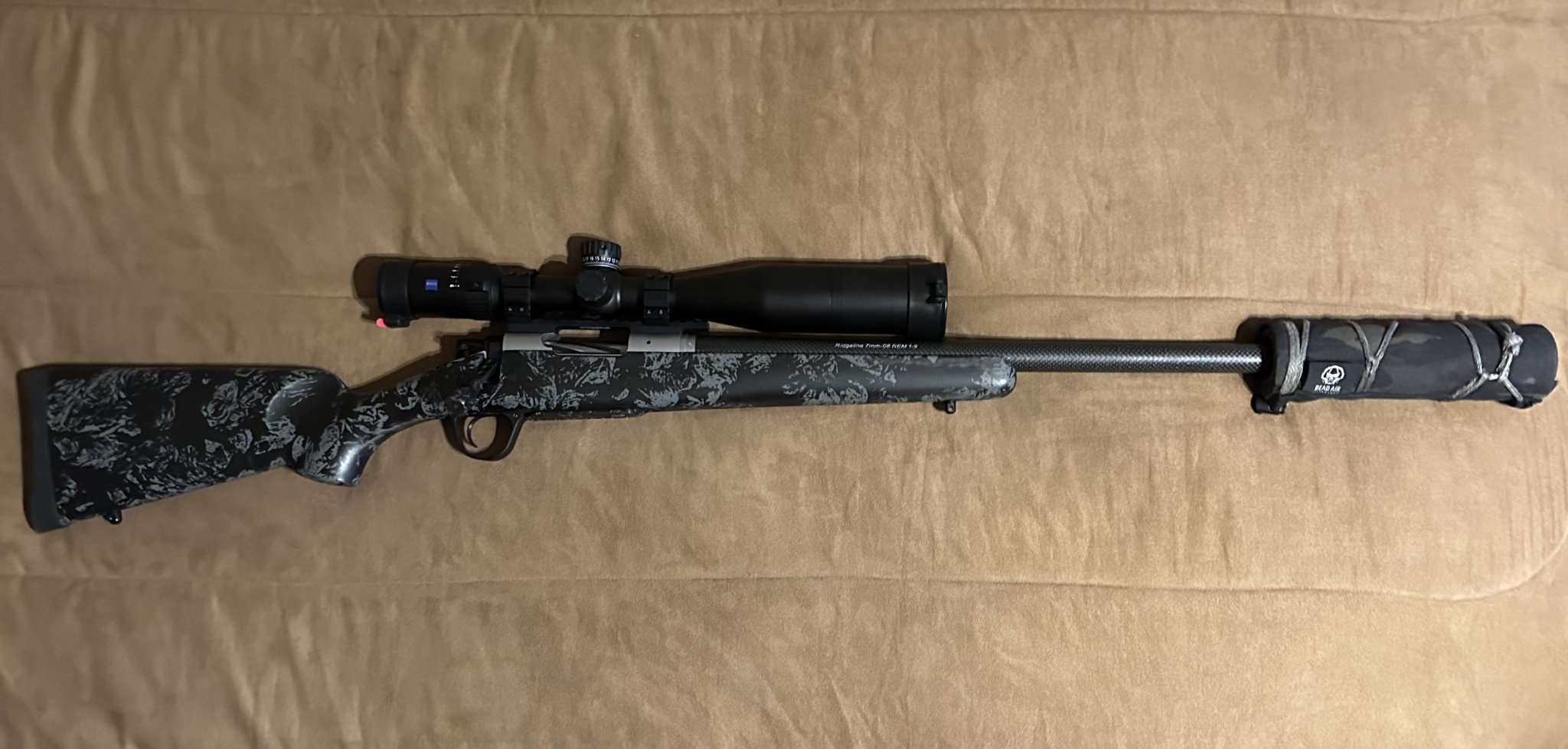

Christensen Arms Ridgeline FFT 20” 7mm-08… Has a 1:9 twist, which is fine up to Berger 175 Elite Hunters…Which is what I am working up loads for mine.
Even with the can, and the big scope, this rig is ridiculously lightweight.
