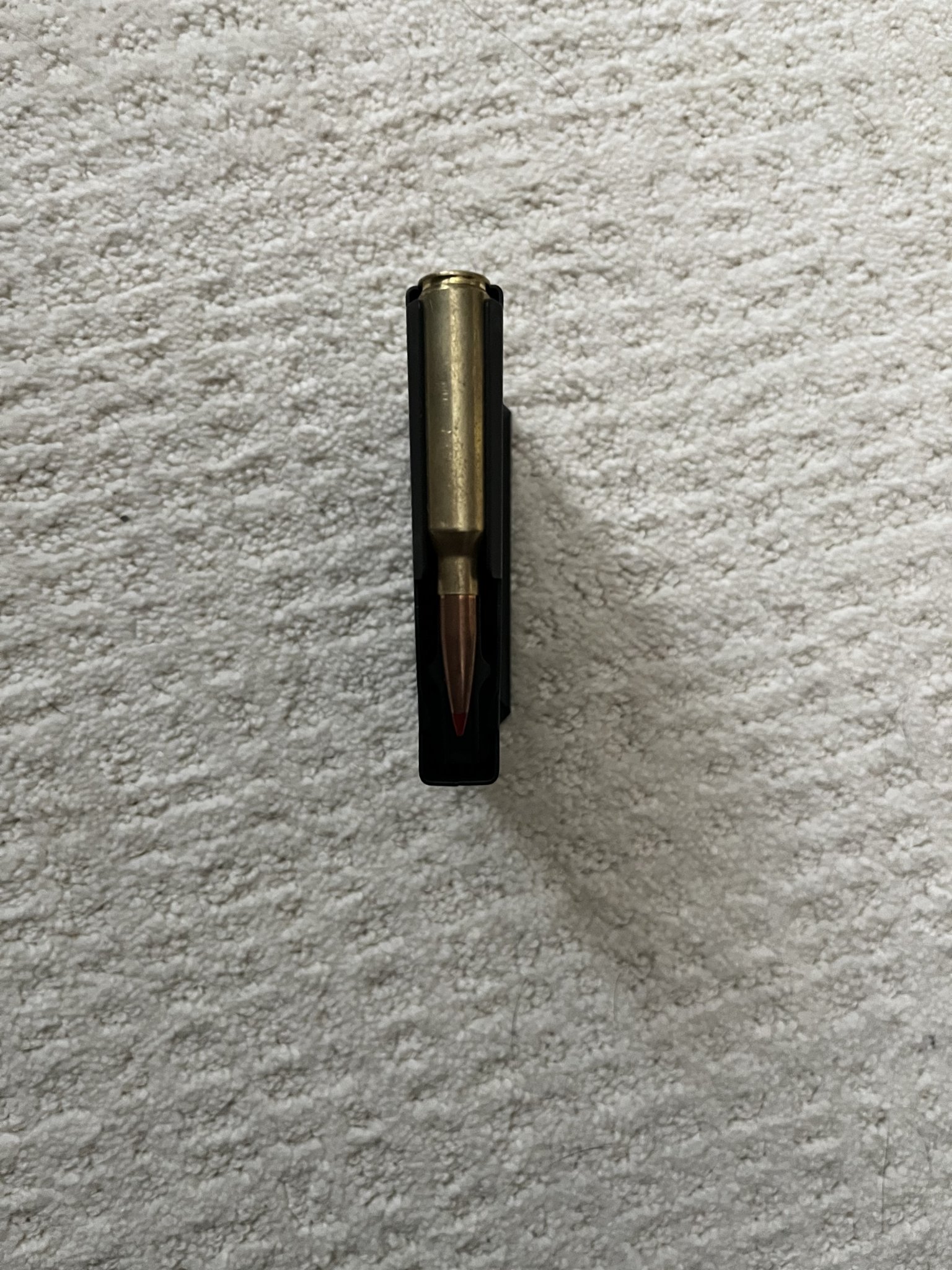

the standard length 3.715 magazines allow plenty of room for the 7 PRC. This is a photo a buddy texted me of his with a factory precision hunter 175eldx load.
