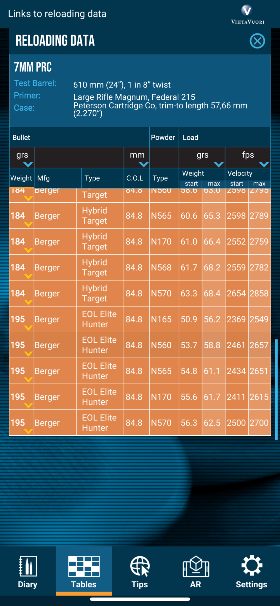

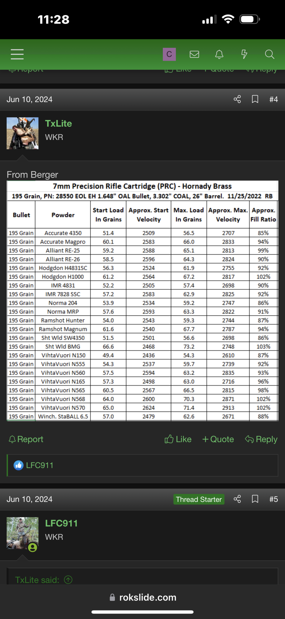

    Seen a mixed bag of results with powder charges of Berger info/ putting out and from Vihtavuori has on there reloading page.
    N570 62graIN MAX
    BERGER SAY 71 grain max
    Bergers using Hornady brass 26 inch barrel
    And V is using Peterson 24 inch barrel
    but that is a considerable amount of grains of powder difference like massive I’ve seen maybe two grains difference with the 6.5 Creedmoor but damn
    I thought the 195 grain would just be a bit much for this little 7 PRC
