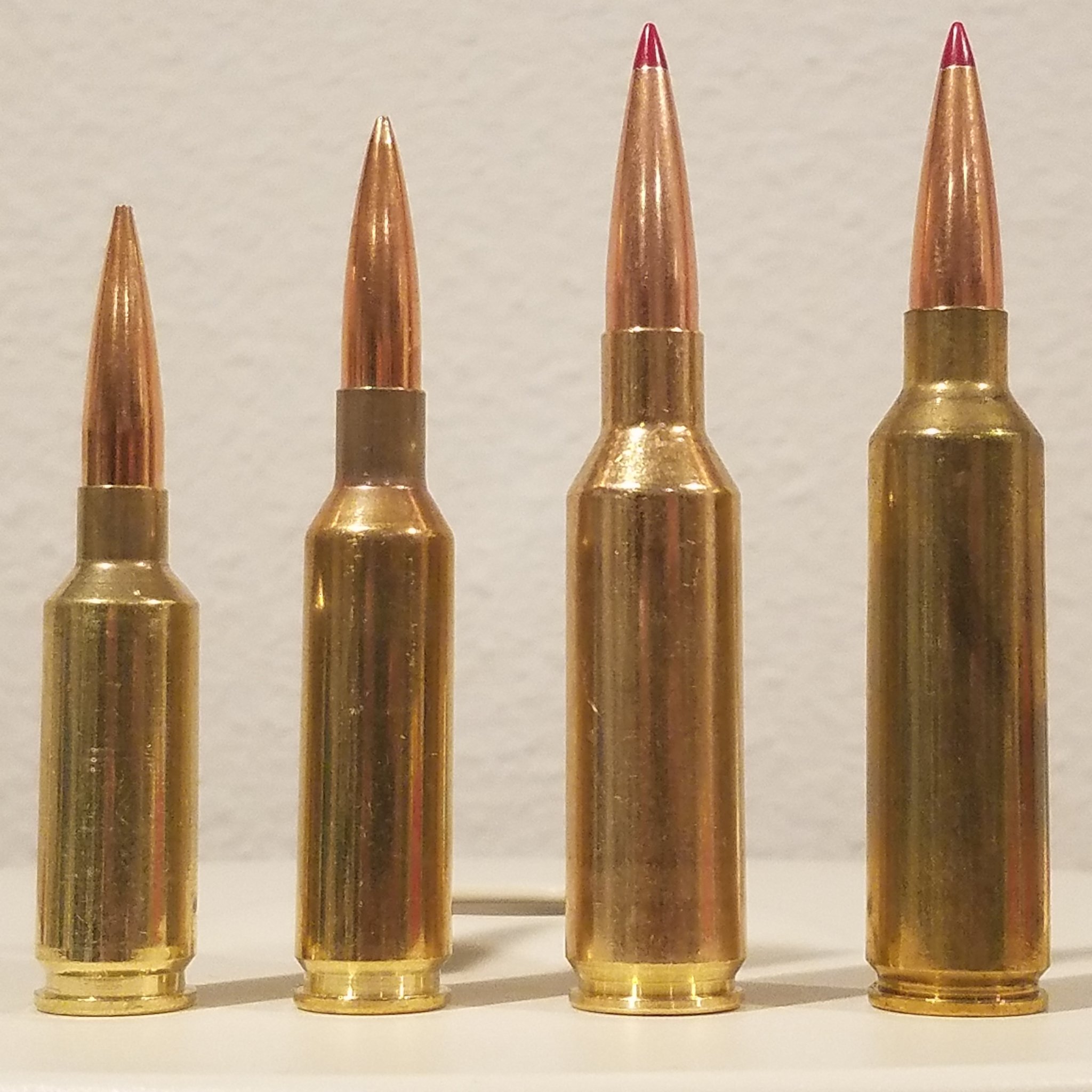

What velocity are you getting out of the saum6 Dasher, 6x47 Lapua, 7 SAUM, 7 WSM. Saum and wsm are both mag length.
