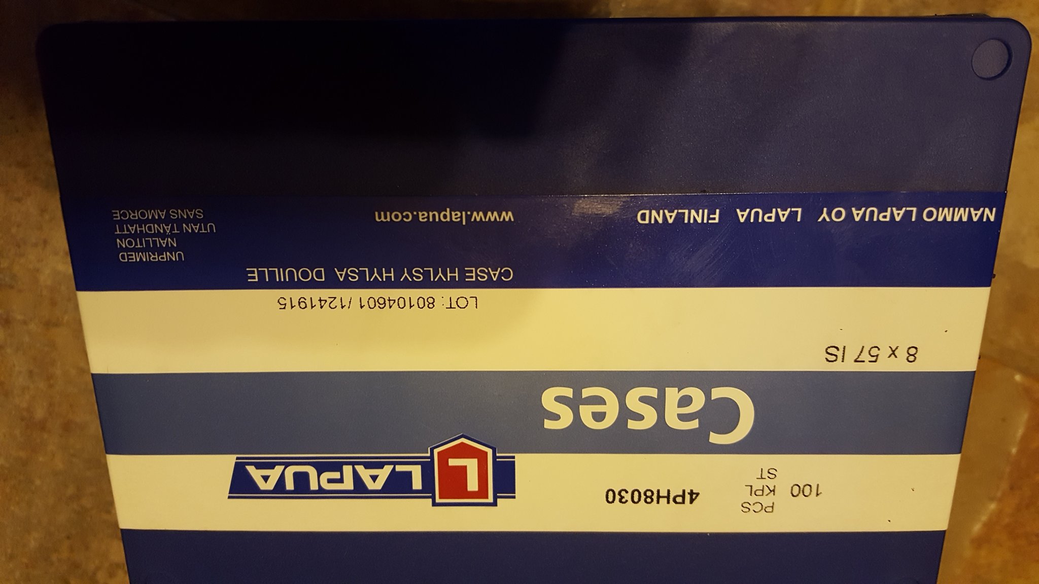

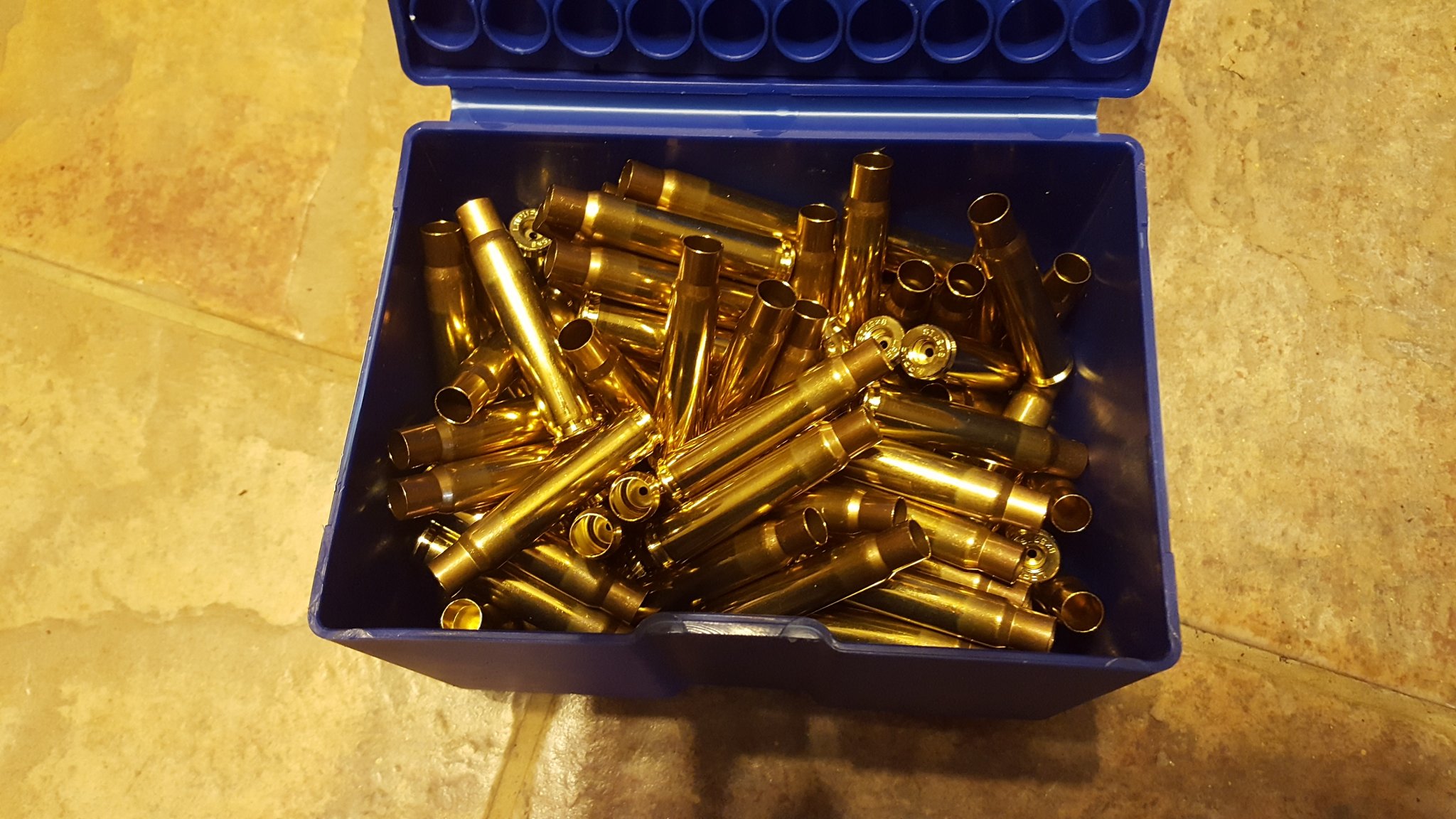

OK, I purchased 100 Lapua 8x57 brass, its here. I have a full length resizing die coming from Redding. The question is: how hard is it to use this die on 8x57 and not have issues with the neck, the 40° shoulder, or buckling the case? Any knowledgeable advice will be greatly appreciated, Thanks....
