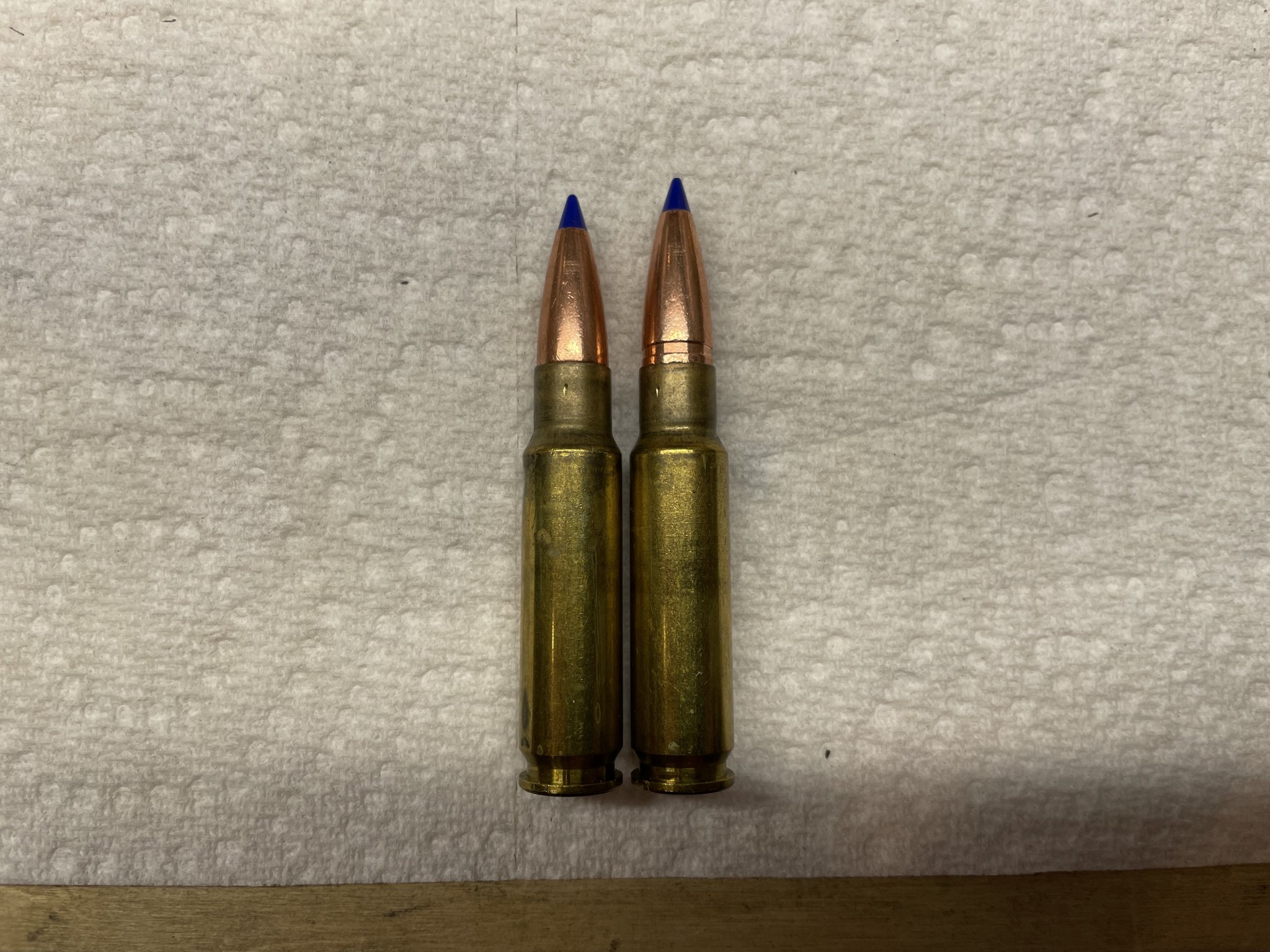

Anyone seen this round? It's the 2 in the middle. I invented it over 2 years ago. The rounds pictured are the subsonics. It also comes in supersonic and the ballistics are pretty good. I can share more information if anyone is interested. Kinda' competes with the 8.6CM. Mods feel free to move it if I'm stepping on this thread too much.

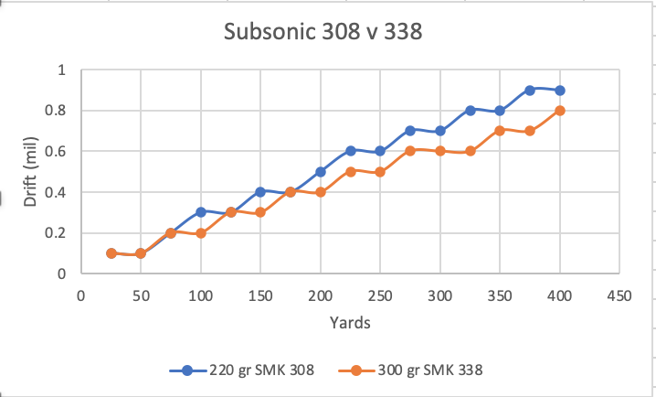

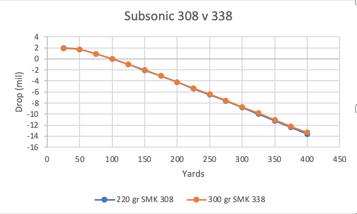

One thing you guys aren't comparing is the supersonic capability which should be a big step up from the 300 Blackout. If dedicated subs are all you are doing it might not be worth it. I am interested to see what kind of cool bullets we get out of it. The extra 35% bullet weight can't hurt especially in a subsonic bullet and eventually we might see some even heavier options.
.300BLK pushes a 220gr. @ ~1kfps .338BLK pushes a 300gr. @ 1kfps. So the momentum is 220k vs. 300k. Hardly anything to write home about and considering it takes the biggest and heaviest platform to send it, well, I guess I'll stick with my 8" .300's. They were made to solve a problem.
This thing looks like the answer to a question nobody asked.

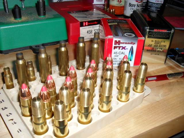

Isn't there already a .338 that fits the AR15 platform anyway?
If I remember right there are two 338 Whispers. One is based on the fireball and the other on the 6BR or 7BR. On the small case you are really pushing it and don't end up with much of a shoulder if I remember right. The 338 Spectre seems to be a much better solution from what I can tell reading what I can.

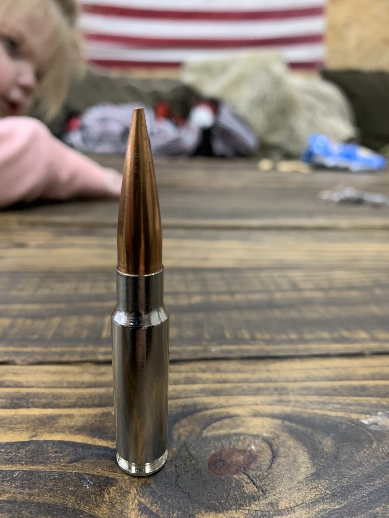

Anyone seen this round? It's the 2 in the middle. I invented it over 2 years ago. The rounds pictured are the subsonics. It also comes in supersonic and the ballistics are pretty good. I can share more information if anyone is interested. Kinda' competes with the 8.6CM. Mods feel free to move it if I'm stepping on this thread too much.View attachment 7458355
Who made the barrel for you?
so what are specs of the bullet?

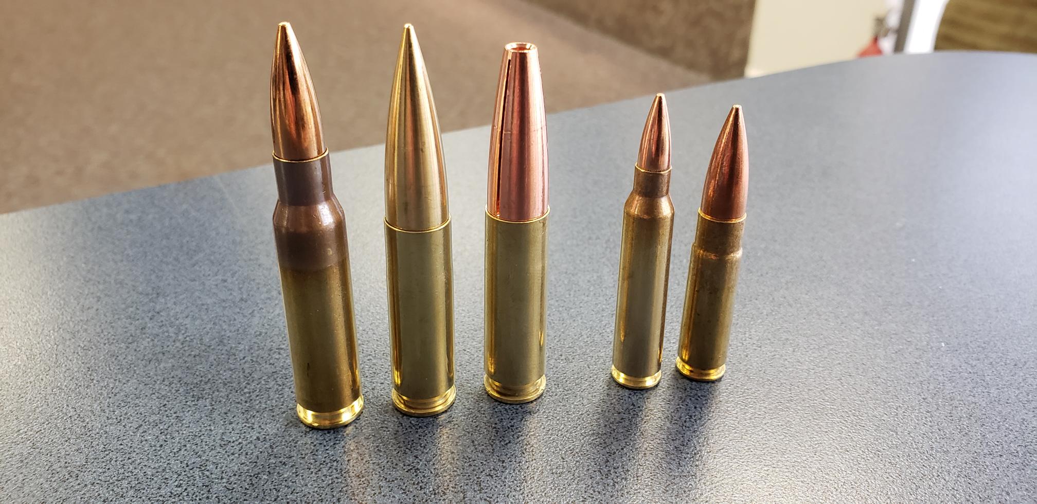

I used some beat up pieces of Hornady 6.5 Creedmoor brass and button sized them up to .338
The round on the left, the bullet is set with a COAL of 2.700”
The round on the right, the bullet is set with a COAL off 2.800” (the base of the bullet is set at the neck/shoulder junction
These are Barnes .338 160 TTSX’s
I did the same, was messing around in the reloading room and decided to neck up a piece of 6.5 creedmoor brass to .338.
I seated a 300 grain Berger bullet in it. Problem is where I have it seated at it won’t fit in an aics magazine. Definitely looks kinda neat though.
