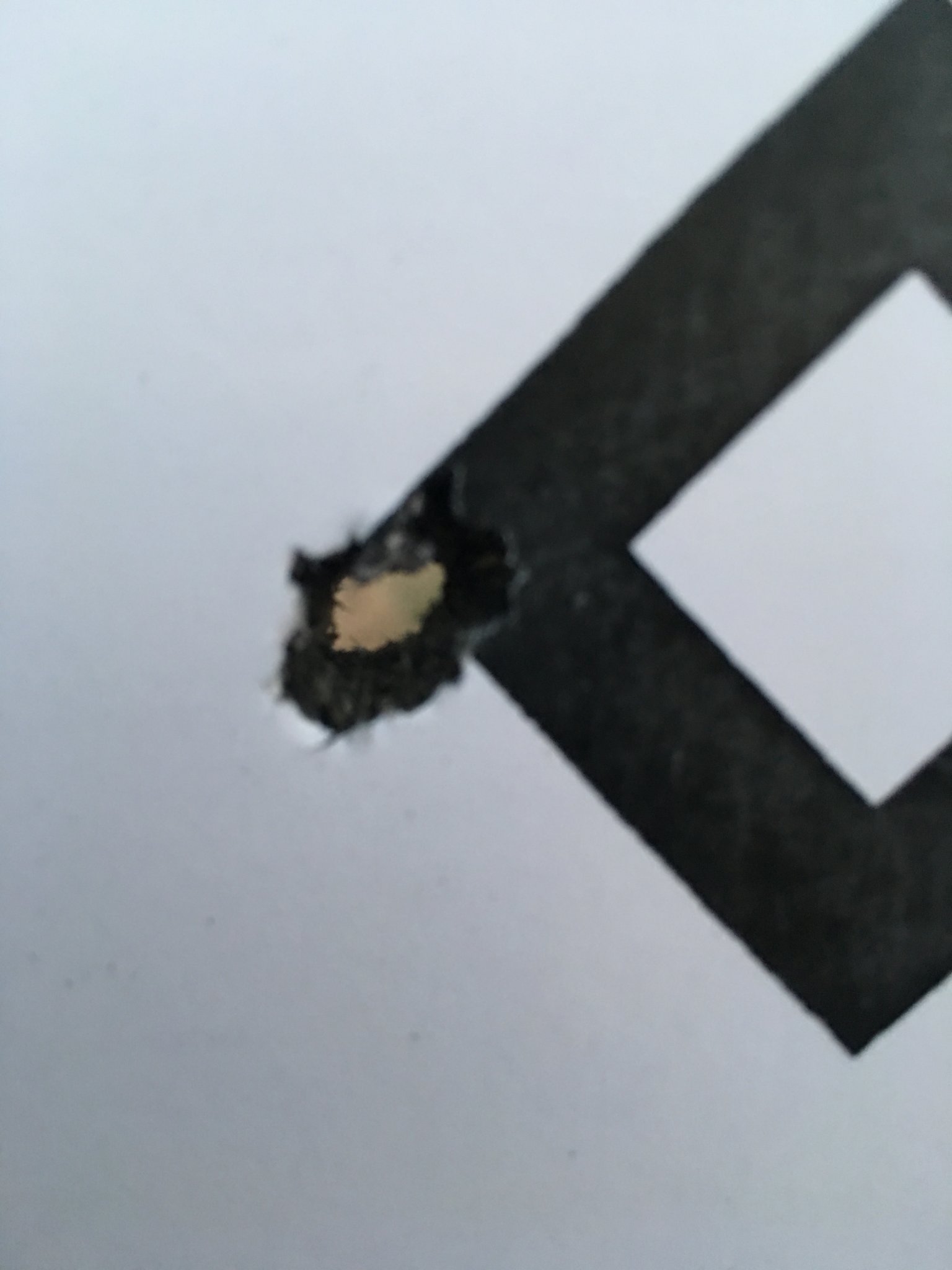

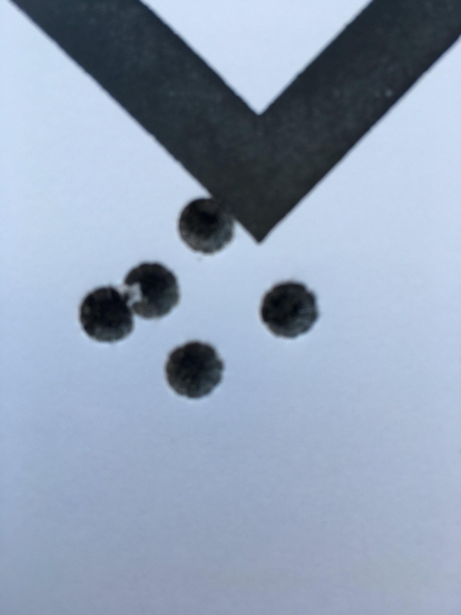

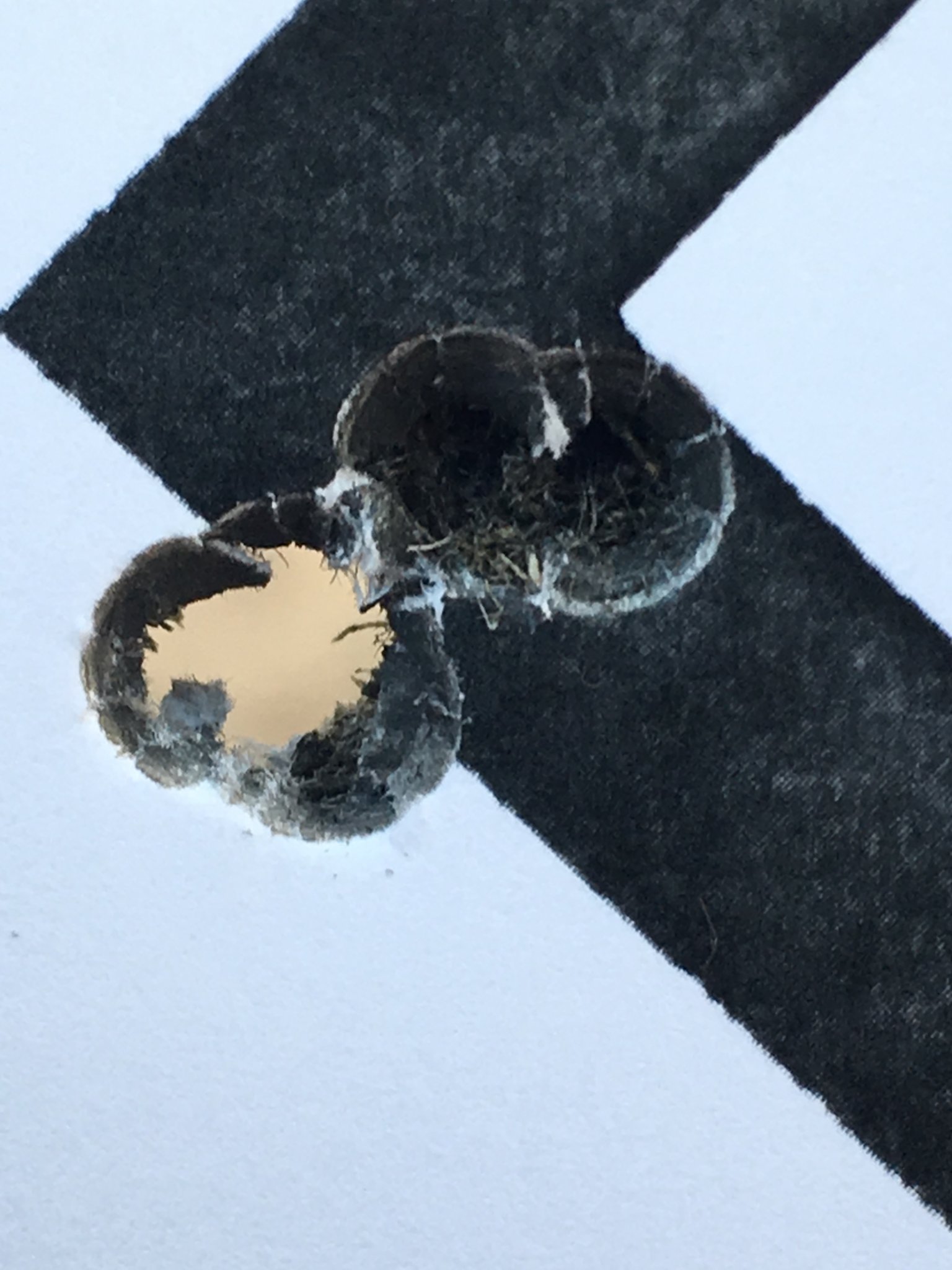

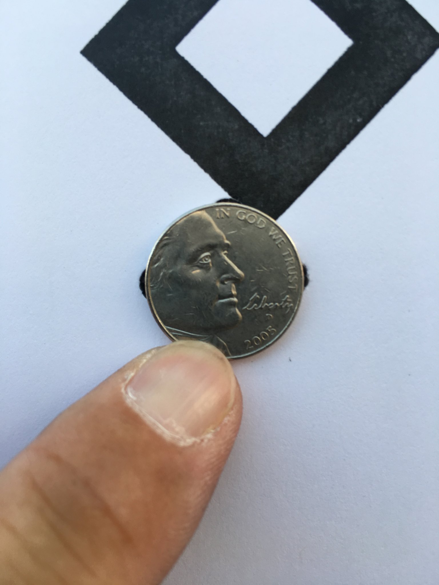

    Factory Rem 700, 5R, 20”, 223, NXS 3.5-15
    1st, 5 rd group @ 100
    2nd, 5rd group @ 200
    Nickle over 200 yd group for scale
    3rd, 5rd group @ 100
    2850 w/Berger 73 MBT from 20” bbl.
    I’ve got some 69 TMKs to try near future also.

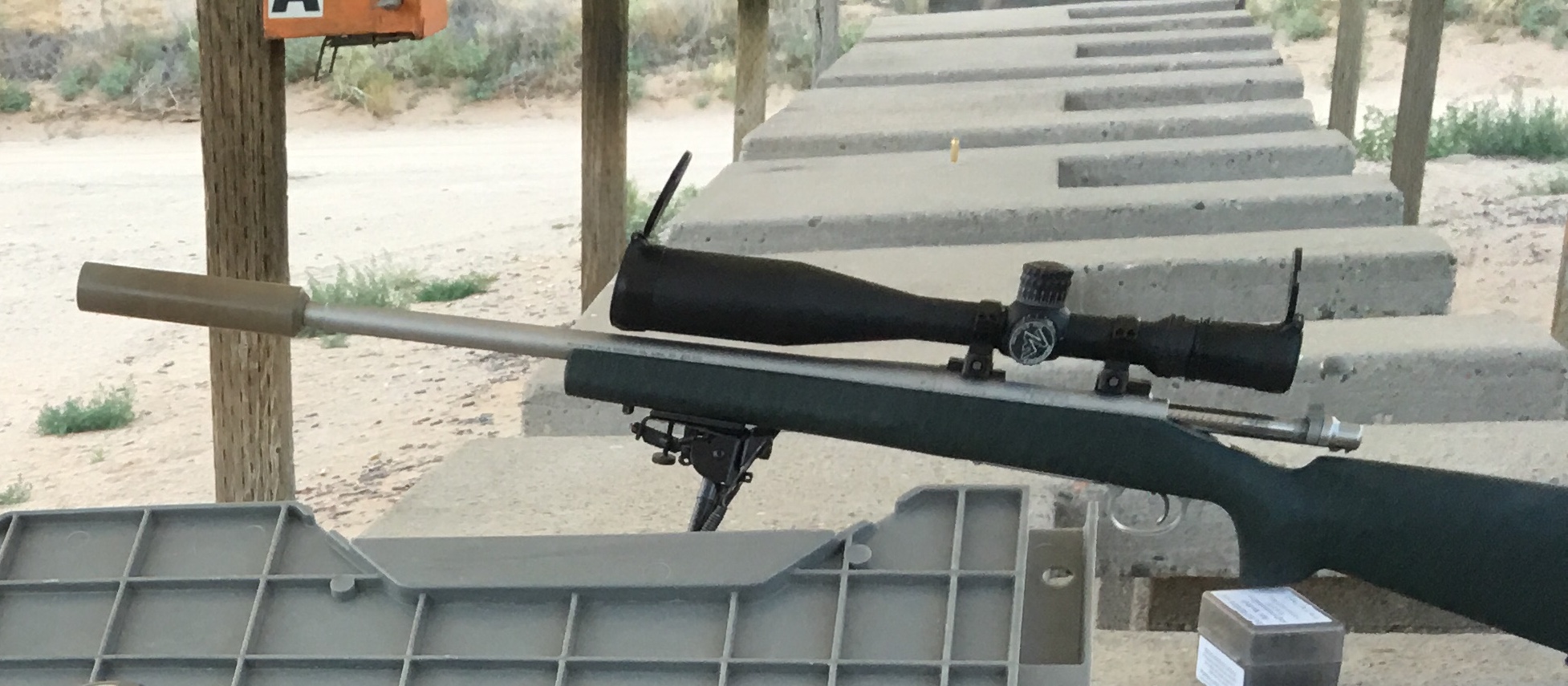

    I've been playing with my Tikka T3X Varmint (1:8 twist) in MDT chassis for over a year and a half, shooting mostly (factory and hnadloaded) 69gr and 77gr Sierra MatchKings out of it. Once in awhile I'll shoot 55gr bulk bullets (again, factory and handloaded) just to remind myself why bulk bullets are cheap.
    The 69s and 77s shoot into 1/2" @100 yards with pretty much every combo of powder/primer/brass I've tried. The 55s might shoot two or three into a nice group and the 4th and 5th wander two or three inches away.
    I haven't tried 50-55gr match bullets, plenty of others here get great results with them.
