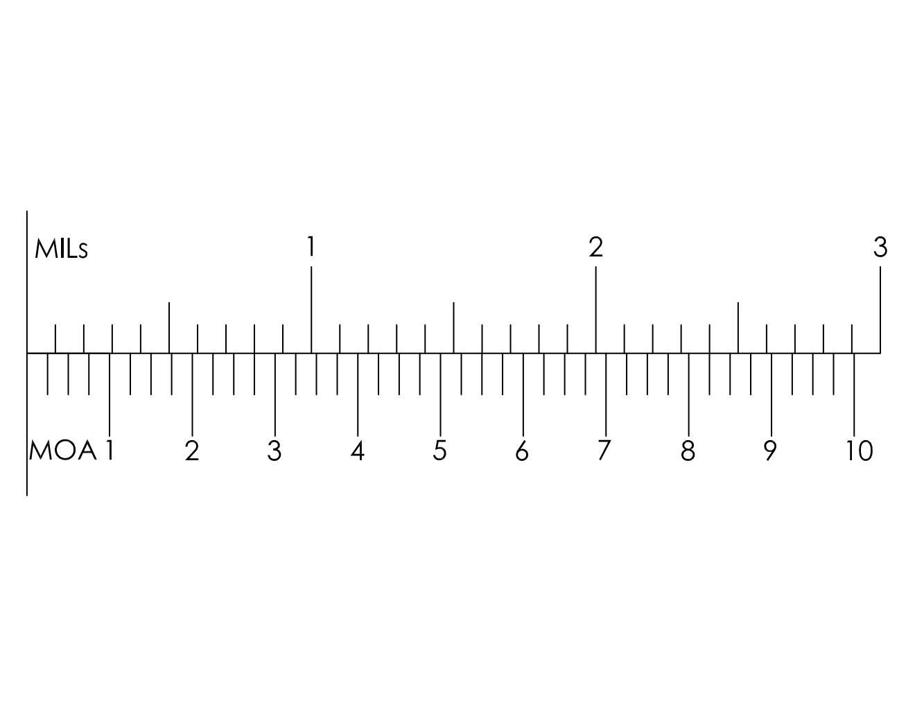

Here is a quick graphical chart for the MIL to MOA conversion for an arm bar. Print your size for your arm bar.
This chart ends at 10moa/3mil. its a good re-starting place for the adding. Example; 4mil = 10moa +1mil = 10moa + 3.5 = 13.5moa.

We just use 1 MOA per 1/4 Mil via the reticle, it's usually good enough for steel
.25 Mil = 1 MOA
.50 Mil = 2 MOA
.75 Mil = 3 MOA
1 Mil = 4 MOA

I get it, its a quick dirty short cut. Good for minute of man. But...a 308, 175gr going 2800fps in a 10mph wind @90deg have a 2mil wind call at 1000yds. ( i think)
As you have noted, Quite often your range in CO has 15 to 20 mph winds. That makes the wind call 3 to 4 mil at 1000. Using the "minute of man" version and calling 4 mills to be 16 moa will make the wind call off by .6mils or 2.25moa. 0.6mil at 1000 is 21+ inches. Even a 10mph wind will be 10+ inches (as bad as MOA vs 1" at 100yds) Being off by 21 inches is barely minute of man. Shooting a 2 moa competition target would be a real issue.
I can see using the short cut when dealing with shorter ranges or less wind, but sometimes, in a game of precision, we all need the real number.

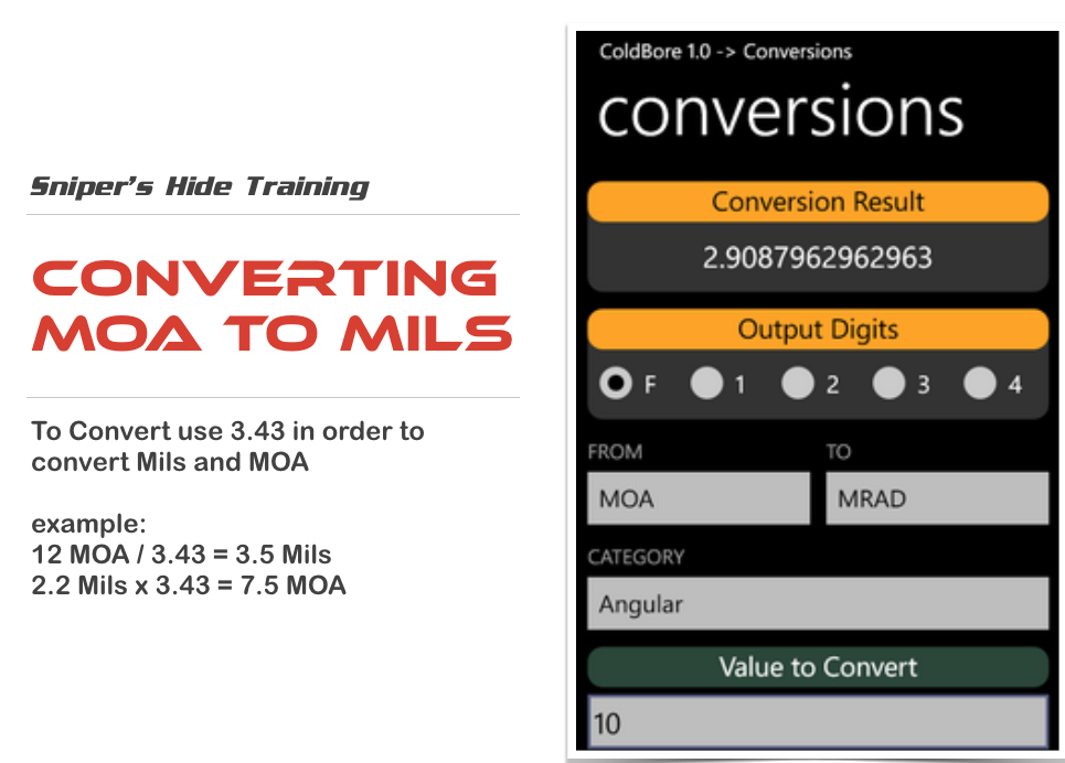

We don't wing it in class we give them actual data,

I use 1mil=3.5 moa if we know that then .5mil=1.75moa .1=.25 .2=.75 .3=1.
1.8 mil for me is 7moa -.75moa= 6.25 cheat 6min in to the wind and shoot it. Hope that helps that arm bar would be tough for me but if it works for you run it.
Thanks for the info. Pretty close to what Frank does too.
I think this is mostly for the new guys that need to convert quickly. And Mike made a comment in the pod cast he was trying to run an equation and get an arm bar for quick reference but didn't have any luck at it. I think having this around would just eliminate the head math.
