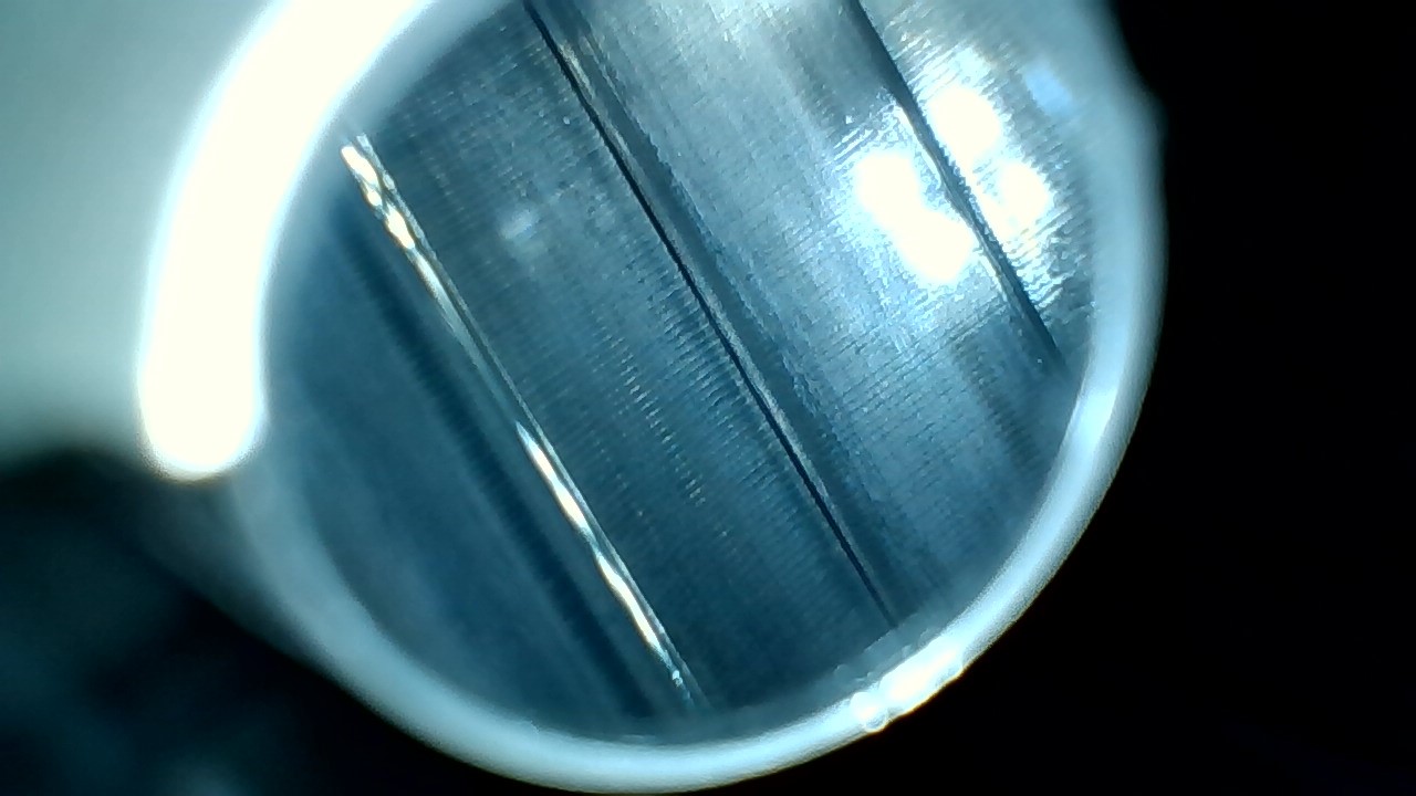

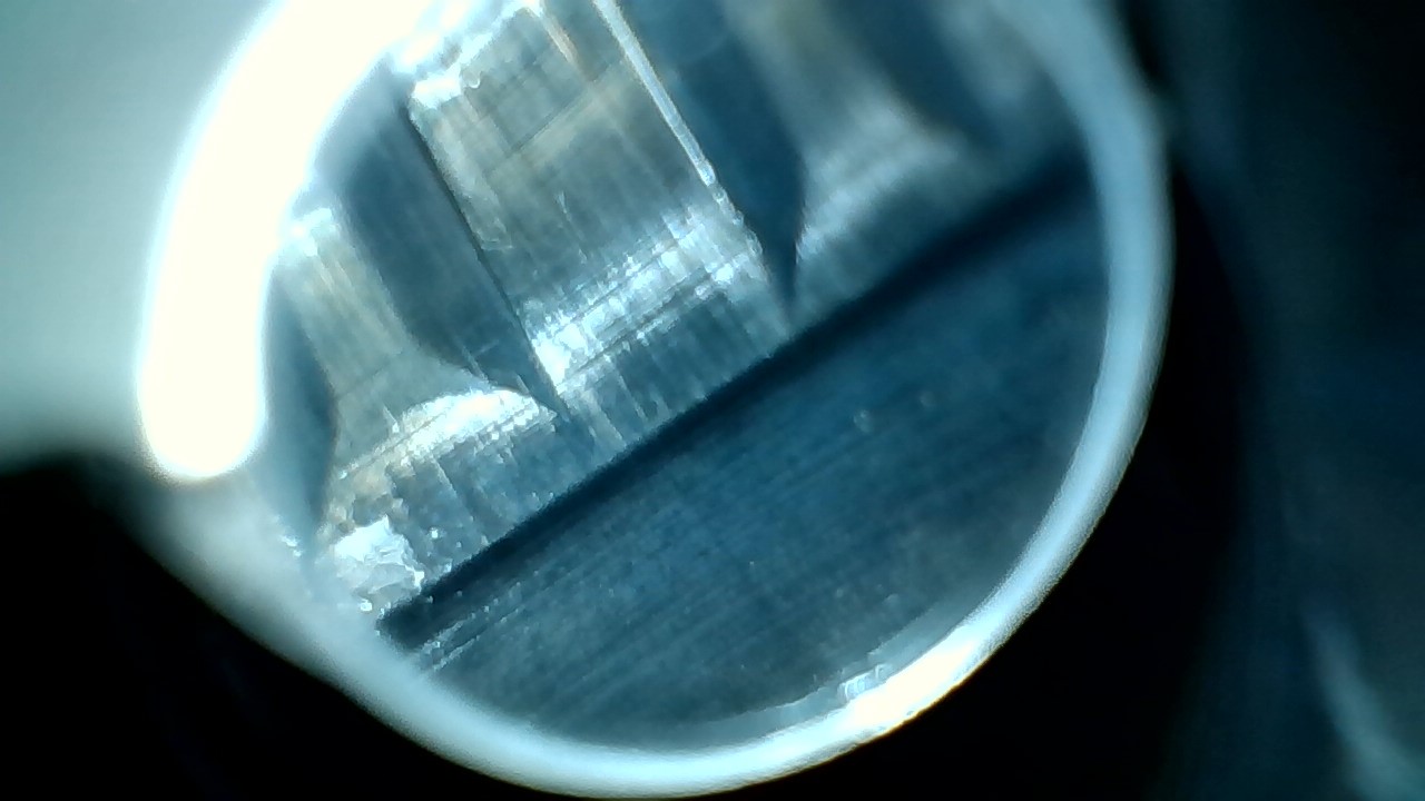

I thought my barrel might be bent, so I re-adjusted and zeroed the windage at 7 yd, 18yd, and then checked it with the SL-150 laser boresight at 45-90 yd. It was dead-center at all of these distances. So the barrel is presumably "pointing straight".
