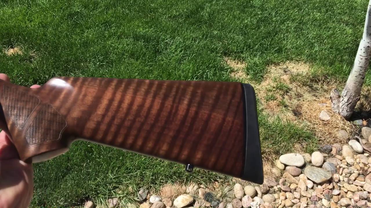

    Not grill marks, its supposed to look like this

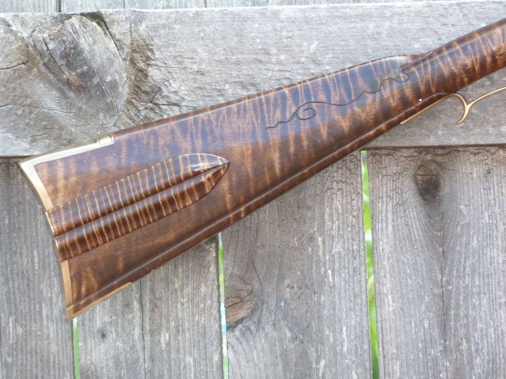

    If the wood doesn't already have the inherent grain patterns you want, no amount of soaking, burning, chemical agents, or even stains are going to make it look the way you want it. Real curly maple looks the way it does because it's got curly grain!

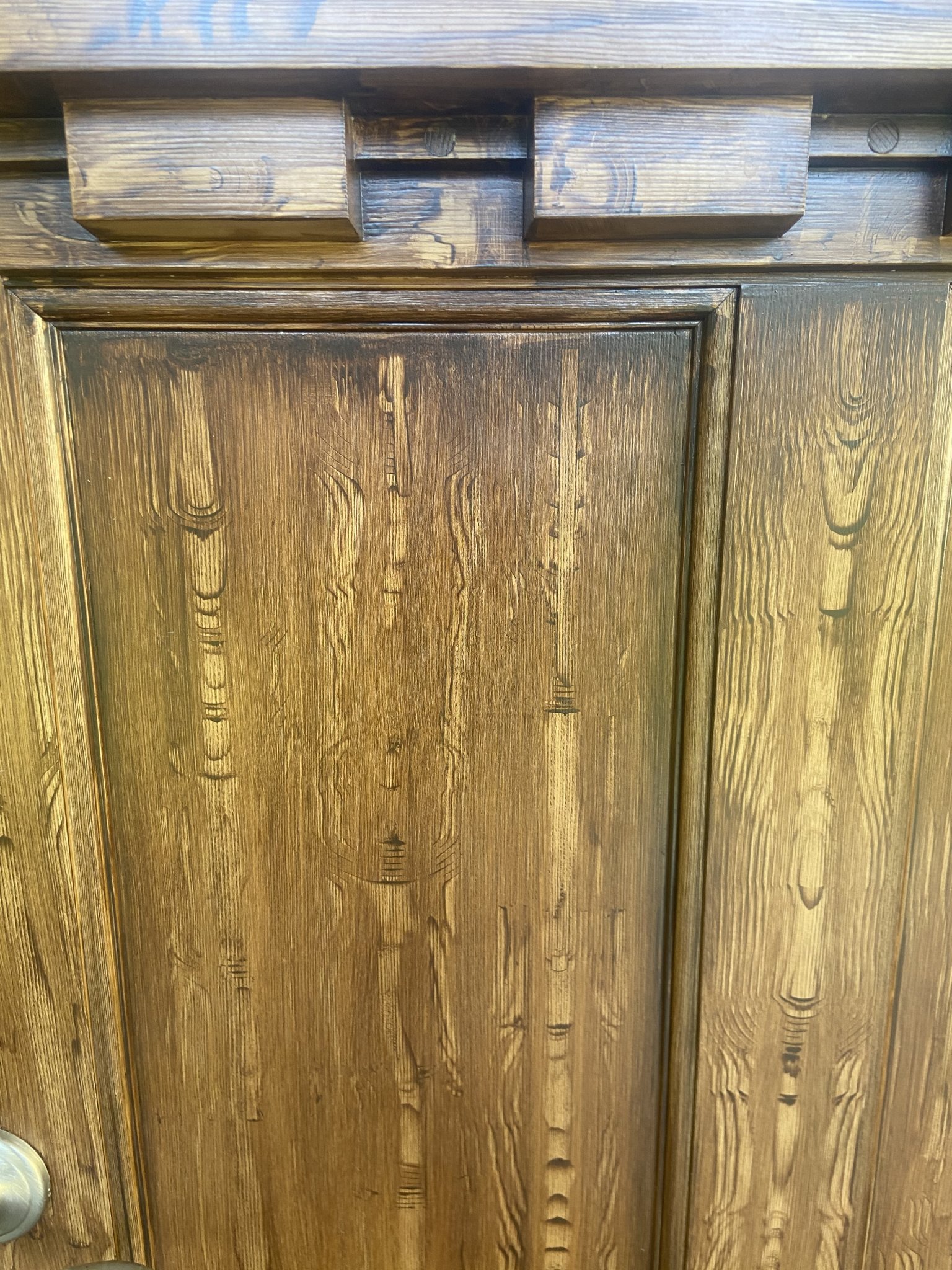

    My wife used to do interior faux finishing: made wood fireplace surrounds look like marble, painted drywall to look like barn-wood, painted a wall so it looked like it had been wall-papered. Ultimately you'll need some speciality glazes and such to "paint" over a common wood stock. Look up faux finishing in YouTube. Also search for woodgraining. Lots of different finish possibilities. People use some of those techniques to reproduce wood-finish car interiors and such.

    The Aquafortis reagent darkens and also pops the naturally occurring grain. If you apply it to clear maple with no curl, you’ll just get darkened maple. The two stocks shown above have natural figure like these maple boards:

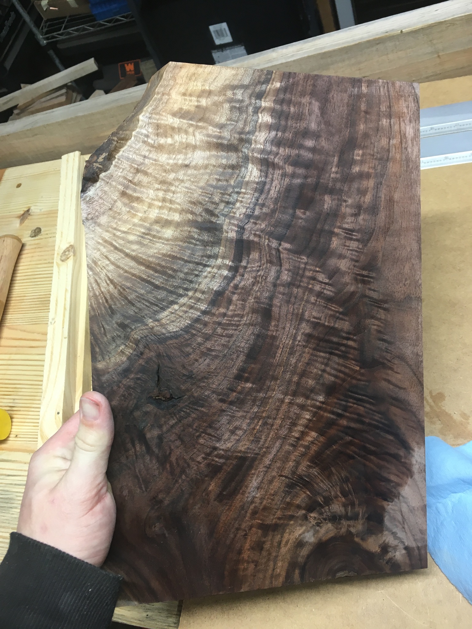

    And this walnut board:

    The Aquafortis reagent darkens and also pops the naturally occurring grain. If you apply it to clear maple with no curl, you’ll just get darkened maple. The two stocks shown above have natural figure like these maple boards:View attachment 7620013
    Burning the surface is just that, burning the surface. It’ll look like a burned surface and never have the depth and chatoyance of figured wood.

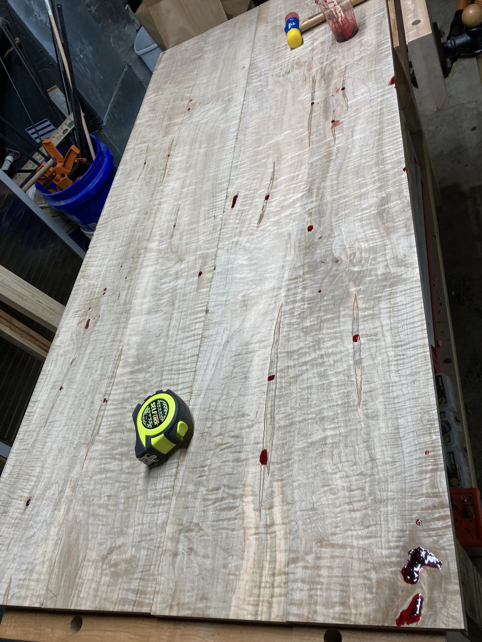

    Whats the red stuff on the maple....some sort of epoxy to fill voids in the wood?
    That walnut looks like a birds iridescent feather.
    Epoxy with red dye. Making a table for a lady who likes rubies. I fill the voids with the ruby red epoxy, and when I’m done planing flat, staining, and finishing it will look like rubies in the table.

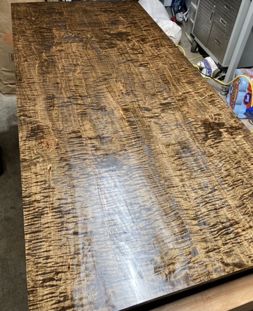

    This is the natural figure of curly maple. Using a 50/50 mix of dark walnut/ golden oak stain makes the figure pop. These are the same boards as shown above, except now they have been stained and the 1st coat of oil finish is applied. The first 4-5 coats are thinned with mineral spirits to penetrate and build IN the wood. The last 2-3 coats will be full strength. This will build a tough, durable, repairable finish that is miles deep and brings out the chatoyance.
