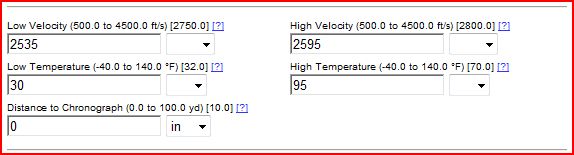

Lindy, how come JBM's elevation values go just slighty up with temperature and every other table I've seen are correctly the opposite?
Re: A comparison of ballistic programs vs actual Dope
Rich:
Without being able to see the complete input screen on whichever of JBM's several calculation programs you're using, I can't make sense of that output.
It's probably an input error of some kind, as I've found JBM to be pretty reliable.
Make sure that you don't have the "Standard Atmosphere at Altitude" box checked.
If you think there is an error, report it.

Dave:
That page is pretty complicated.
That section is used to try to calculate the change in your muzzle velocity with temperature. If you don't have data for that, put in the muzzle velocity you know in both boxes, and put the same temperature in both boxes.
The calculation of the air density at each density altitude step you specify uses the air temperature and pressure of the ICAO Standard Altitude I referenced above.
That's what I concluded. Thanks! By the way, how did you copy that window and get it to display here so well?
