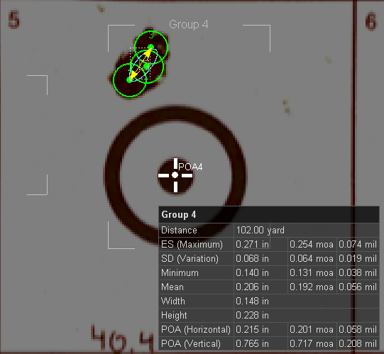

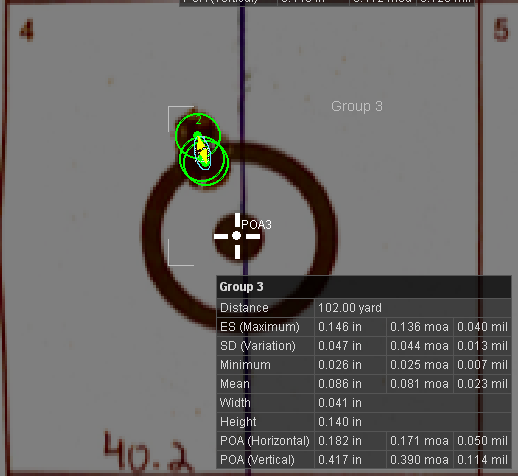

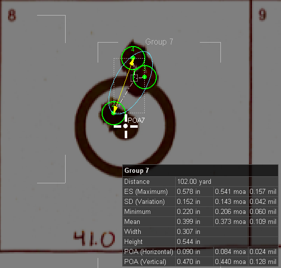

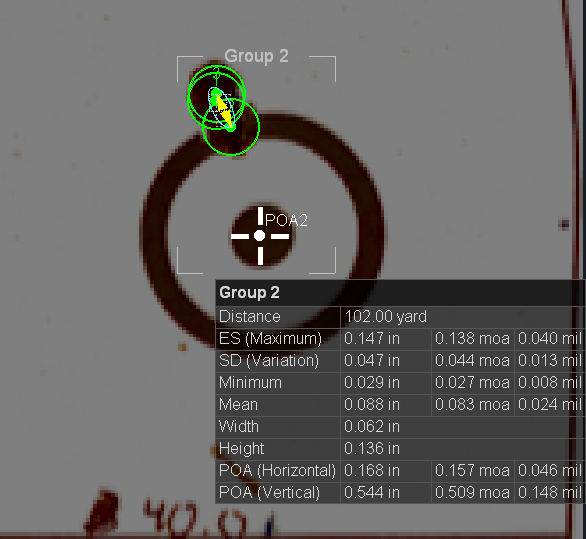

    • Rounds were first shot with OCW method, with one of OnTarget TDS's targets
      • 5 rounds not associated with the test were loaded at the median of the selected charge weights to be used as sighters/clean bore shots
      • 3 rounds would be shot consecutively, then a 5 minute rest would occur to let the barrel cool
      • Shot groups measured via Gordon's Reloading tool

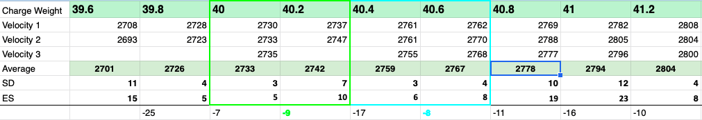

    • Saterlee method shot afterwards
      • Magnetospeed attached after barrel cooled
      • 3 rounds loaded, then quickly fired with a similar 5 minute rest period

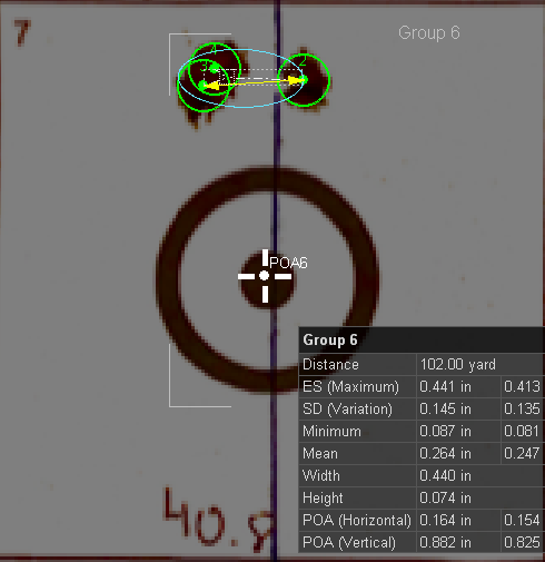

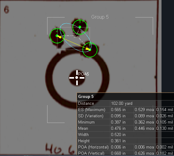

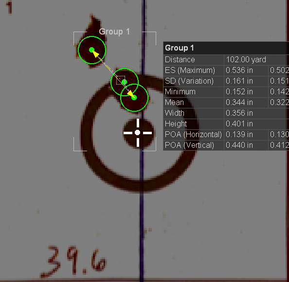

Data

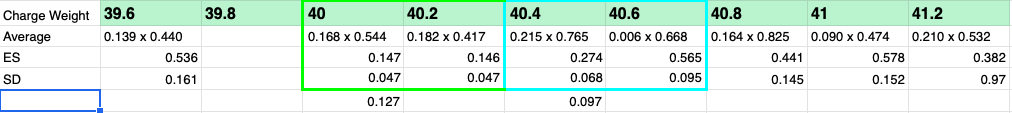

This was the first time I realized I could make a template on google sheets instead of just writing things down, so I apologize for the basic layout of said data.
- It is fairly straightforward, as intended, but I must add that the data at the bottom of both charts was the change from the column/charge weight the value was sitting in to the next column/charge weight.
- The green box denotes what Saterlee's test would consider as a node
- The blue box is what OCW would consider a node
Saterlee modified
OCW modified

Looking at your results it looks like the Satterlee method and the OCW method agree with each other pretty well in this particular gun. Good velocity flat spot around 2730fps between 39.8 and 40.1ish, then wants to jump up to the 2760 range between 40.4 and 40.7gr. POI on the target jumps up when the velocity jumps up, but holds fairly well within each of those charge weight windows. The gun certainly shoots better in the lower charge weight range, so I'd probably pick 39.9-40gr and call it a day.

You loaded 6 rounds per charge weight? It looks like the pics only show 3 rds per charge weight though?
Groups 3 & 4 (40 & 40.2 gr) appear to show the smallest groups as well as the smallest change in velocity/.2gr powder. But you mentioned 40.4 & 40.6 were the OCW "Node"? Can you explain that?

6 rounds total, with 3 rounds used for OCW, and 3 rounds used for Velocity
My bad! I confused the colors, it's been changed!
If you look on the OCW chart/images, the "average" row on the chart is the horizontal and vertical location of the shots in respective to the point of aim. OCW's method focuses solely on consistent point of impact as the deciding factor for a node, not group size.
I chose 40.4 to 40.6 as the node simply because the delta for my my POA/POI, 40.4gr to 40.6gr had a smaller change in the vertical axis, which is what I focused on vertical spread as my priority.
  • Vertical delta for 40.0gr to 40.2gr was 0.127, which 40.4gr to 40.6gr was 0.077.
I should update the chart to have that data, but realistically the delta for the group targets could be affected by me moving the mouse/cursor by a minute amount, so you could tell I was really trying to disprove a link and show superiority over one another only to find it came to the same answer.
