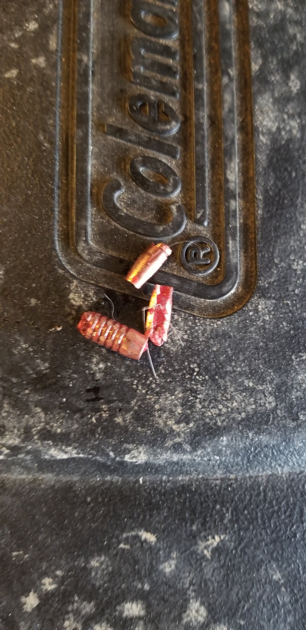

This first one was taken last year. The rifle is a Rem 700 Tac in 300AAC with factory barrel. The projectile was a handloaded Lehigh Defense 176 controlled fracturing (subsonic). Shot was at 40 ish yards, the round entered the neck and did its "fracturing" thing. The 3 petals broke free: 1 was lodged in the spine, 1 ricocheted down into the heart and the 3rd exited the opposite side. The base of the projectile severed the spine completely and was wedged under the skin on the opposite side. This little fella would not stop harrassing our horses. He would repeatedly try to gouge them with his little forks.
