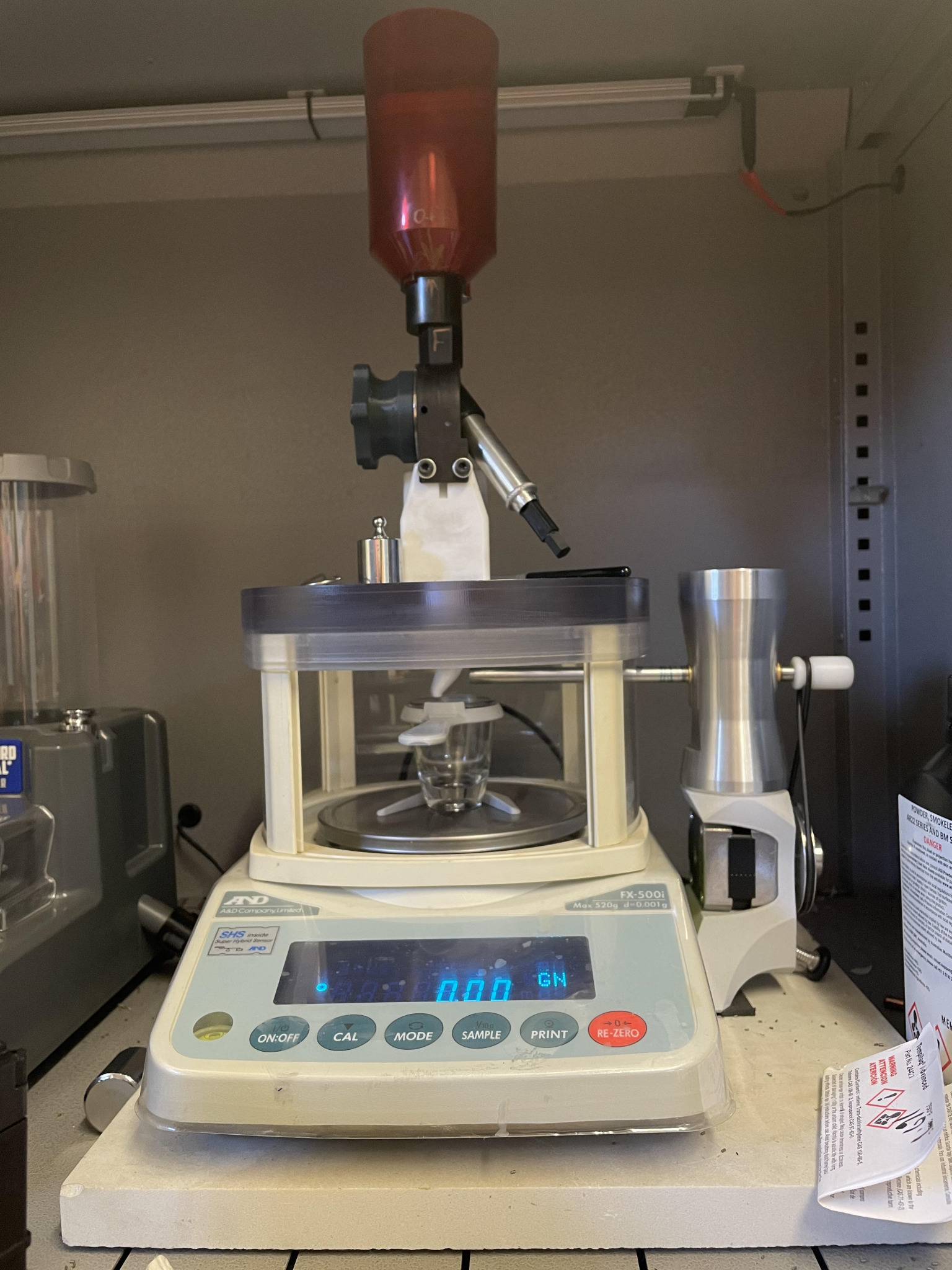

I made a mount for a cheap Lee powder measure so it drops directly into the pan on the scales. It's very quick to throw a few grains under and let it trickle up, I just need to throw it manually once it starts trickling. Saying that, I did just order the autothrow portion as well which will be nice.

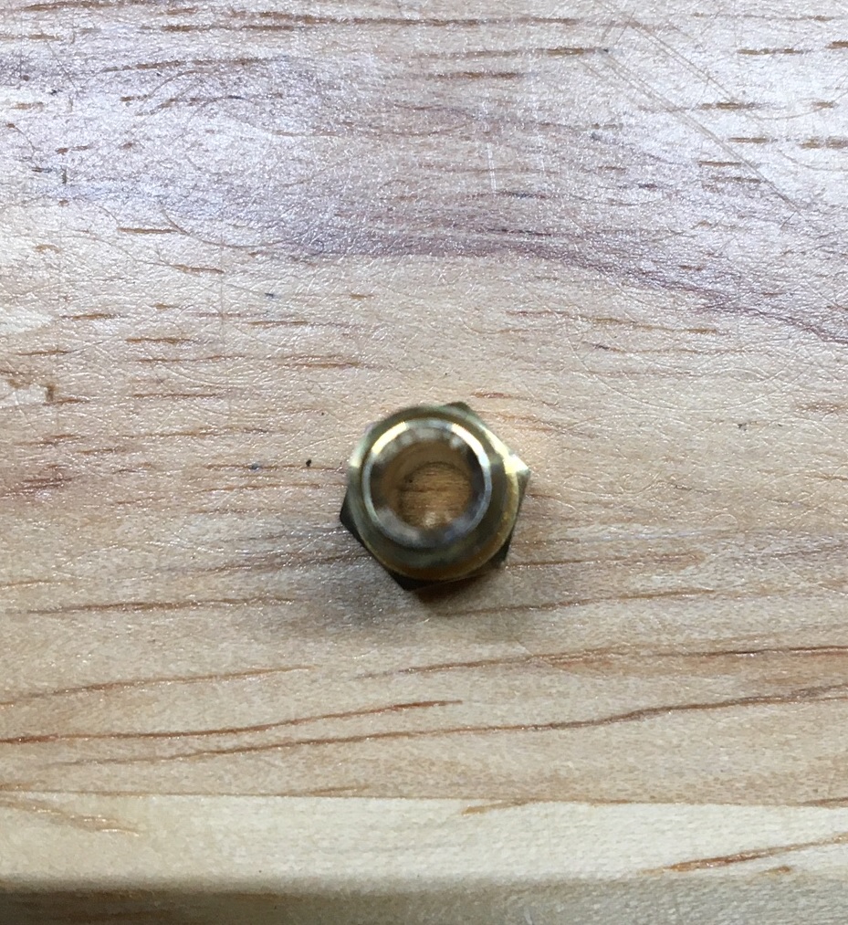

Mine after drilling it out. Sorry no straw pics! :LOL:

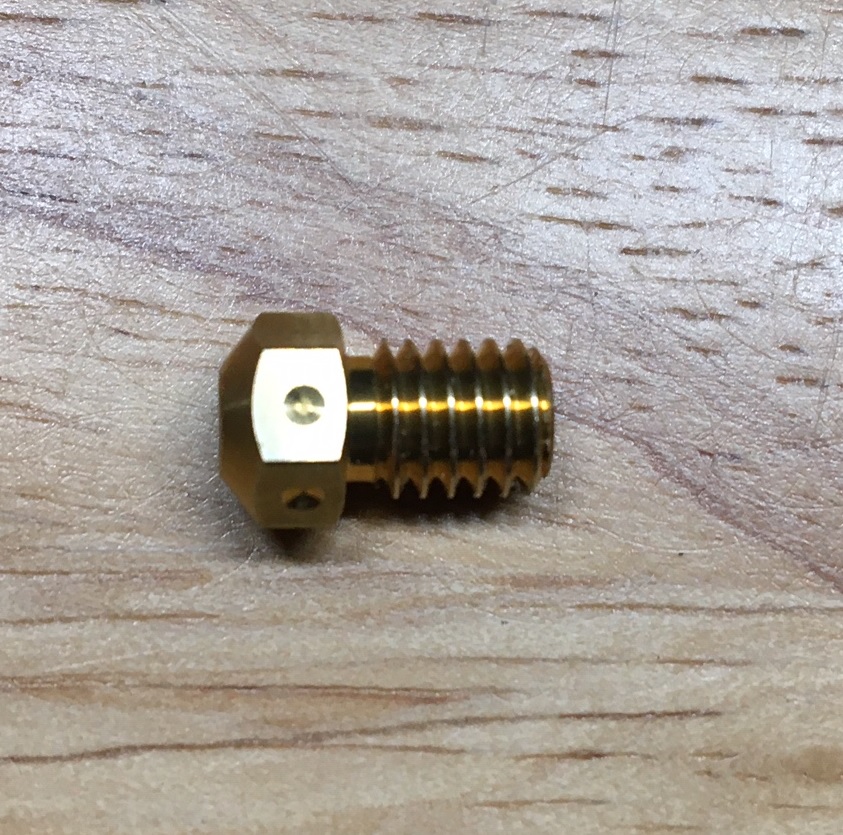

Arrived within 24 hours, and got it installed today. Works well. System is slightly slower but overthrows are far less than before.
@HemiPowrd: Good modification, thanks for posting this!
I can't take credit for this mod. I've seen Elfster and a few others mention it. I was having trouble finding out where to order one and figured out the thread pitch was the same as the 3D printer nozzles. Tons of those available so it's easy to acquire one.
I found mine was slower after adding the restrictor nozzle, but made two adjustments to get the speed back.
1. Changed the angle of the autotrickler straw so it was slightly lower over the cup (more positive angle). This speeds the feed back up slightly.
2. Moved the lever on the back of the scale all the way to the right (as viewed from the front of scale). This lets the trickler feed powder at the faster rate for a slightly longer period so it gets closer to the final programmed weight before it starts to slow down.
You'll have to play around with the above adjustments as they interact with each other, but once you get it right it works really well.
I've also considered drilling out the orifice to a slightly larger size, but with the above adjustments it wasn't needed. With larger extruded powders it might still help speed things up.

Good info. Have already done item 2, and it helped a lot to get some/most of the speed back. Will now try item 1 as well, should help too.
Actually ordered two nozzles (in case i messed up the first one!) and then drilled different size holes: 0.125” and 0.178”. Still running the nozzle with the smaller 1/8’th hole. Currently using RL-17, which has variable kernel size, some are quite long (some fused together) compared to say H4350.
Guess the bigger hole diameter becomes option 3. 😊

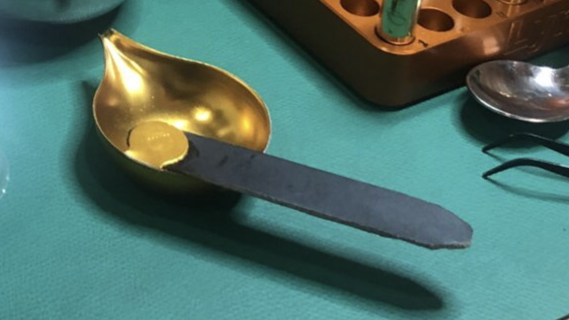

BTW: Did a “drift test” the past 2 weeks: With a plastic cup being used to zero the setup and then writing down the negative weight nr 3x per day. Max deviation i got was 0.04 gn, and that happened only twice in 2 weeks, usually the error is zero (90% of the time, sometimes for days at a time), while only a few days showed a 0.02 gn max error, which is tiny. Left the scale on all the time.
Also modified a yellow beam scale metal pan by adding a long stem made from cardboard attached with Gorilla glue. This pan had 0.12 gn variations while the plastic pan usually had none! It seems the paper-like cardboard material absorbs water vapor and changes weight, and quite a lot too. Glue was applied 6 months ago, so probably not “off-gassing” anymore. That was a surprise.

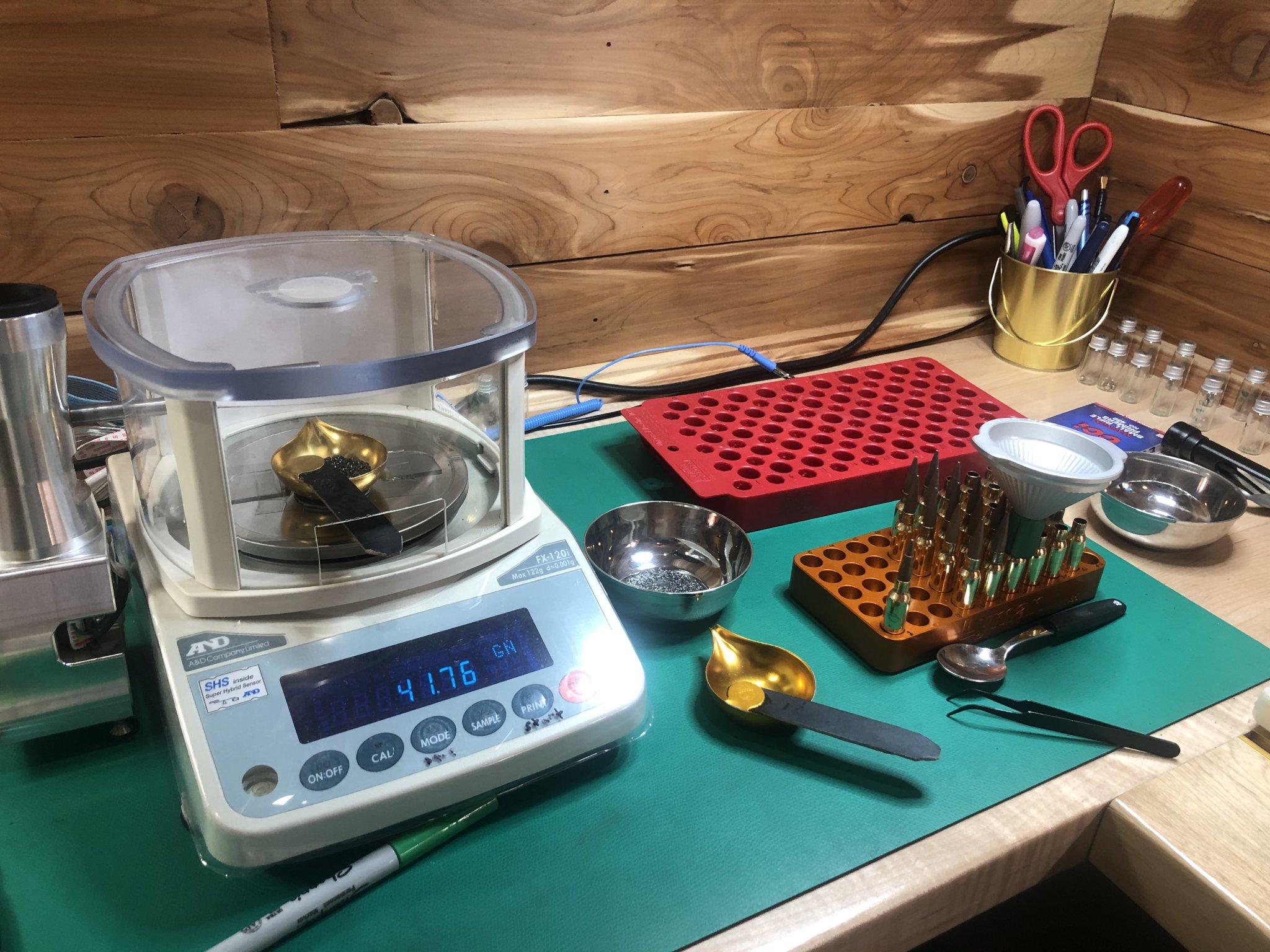

You are correct that the FX120 is a major upgrade compared to any scale with a 0.1 gn resolution. I have a V1 Autotrickler system, and i love it! Will probably at some point upgrade to the V3.
Even though superb, the FX120 does not always deliver 0.02 accuracy over 100 rounds, as it can occasionally drift. This is fairly rare, but it can happen if ambient conditions change. You have to preheat the scale for at least 15 minutes before use or there will be substantial drift. I just keep it on for days at a time.
Also, you can load very good ammo with 0.04 gn resolution, because other factors like neck tension differences, bullet and primer weight variations and progressive barrel fouling dominate once you load to two kernel accuracy. In my experience, 2 kernel accuracy is the point of diminishing returns.
My FX120 scale runs on a high end power filter/surge suppressor, and is sitting on an anti-static mat which is properly earthed to avoid static buildup, no fluorescent lights anywhere.
A stray kernel can accidentally get onto your scale tray and go unnoticed for a while. You really have to keep an eye on the negative number every time you remove the pan. Train yourself to look at it before you dump the powder into the case. Once or twice in a loading session you will see that “something” has happened.
Have run the experiment where i loaded 50 rounds as best i can, tweezer in hand, then carefully put bullets upside down in each case to prevent spillage, waited a few hours, and then weighed them all a second time, being super careful. ES was 0.06 gn (2-3 kernel accuracy) and SD was 0.016 gn. Good but not perfect. [Btw: This testing method is flawed: Ideally we should use a Sartorius GD503 or equivalent scale that has 0.001 gn resolution. Since i don’t own one me did the best me could.]
Yes - by all means get one, it is superb, just learn how to use it well: It is sensitive to drafts, so turn off the AC and close the door. I cut a small rectangular hole in the bottom of the front screen and made it slightly larger than the pan, and cut a round hole in the side screen for the trickler spout. Note: If you remove one of the screens, your measurement error will double to 0.07 gn or more. If you use it with no screens, accuracy is less than 0.1 gn and you have wasted your money. If you don’t believe me, try it both ways. 😊
Also: It needs to be mounted on a stable flat surface, and no milligram scale likes vibration, like a truck passing in the street, or the user bumping the table. A granite slab helps. Just mark the position of the feet on the mat and mark the position of the mat on the table so you can pick up if anything got bumped or moved, and recalibrate the scale.
My SDs came down from 12 fps to 6-9 fps range when switching from a 0.1 scale to a 0.02 scale. But understand that in reality it is closer to a 0.05 gn scale. And neck tension differences have a bigger impact than 2 kernels of powder. [Buying a scale capable of 0.001 gn (1/10’th of a kernel of powder) is overkill IMHO (unless you plan to split kernels with a carpet knife???), but if budget is no constraint, go for it. If you are in the BR game and weight sort your primers, you will appreciate the extra resolution. 😊]

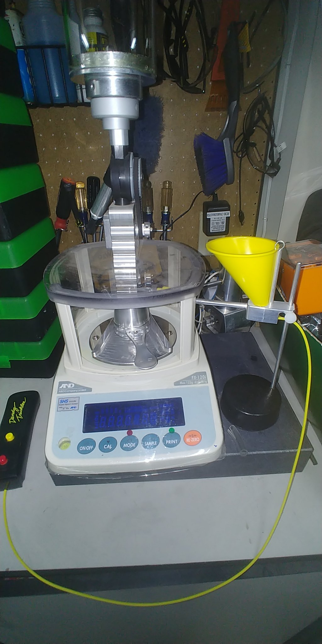

I know this is a old thread but I wanted to thank you for sharing the file. Printed it and used it for the 1st time last nice. Very nice!
Your lid looks different then my stock one. Did you print that as well?
Hope your active and you see this. Thanks again!
