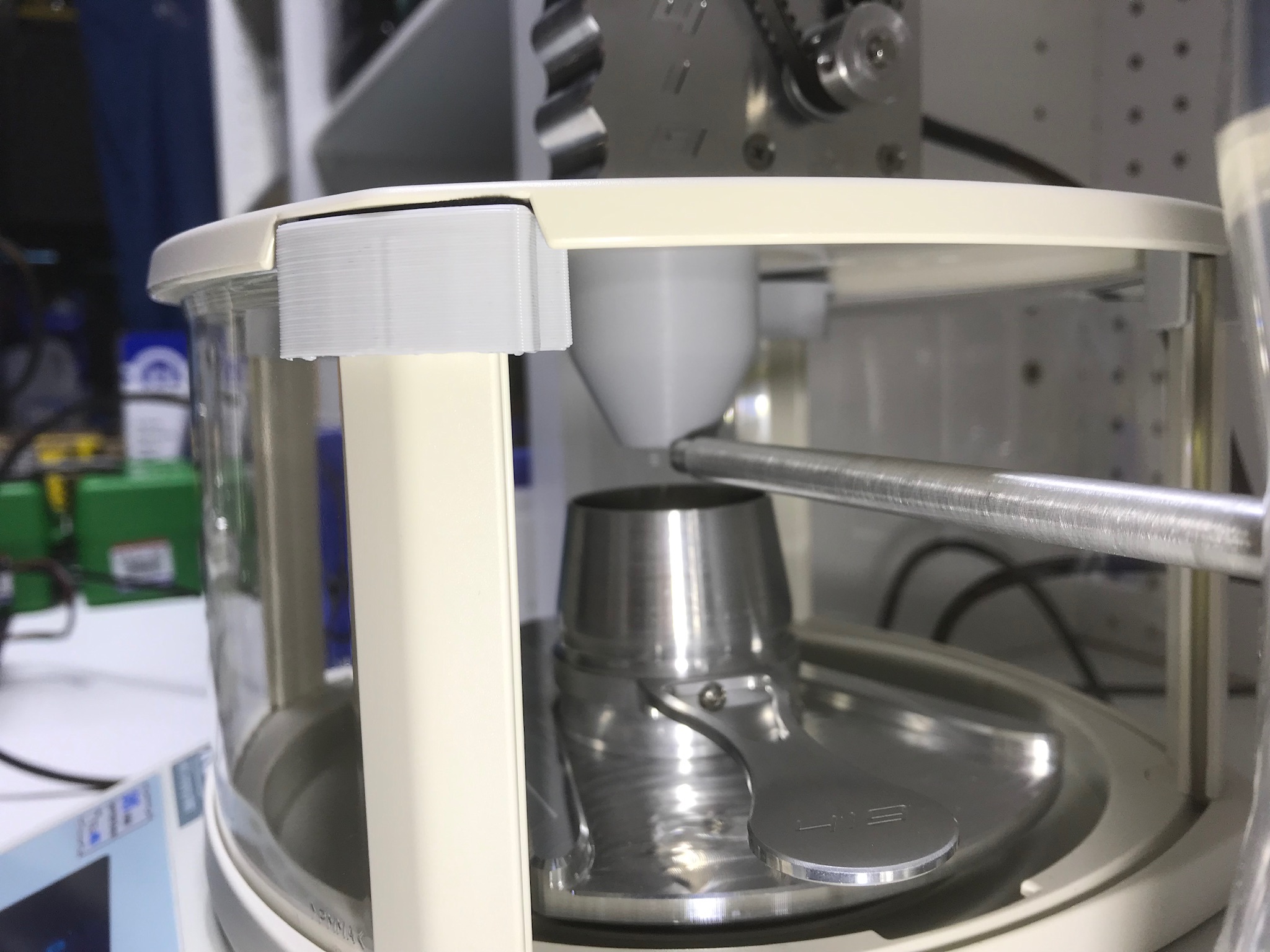

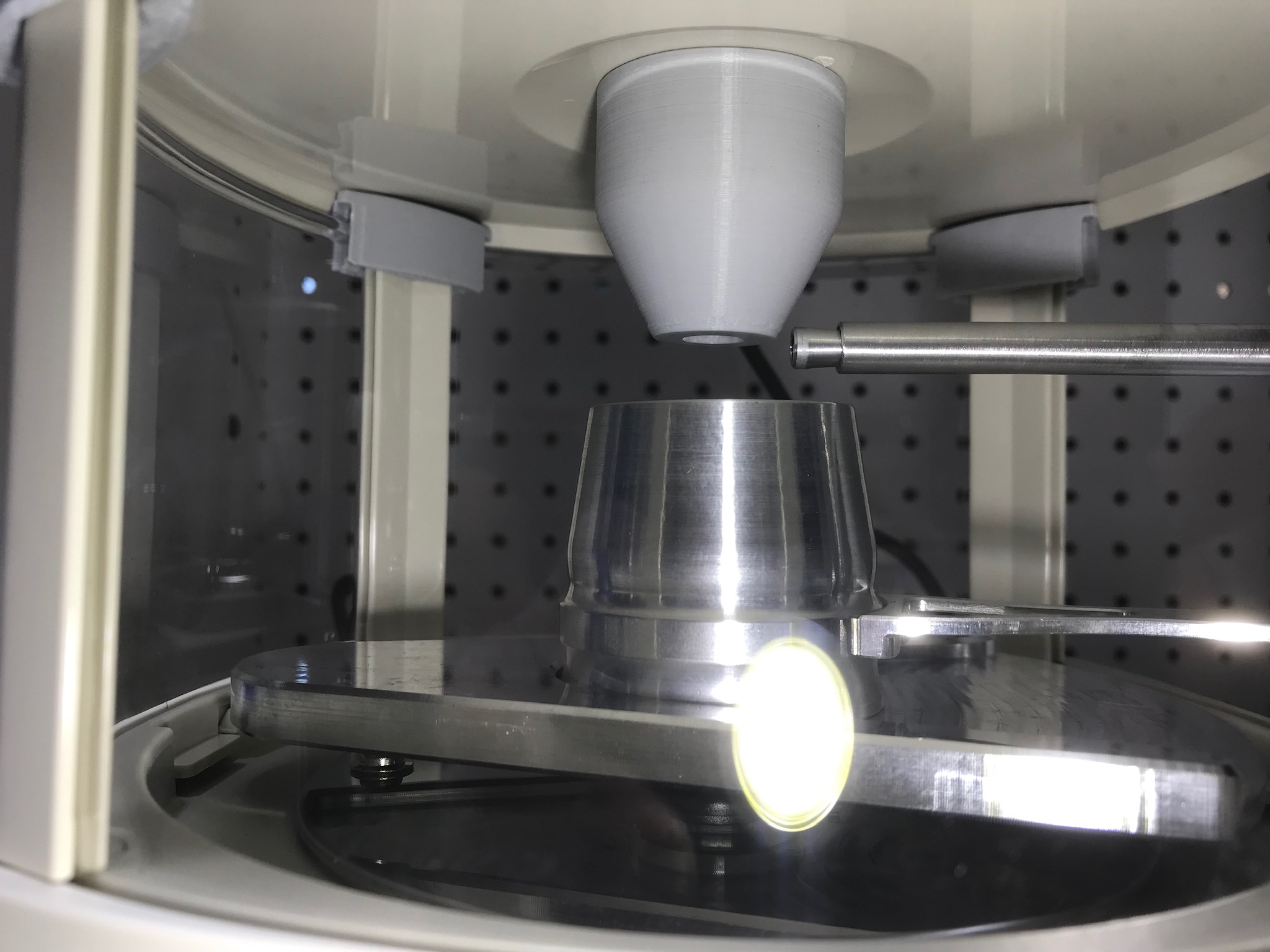

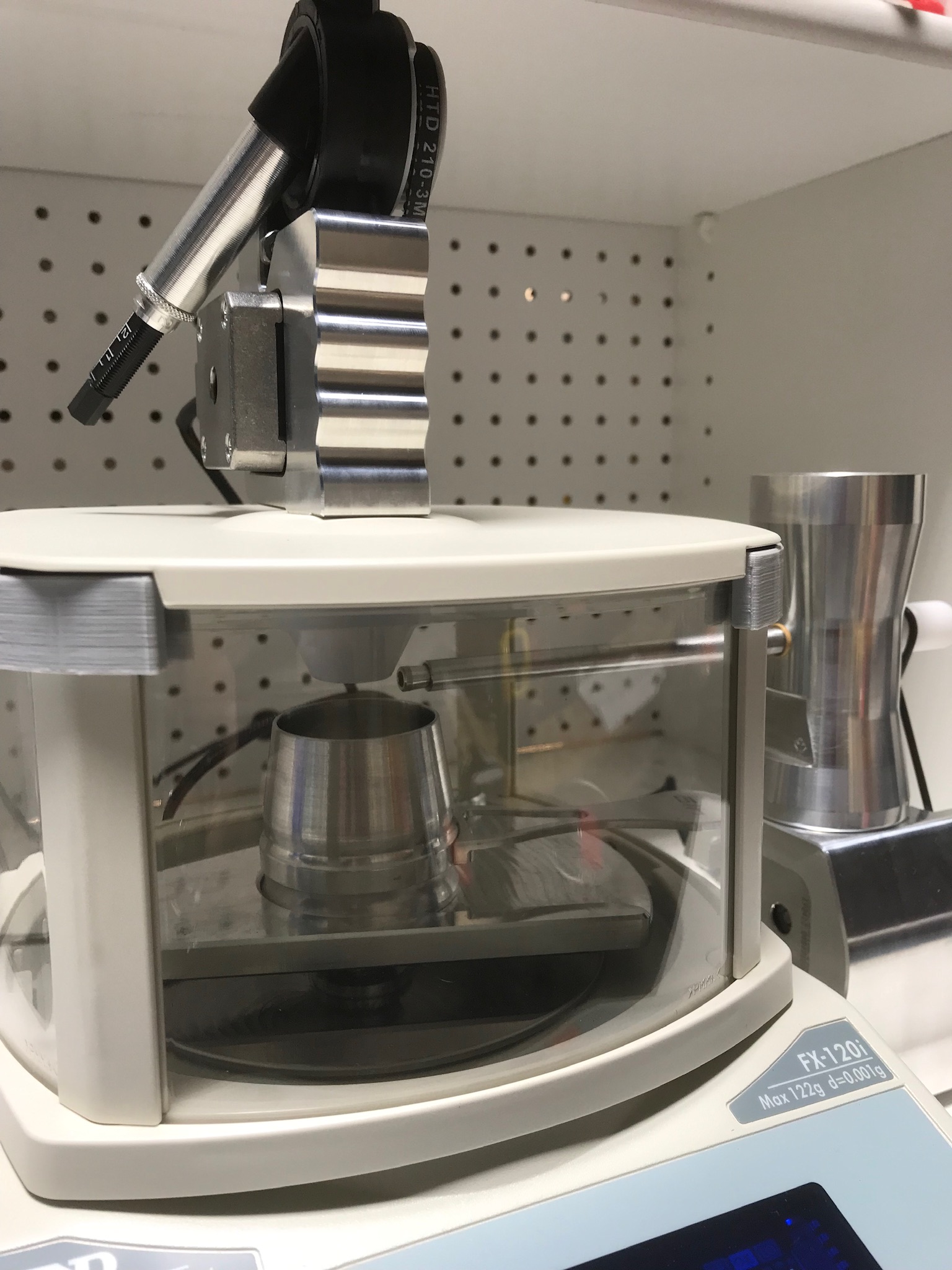

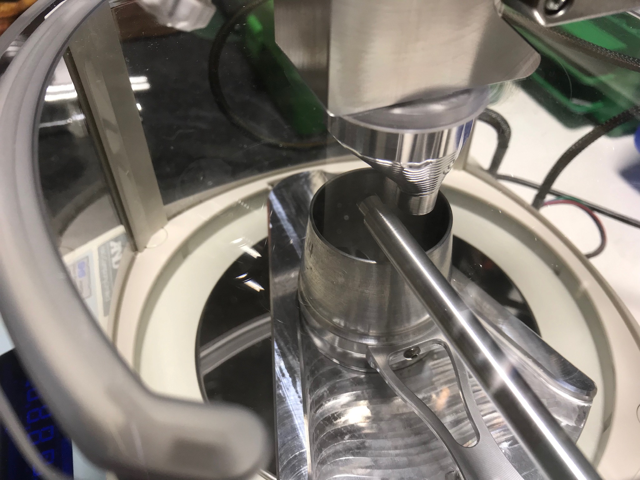

The 419 funnel will work on both the clear 419 top and the factory top with the new V3 powder drop.Is there not enough clearance between the new 3D printed powder funnel and the Area 419 cup/plate? I bought the 419 cup/plate for my V3 setup set to arrive mid august, but if the new funnel wont work I will have to order the 419 funnel.

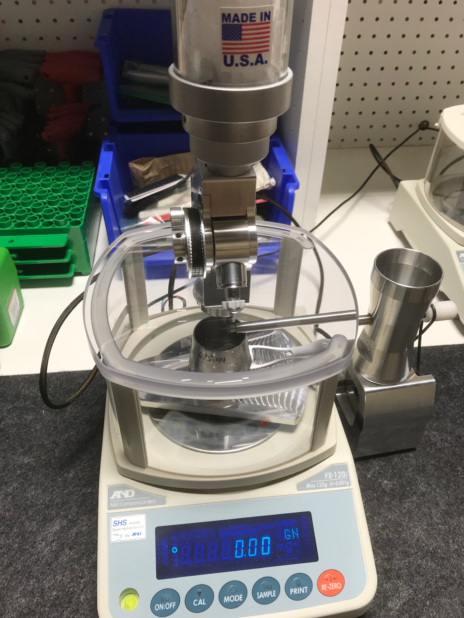

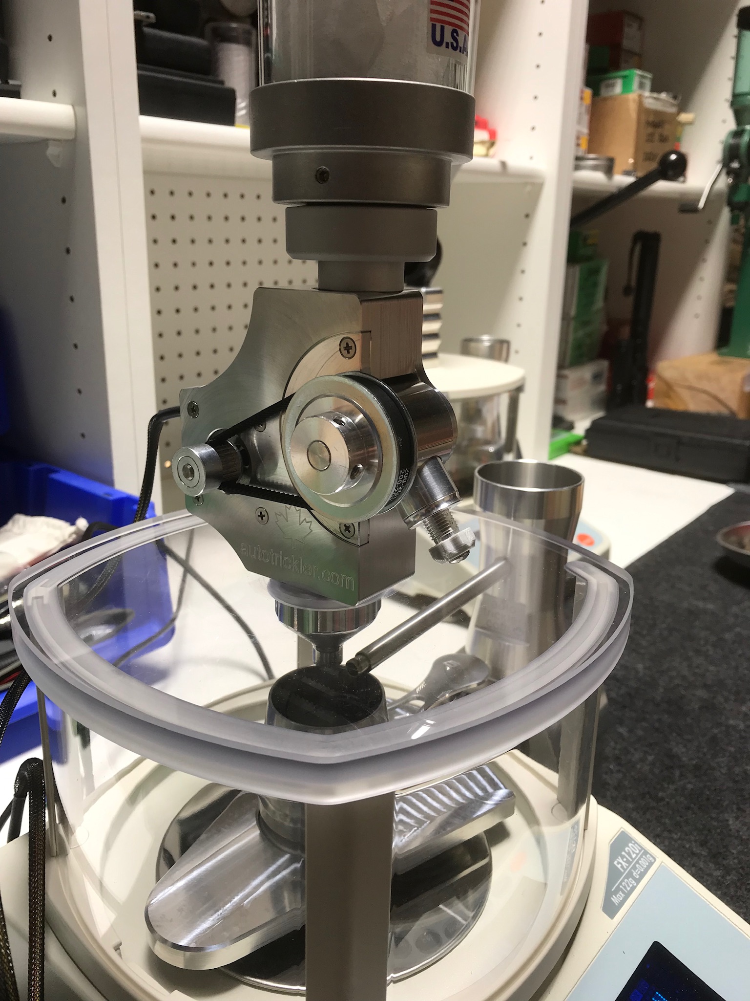

Ok guys everyone loves pictures. Here you go, i mixed up my V2 and V3 to make a great setup. If you notice the pictures, the funnels on the V3 and 419 make a world of difference. The V3 with the powder insert is right up on the funnel. The 419 funnel is offset with room to drop powder, when I first got the V3 setup I was hearing a certain noise coming from the trickler. It was banging on the funnel of the V3 as it as spinning.

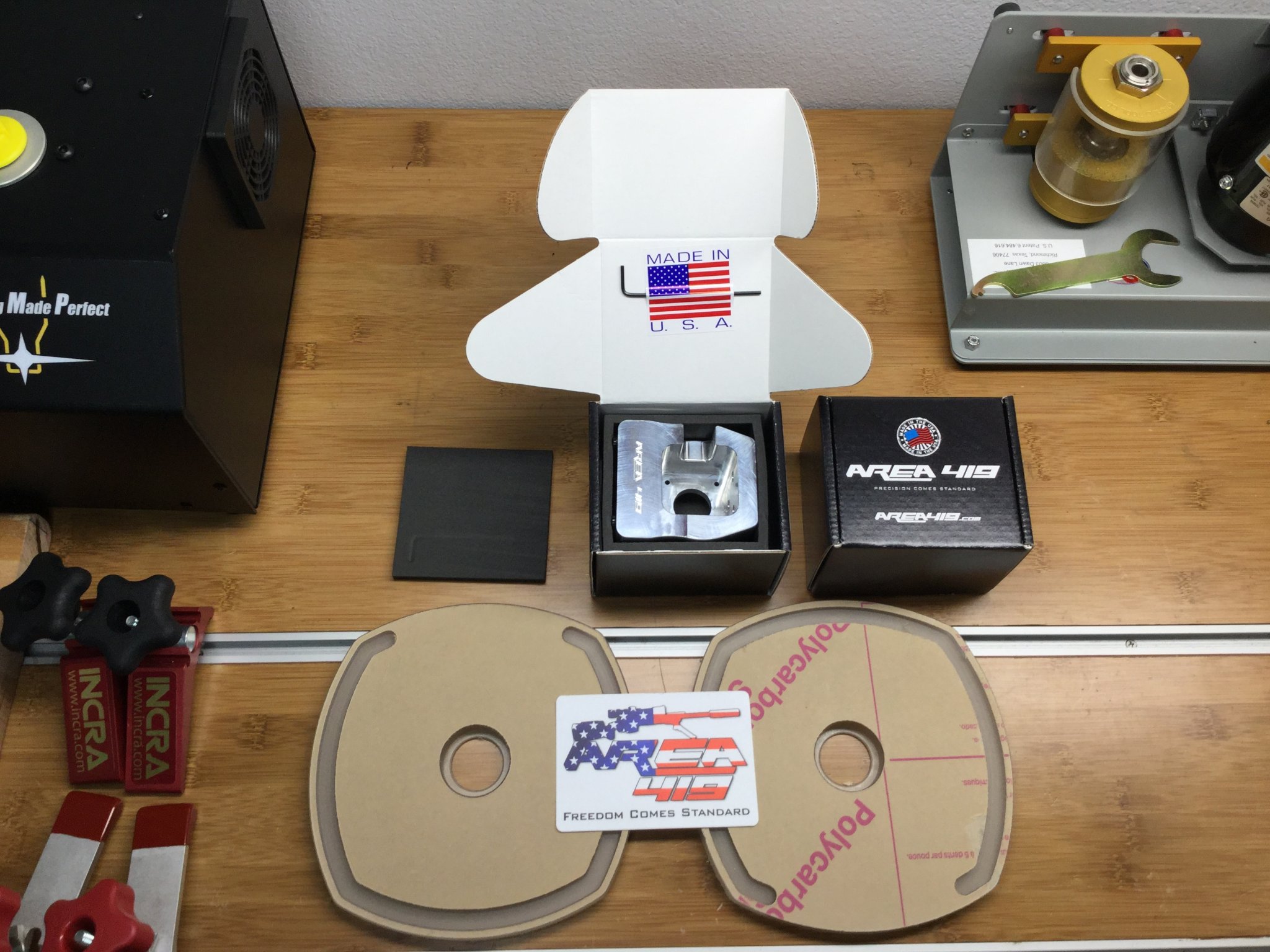

Enough said here is the pictures.
View attachment 7113128View attachment 7113129View attachment 7113130View attachment 7113131View attachment 7113132View attachment 7113133
Is powder cup that comes with the full V3 kit a actual glass cup?Mine does not hit the funnel on full V3 but that is with Adams shot cup.
Thing is slick as hell
Nice!! Seeing pictures from Autotricklers site. That glass powder cup looks pretty sweet. Thanks.. I almost put in order for 2 419 aluminum cups. Now all I need to get is the clear lids from 419.yes. Pretty much a shot glass with the same basic handle, but thicker, as the last one

The funnel fits like a charm, see my posts above.

FYI...I ordered a second powder hopper from 419, and they're dimension-ally like the V3 Hoppers now, not like the V2 ones (fuck, just build a hopper stand for the original, tall and skinny one...looks like I"ll just have to make another one). I guess it makes sense, the pyrodex tube is probably the most expensive piece, and probably sold by linear feet/inches. Shorter/fatter probably means less cost.
