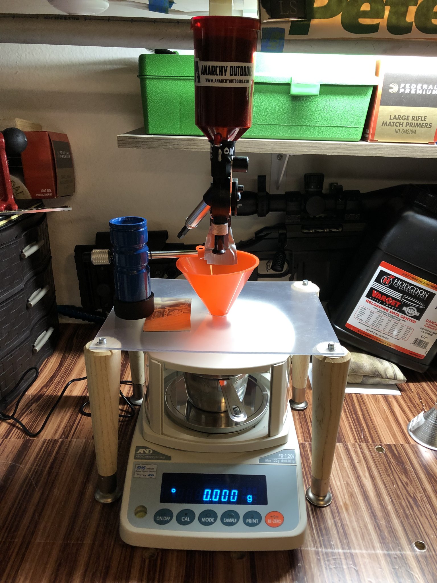

I use a 419 pan because the longer handle makes it easier. I also use a thick piece of kaizen foam to sit the dandy on. I needed something to raise the trickler enough to clear the funnel I put the hole in the top and it might help absorb the vibration (if there is even enough to worry about). I also count kernels as they come out of the trickler.
This is what I’ve been doing since May. I put my order in for the V3 in mid-September so I’m waiting on that now.
I just use an aluminum 1 Cup measuring cup as my powder pan and it works fantastic.
At the bottom of the funnel I did have to make a slight “bend” and then I put a piece of paper over the end....this slows the powder down before falling into the pan. If the powder just drops straight down through the funnel you’ll get quite a bit of splash out....but since I added the bend and the paper I very rarely get splash out
From the time I throw the main charge I usually have a charge within 15-20 seconds measured down to the kernel in Grams mode.

Yes, you need to buy a 100 gram calibration weight. Cambridge Environmental(one of the links listed for scale on Autotrickler website) has them...I’m sure DWS probably does too.
Yes my setup works pretty good, but my top “plate” that the powder thrower and trickler sit on..I should’ve gotten a thicker one. It’s a little flimsy for my liking but I also didn’t care enough to change it either. If I were doing it again or building one for a friend I’d definitely get a thicker plate. I can charge cases pretty fast....but I am looking forward to it being automated.
