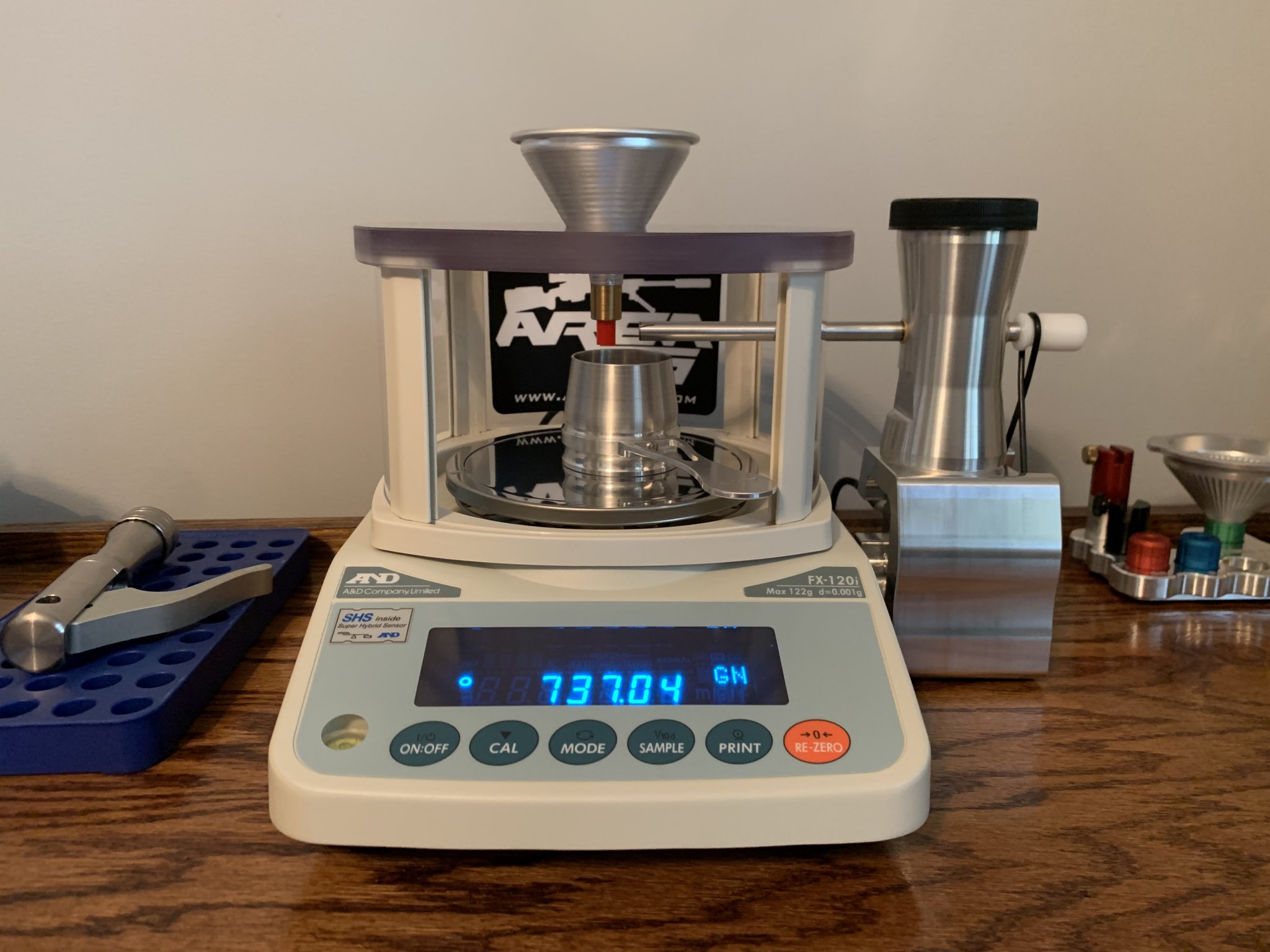

With my Area 419 base, it would cause my scale to jump around a bit. Not a lot...maybe .04-.06gr in either direction. I think it has to do with how the 'nipple' in the bottom was machined, but I'm not exactly sure. It is however consistent and isolated to using the 419 base plate.
I'd have situations where I was loading up for a match, and half way through all my rounds, I'd take the 419 cup off the pan and instead of being -750.72, it would show -750.78 etc. I'd re-zero and go on with loading, and it'd do it again in another ~10ish rounds. I went nuts troubleshooting this issue (how I got the line conditioner, ferrite magnets, eliminated flouros), until I read on another forum where someone had a similar problem.
When I use the A&D 'platter' the problem goes away entirely. Mine is rock solid now and doesn't move zero at all, even after being on for 4-5 days since I last charged with it.
Edit: I've been using the A&D plate for a while now, and honestly don't have any issues with it, and slightly prefer it to the 419 base. When I ordered my scale, I got the full 419 package; knowing what I know now, I probably wouldn't have done that. I'd of just purchased some of their upgrades individually.

I shit canned the basic lid not long after getting mine. The heavy 419 lexan(?) lid made things a whole lot easier to see and stopped all the flexing when the thrower motor actuated.

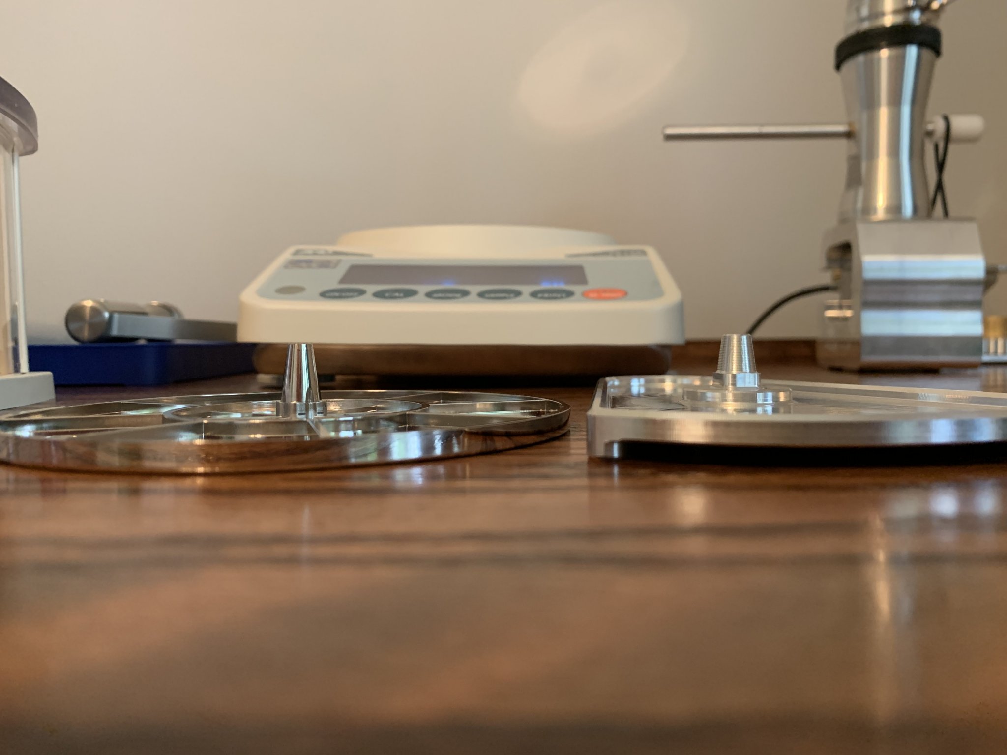

Same here on the 419 pan. Even had them swap it for another, and it too causes drift.
The original pan is definitely more stable, but the 419 is so much easier to center so I accept it.
Hopefully someone figures out a trick to fix it.
I posted this same issue with my area 419 pan drifting on another thread and everyone thought i was nuts, or didn't let if warm up long enough, or I needed to calibrate it, blah blah. I've since starting using the pan that came with the scale and have not had any more issues at all.
Yeah, I'm wondering if, because the pan can shift to one side or the other by a small amount, if it is affecting the reading because of torque against the displacement sensor...
These are hypersentitive scales, so it wouldn't surprise me if that was the case.

I have all the 419 stuff too. What I found, the drifting is caused by static in the thick lid and side panels. I wipe the lid and plastic side panels down with a window cleaner during set up and it does not do this anymore. I will also spray the work are with static guard during set up. I have found over the years that static is the #1 issue for any electronic scale. I also check every 5-10 rounds by just pulling the pan off and making sure it is zeroing.

I just checked mine, it does have a slight shift in it.....hmmmmm
Reactions: MarinePMI
Well, if I get bored after my surgery, I may very well bolt the plate down to the mil table and take some off and see if the resolves the issue....

I only have the factory tray and it does rock/shift a smidge depending on which side the cup is set on... but I cant get it to read incorrectly. Ive moved it all around, Ive tested with different weights in diferent locations and different cups too etc. If there is something on the tray it reads the same for me regardless of its position on the tray. Used to bug me but Ive tested it enough to realize that its not hurting anything for me. Never had an issue getting the cup under the straw either that would drive me to look for an alternative.
Reactions: John Glidewell
I really didn't want to believe this, but I'm having the same issue. Going back to the factory tray definitely seems to work better.
I can't explain it, I'm sure someone smarter than me will figure it out. Btw, if you have Adams 3D printed centering device, you can
use it on the factory tray to center the 419 cup.

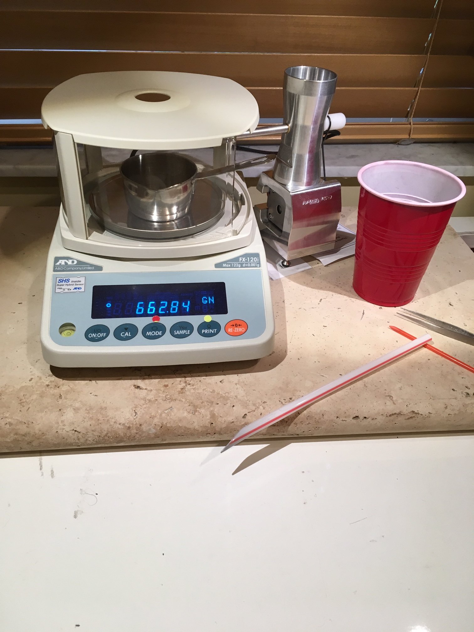

@Ranger188 The one thing that has not been mentioned. I suggest to get a heavy piece of Kitchen granite slab as a base. Kitchen manufacturer usually throws them away (the hole where the kitchen sink goes). I am using a pool coping. The older original version trickler base used to jump around. Also notes that I use paper to balance the trickler angle while others use the base screws.

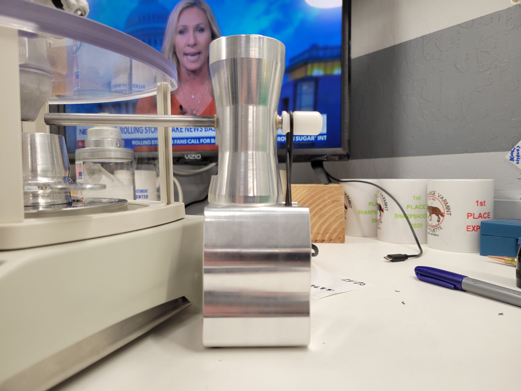

Bringing this thread back up for some help....
I bought a V3 with 419 kit from a guy on here and it's been great with the exception of a significant amount of over trickling. I have the trickler set all the way down so that it has as little slope as possible and it still overshoots fairly often. I am using staball powder btw.
Is there a device like what I bought for my chargmaster that will help this or some setting I can adjust? I have the + / - setting on the back down as low as it will go as well.
Thanks, this really has me frustrated.
Yeah, all the chargemaster inserts places also have an autothrow version that ive seen.
Speed it up and slant it down maybe?
Shine a light on it while its final trickling and see if its clumping up and coming out in surges but thats usually an issue with stick powders, not ball. If its an even flow and its just going too slow, you have the scale speed sensitivity to high correct?

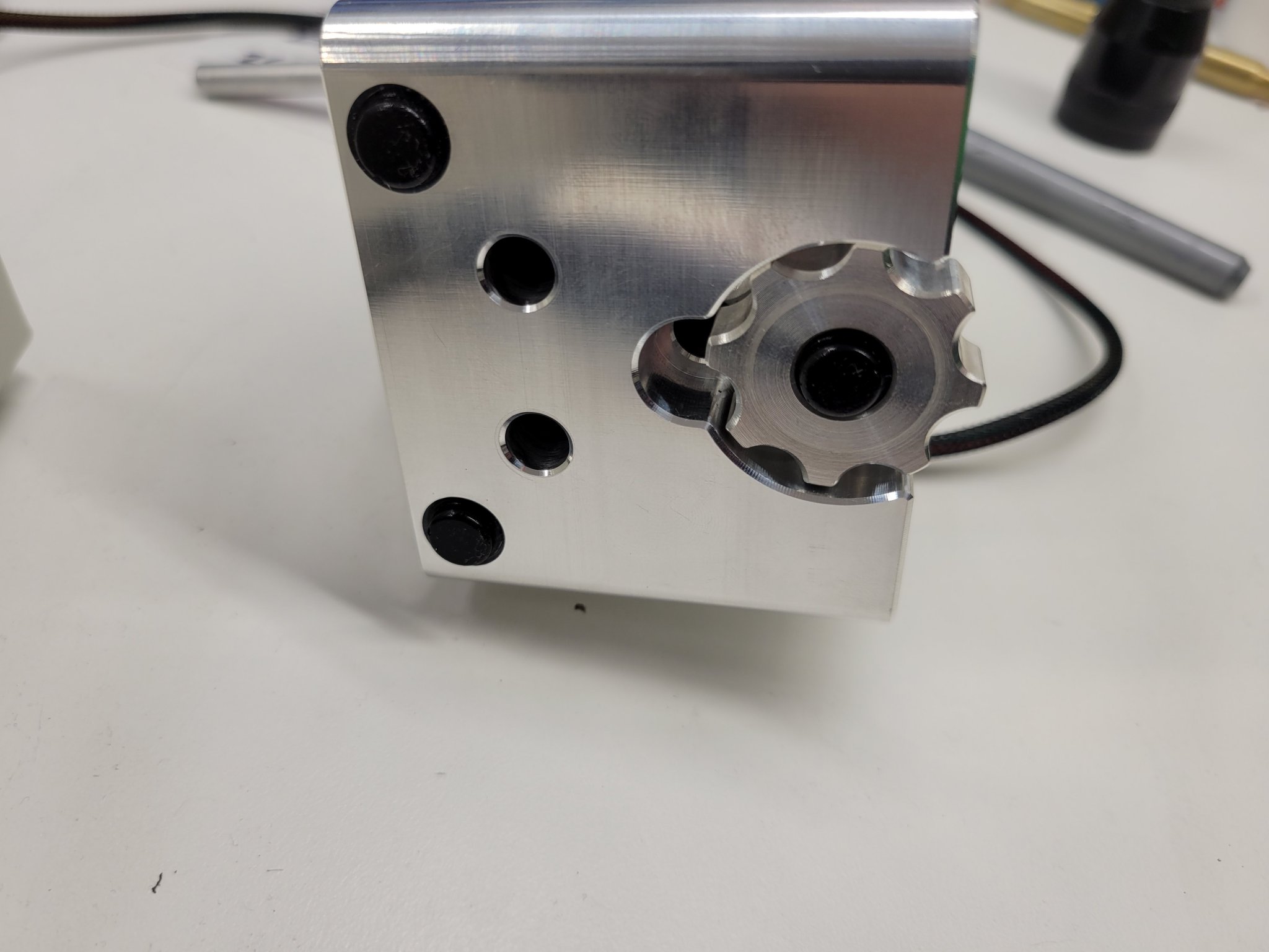

Yeah I think so. I went through and did all the settings it said to do in the little booklet. It seems like it just doesn't slow down quite fast enough.
I tried making it slope more but didn't get anywhere with it. I didn't go very far down that road but it didn't seem like that was going to work.
You definitely need a couple of degrees of slope in your trickler. Mine almost never over throws, if any thing it usually just under.
I've got a little slope because it won't adjust enough to make it level. Mine will be anywhere from .02 under to .1 over, then about half the time its right

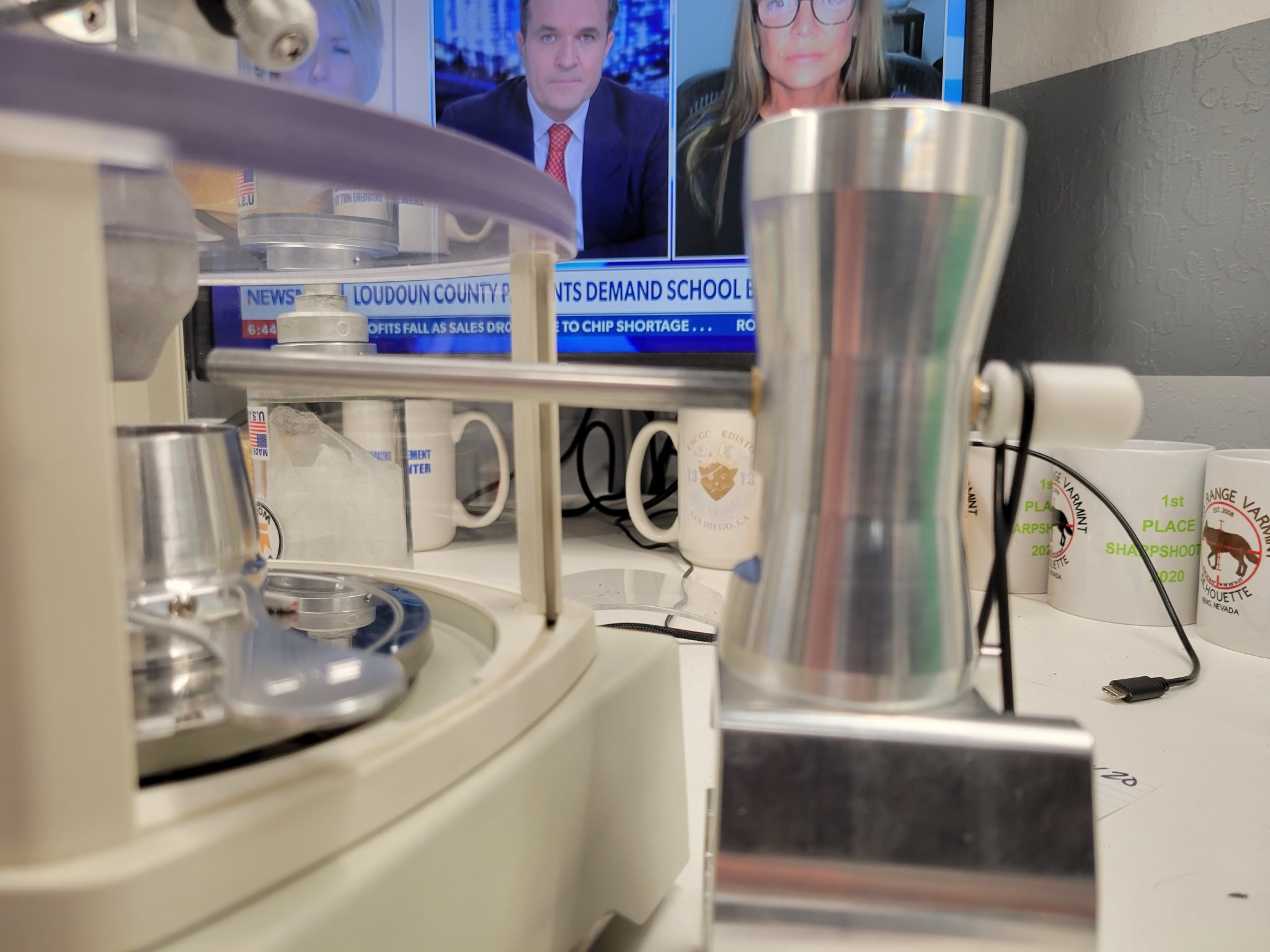

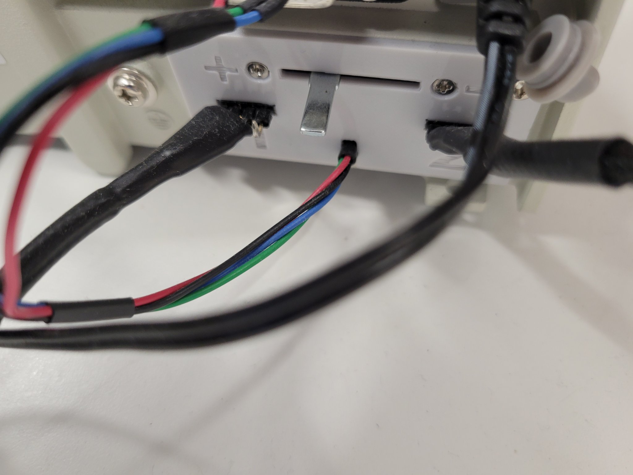

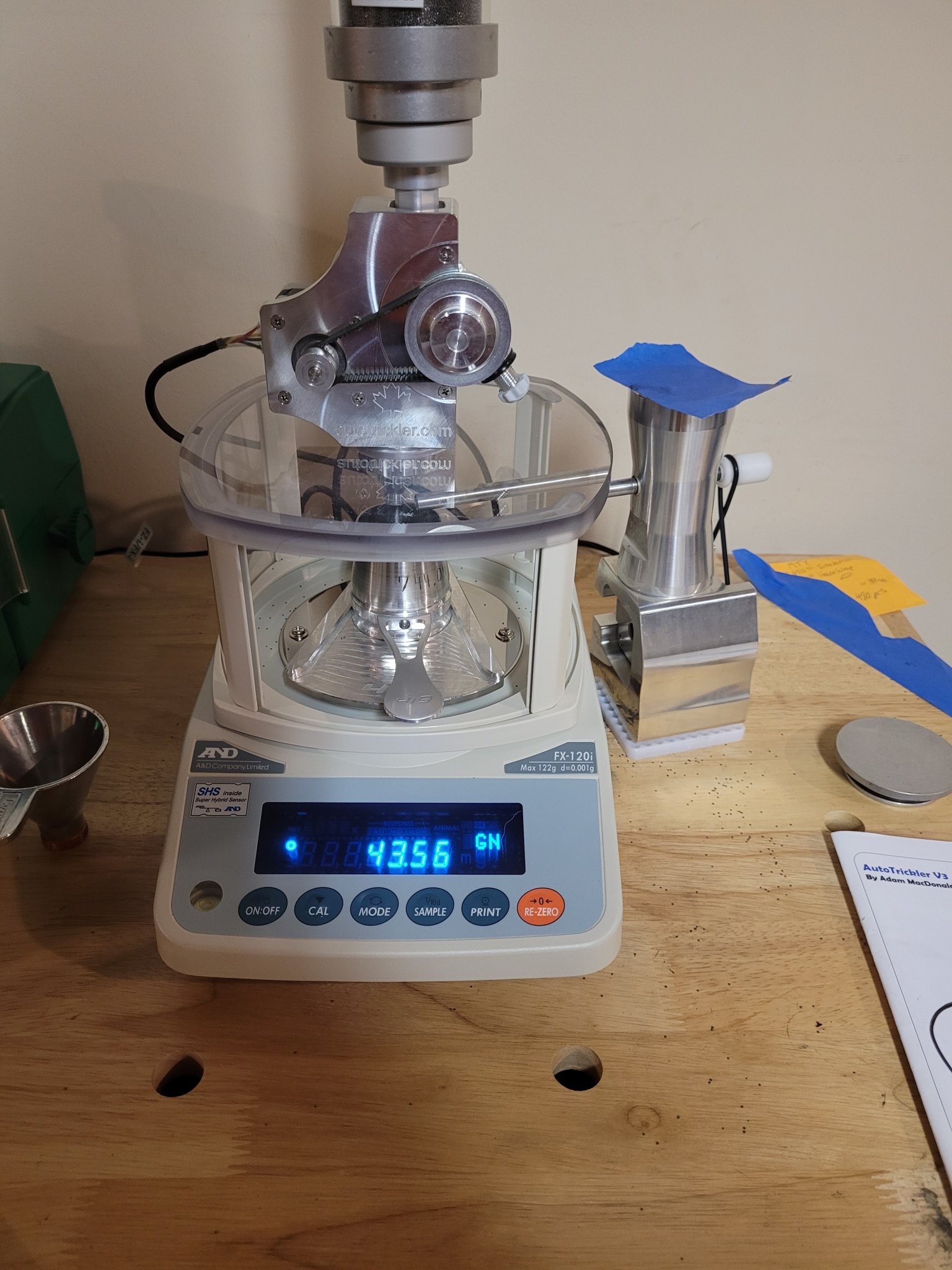

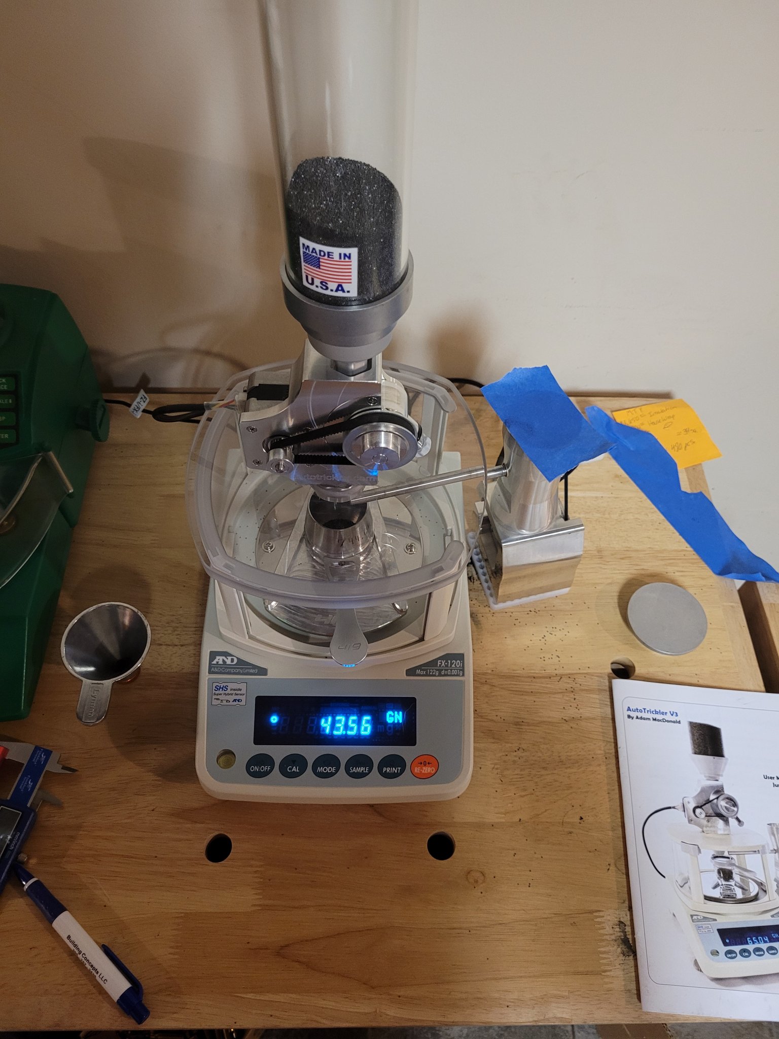

Pics and or video, including the back panel so we can see settings. Sounds like it is not set up properly.
Ok. Will do here in just a bit.
Thank you everyone for the help!!! I need some help here.
Everything I've seen about these V3 systems says that it should pretty much be throwing perfect charges over and over again with an occasional. 02 gr variance. Is that a correct expectation?
I can't get the video to load. Tired a few times and it took a long time to load up,, then when it got to 100% it gave me an error meazage.....
Here's some pics though.
Set to 43.5gr

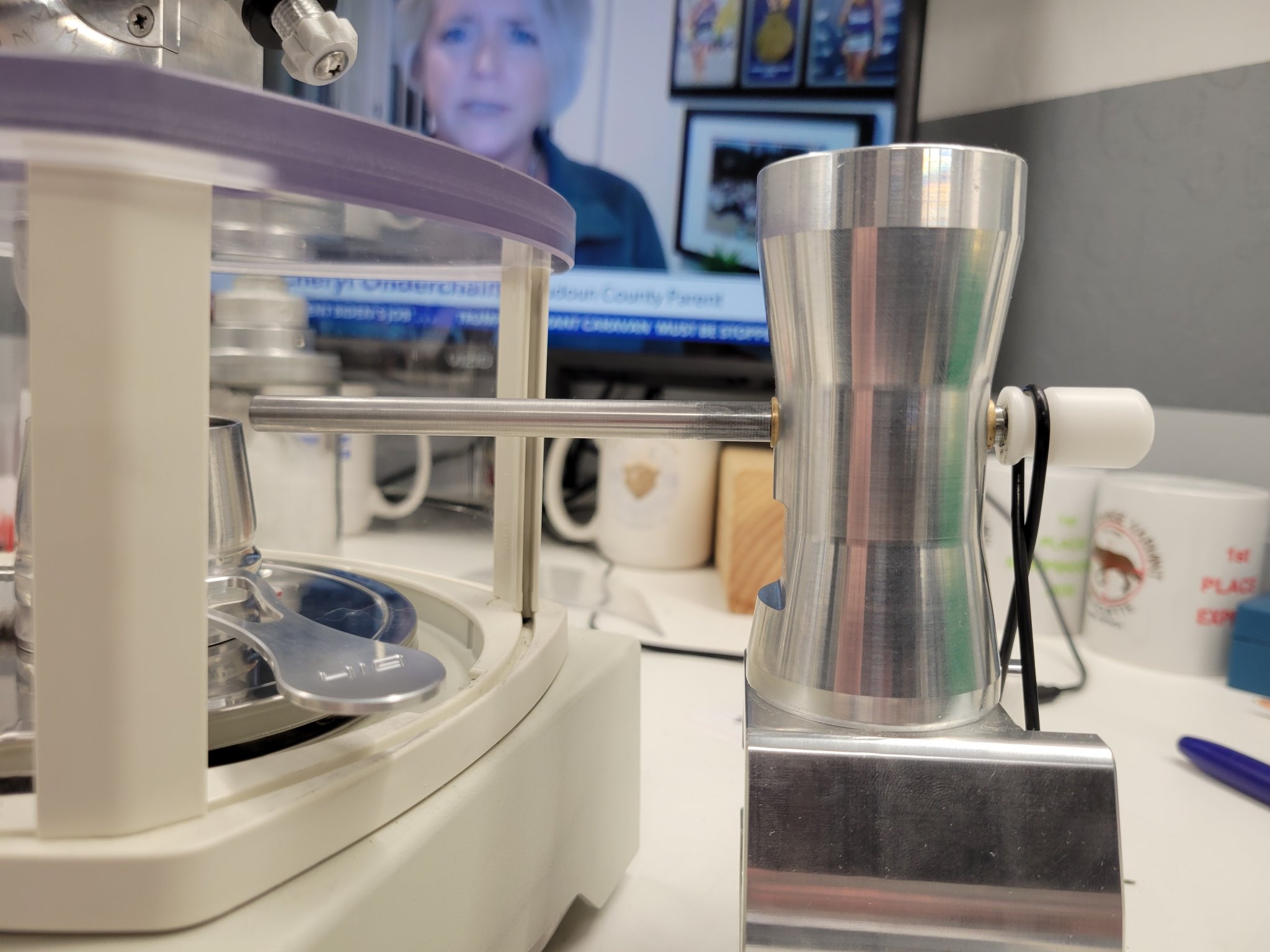

Can't really see anything there. Why is the trickler sitting on that? Here are some pics of mine. Little towards the + side and trickler tube slightly elevated.
View attachment 7729877View attachment 7729878
I just had the trickler on that plastic primer tray to get it up a little higher. It was hitting the cup just barely just sitting on the table. I have now replaced that with a ceramic coaster. It doesn't have any vibration or anything.
I can't adjust it any more towards level than it is and giving it more slope makes it worse.
