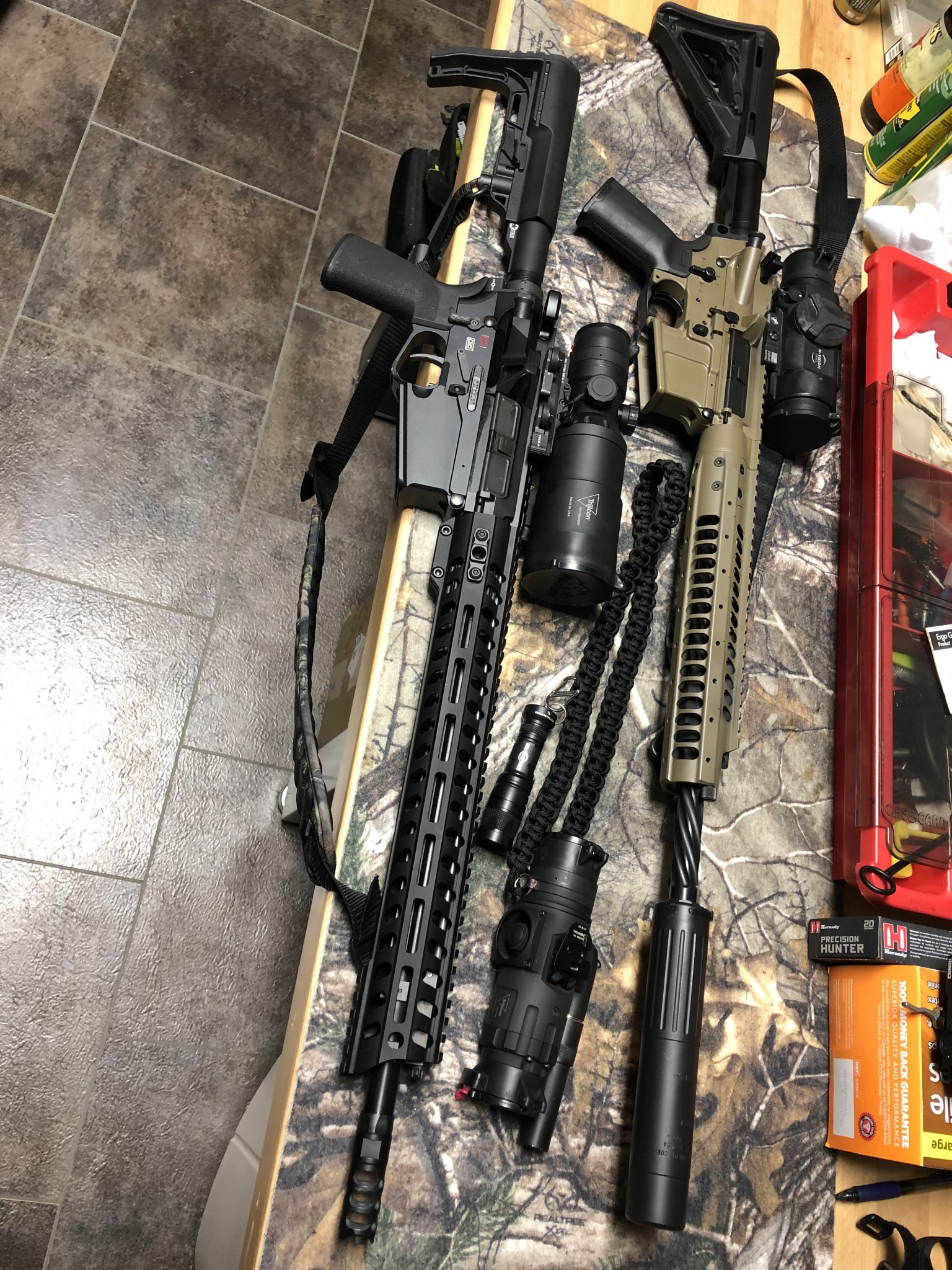

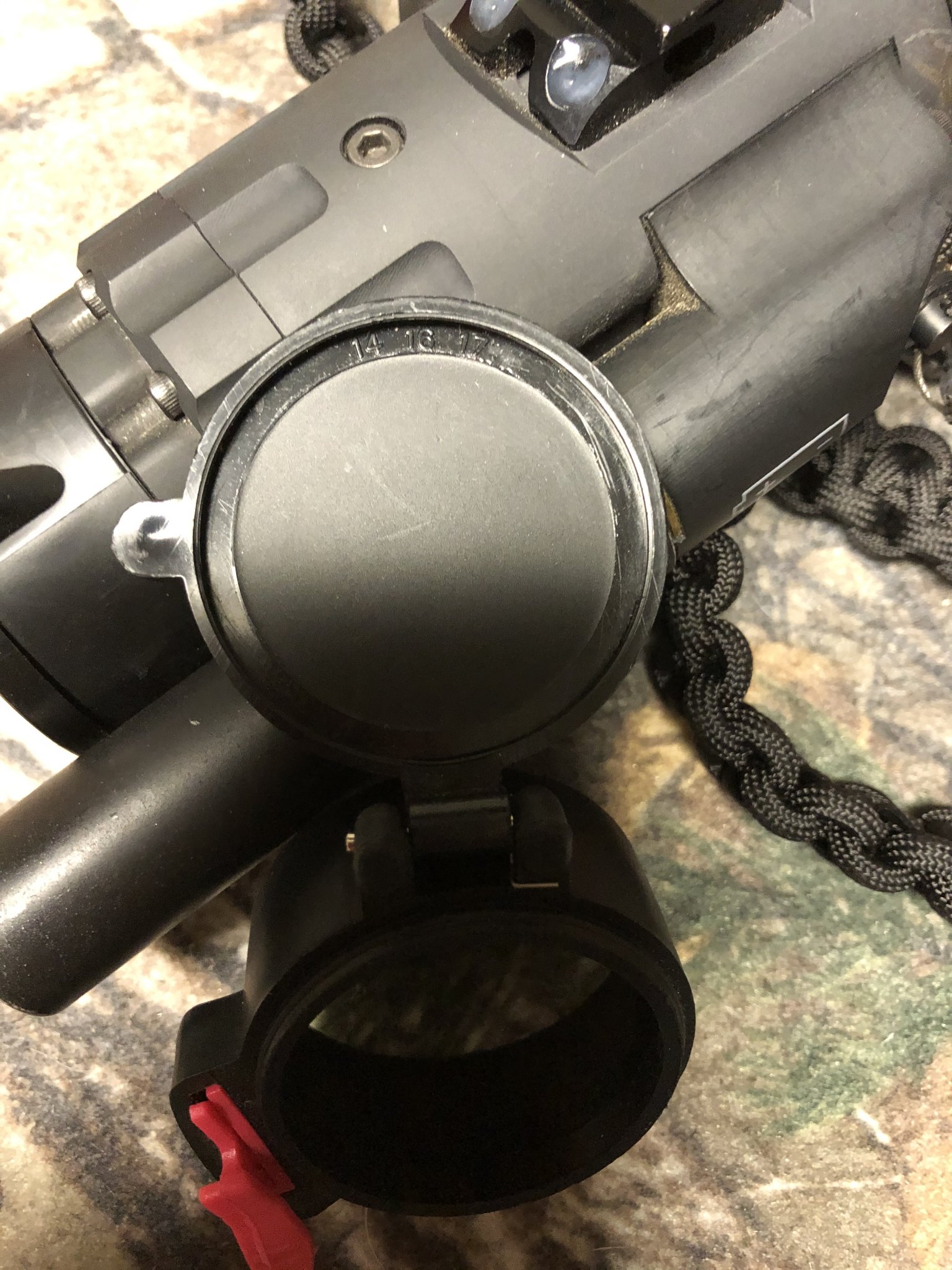

Finally got around to sharing a picture of my gear. Recently put the Halo 25 on the LWRC and moved the Hunter 60 over to the new POF Revolution. The Reap has the base taken off so it lays flat against my chest. I have the reticle turned off and run it 30 HZ to get as much run time as possible with the IRX rechargeable kit. I have one of those little Surefire IR/white lights I keep tethered to my neck strap. When I am walking in the woods with the PVS-14 in areas with thicker vegetation I have found the helmet IR causes too much back splash. Having it on the neck strap I can direct the beam where I want it to go. I just make sure when I am wearing it that the light is positioned where it cannot touch the Reap and I have to be extra cautious when I take the strap off not to let the light swing or drop and hit the Reap lens. Closing the Butler Creek flip cap helps with that too.
Which butler creek is that on the Ocular of the Reap? Sweet setup
