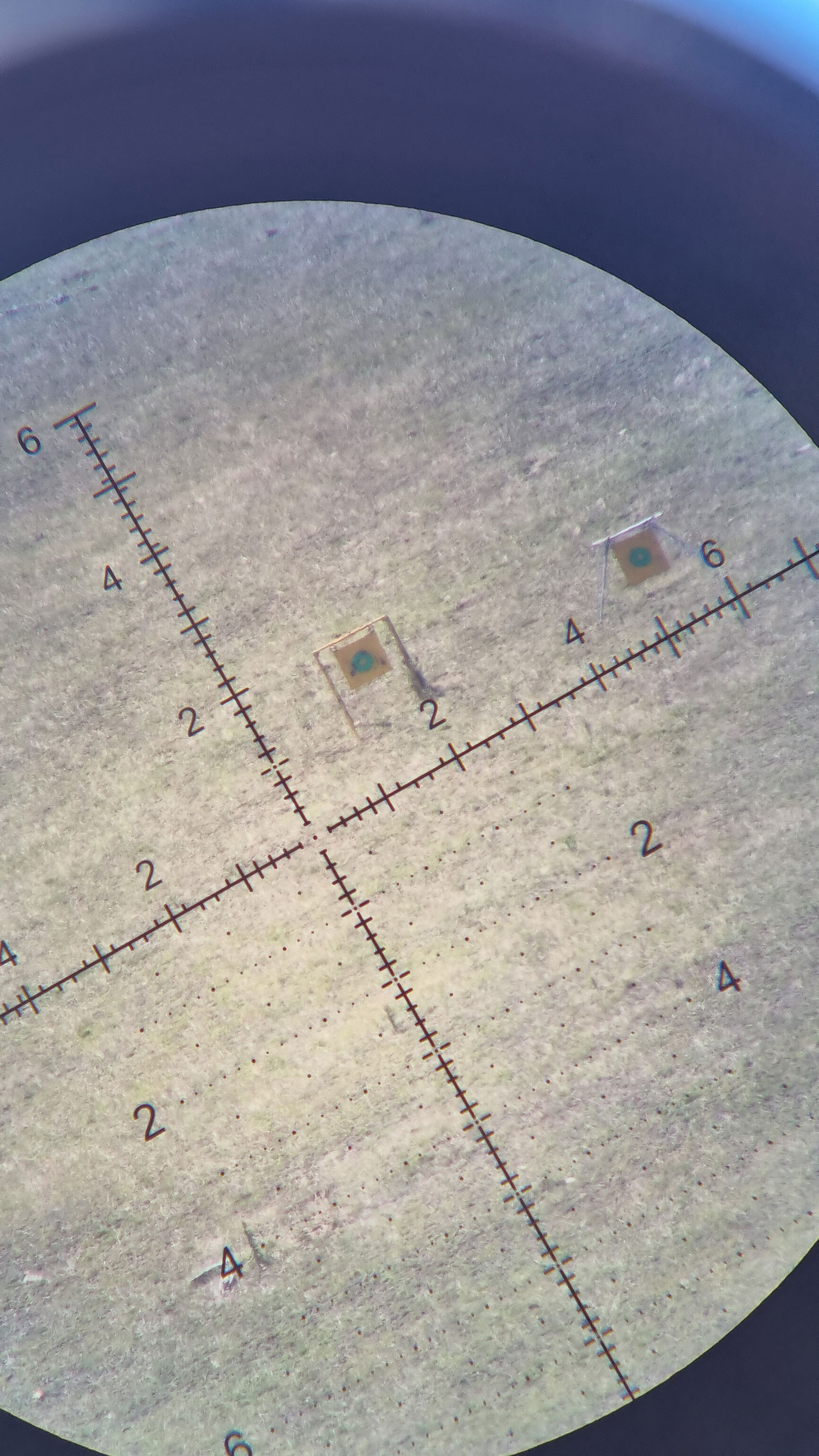

1500+ rounds of 50 bmg behind one of the DNT,s i tried to kill....not one issue.
When you factor in the price its superb value and performance!! (y)
Reactions: steve123
