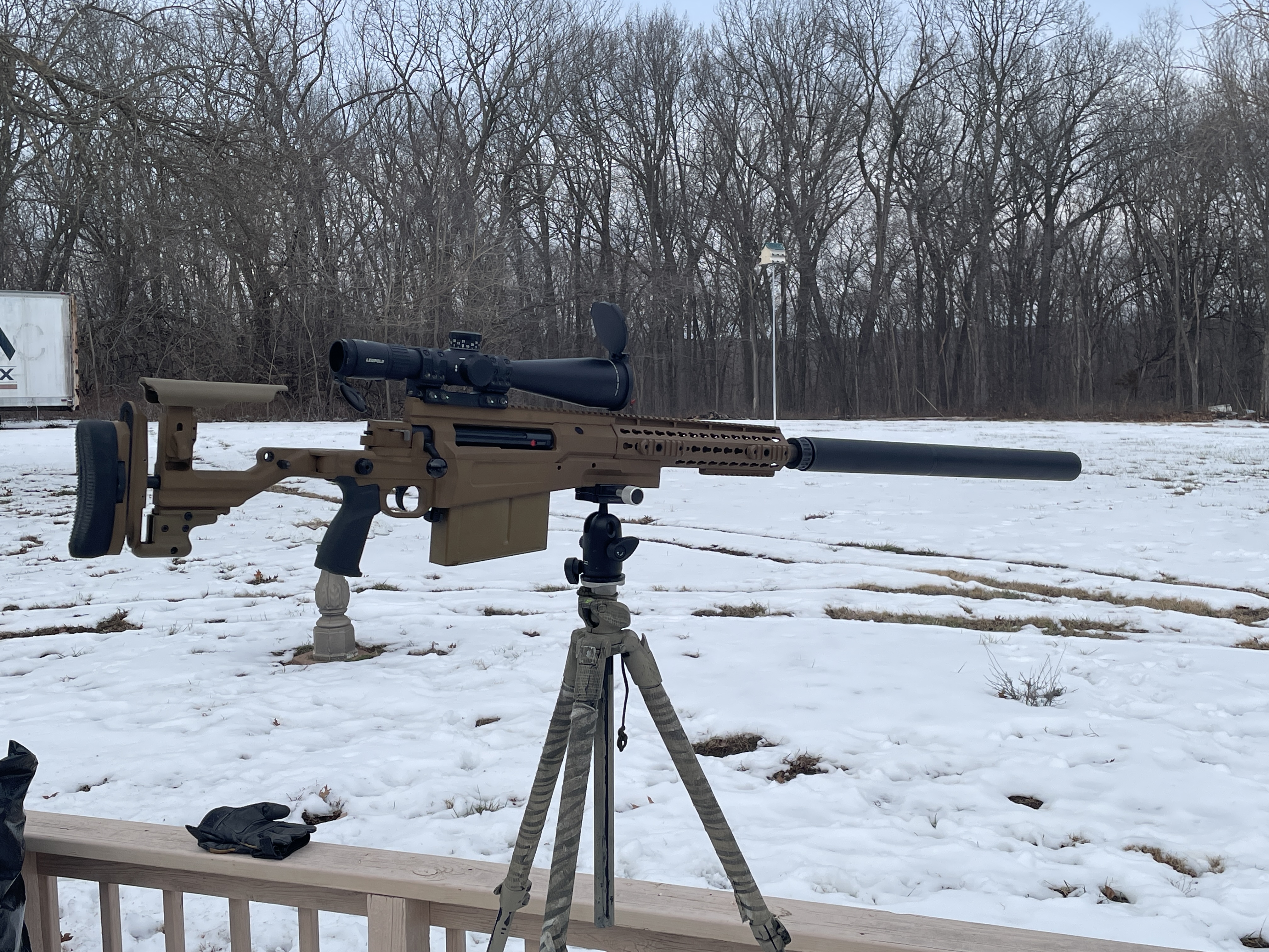

Our current dB #'s for the Ultra 50, on a 27" rifle, metering at shooter's ear, is about 139 dB if the supersonic crack is omitted (ie actual muzzle suppression). The peak from the SS crack at shooter's ear is between 140-141. This is with the muzzle brake on the end of the can. With the flat cap instead of the brake, it's at least 7 dB quieter @ SE

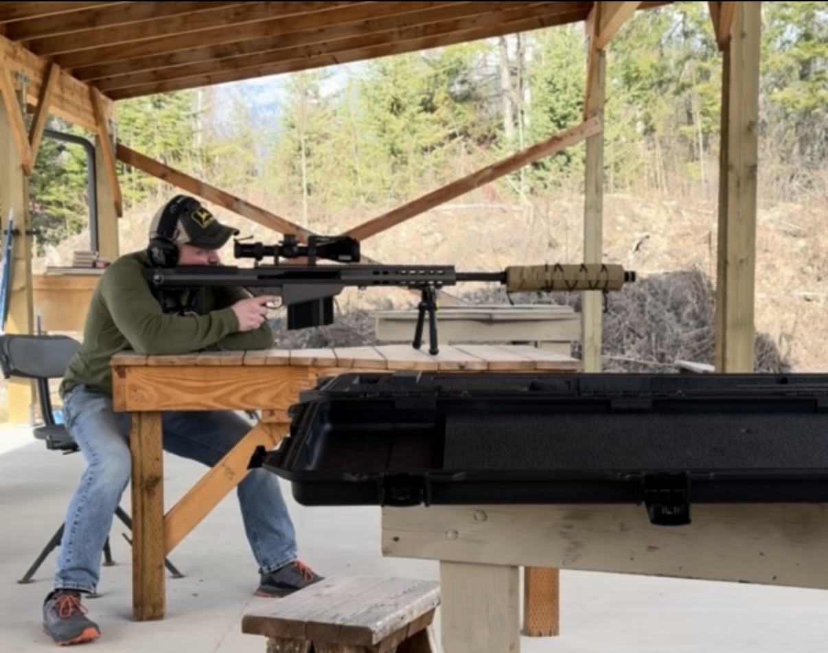

Hearing damage is dose dependent. What is the planned firing schedule? Where are you firing it? Are you in the free open feild? Are you going to be inside something, under a shade cover, next to walls, etc? Is the muzzle going to be less than a foot off the ground or 4-5' up on a tripod. Just be careful with people telling you or thinking things are hearing safe.
All of this matters in terms of hearing damage potential. The more reflective surfaces and the closer you are to them the more hearing damage potential there is.

We have some meter data that showed we were quieter even with the brake, but we need to re-do it due to some ambient problems. Nothing we've metered was even close to the long config with the flat cap (no brake), but nobody wants to shoot a 50 without a brake on the end of the can

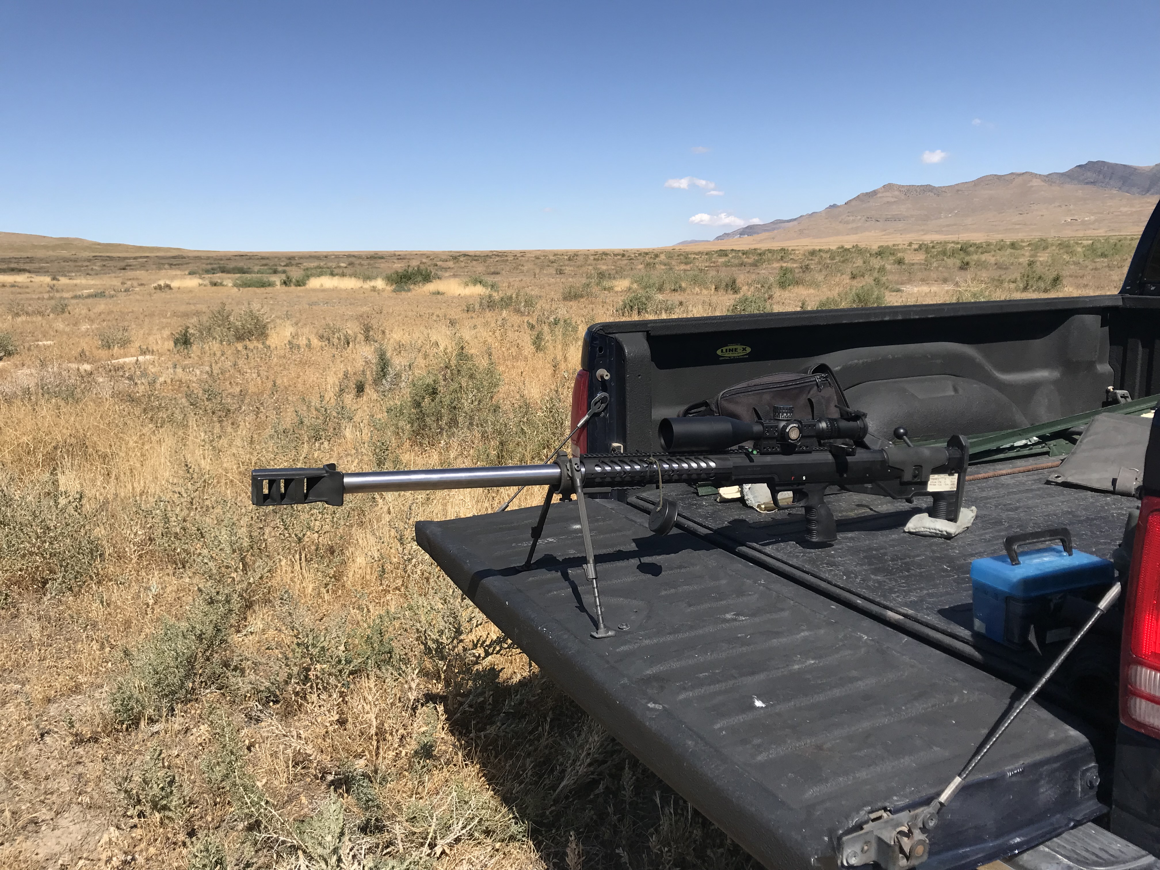

I added 11” to my DT barrel (40” total) and get another ~150 FPS. Cost $100 extra for the blank, and the foot of length
I can see specific scenarios where you may want it. I’d rather spend my $6000 elsewhere and get free velocity - and muzzle chaos farther in front of me that way
Next time I may go to 45” which is the barrel length John Browning designed the cartridge for.
Finally, if you’re planning on suppressing the factory DT barrel, look carefully at the threads. They’re using metric and it can be difficult to find a compatible muzzle device.

If you are going to shoot a lot of 50 from bolt guns, the only reason to NOT suppress it with an Ultra 50 RR (or another can that has similar overall sound & recoil performance... if any exist??) is for concerns of cost, or weapon overall length. The difference in shootability is dramatic, like a 100x difference in how many rounds you can shoot in a day and still retain good trigger presses. We are spotting our own hits at any distance (like including sub 300 yards) and an average taken from a variety of shooters the reticle movement off the POA is typically in the 1-5 mils range (depending on shooter, position, etc, etc).
Now, as far as why our demo gun runs short barrels, it's because we used the same AX ELR rifle with a series of barrels that we burned through for endurance testing, IE, worst case heat cycle with shorter-than-final-rating barrel length. While doing that we found out that at anything shorter than true ELR distances it didn't really make a big difference in ability to get hits, and obviously the rifle was a lot easier to cart around, which we do a lot with demo guns.
That said, a lot of departments, etc, have 50's for vehicle interdiction at what we (as SH forum members) consider close or even point blank distances. There is no need for long barrels in this application. All those cool guy photos of guys shooting 50's at boats (or specifically boat engines) from helicopters are at pretty close range -- and they are running short barrels on those guns already.
