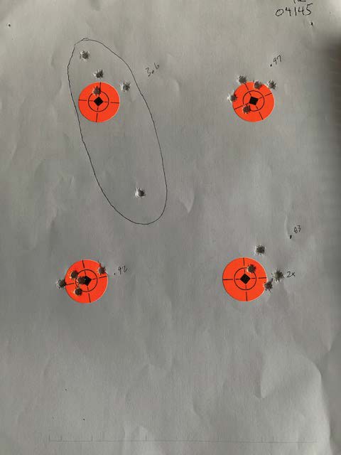

I was lot testing some Eley Tenex in my Tikka T1x the other day and this happened:
A 3.6 inch group? So what happened? I am pretty sure it wasn't me. Not that I don't yank a round off course every now and then but... This was the first 5 round string from this lot of ammo. The shots prior to this were also Eley Tenex but a different lot. I don't have a chronograph so no idea what the velocity was. I ended up ordering a different lot that performed better but this lot actually had pretty decent results excluding this group. Target was shot at 100 yards with very little if any wind. I feel like Eley owes me $.40. I have not shot much premium ammo. Is this something I can expect every now and then? I would add that prior to this the worst 100 yard group I had recorded was a 2.84 inch group from Norma Tac.

Two questions, Lee.
Was the aimpoint elsewhere on the target -- somewhere where it wouldn't be eradicated by the growing group of 50?
Why must the 3 shots outside the group be condition-related rather than surprises? Having one or more surprises in a box of CX isn't unusual. Having none is.

See that pic above? 5 shots into a 3/4 inch dot at 100 yards. Dot's are still there.
If y'er groups aren't impacting those dots with every shot, y'er not producing consistent sub-moa.
Not relative to y'er point of aim. Try it....watch those groups wander off and away from the dot.
So I figure with folks telling me sub-moa all day long with 5 shot groups, those dots ought to be gravy, right? 😎
Reactions: usafa77
I hunt as well. My groups do not drift. Only conditions move them.
I cannot shoot at a 1/4” dot more than a few shots. The dot is changed or gone.
I think you need an equipment check. Not being sarcastic. Something is wrong with your set up.
See my group above. 1/2” dot, 100 yards. This was just to check POI prior to a squirrel hunt. Point of impact is not an issue with a good rifle.
Posted this before. This is a pre hunt POI check.
Not selected groups or even groups at all. Just sat down and shot at the ranges as indicated on the target. Sitting, tight sling. Rifle is pictured.

The Lot was manufactured in 2022. I don't have wind flags but there is a lot of vegetation next to the range that I watch. The day was chosen specifically for lack of wind because the only thing I know about shooting in the wind at this point is to not do it. I had one failure to fire (on the first primer strike, it went on the second) but I don't remember if it was this lot number or not. I was concerned for a few minutes that I was getting light primer strikes but I didn't have other issues as I continued to shoot. I can't definitively say it wasn't the wind but I don't think it was.
I would suggest getting flags. it will really help
Lee
Two questions, Lee.
I had a left to right wind coming from around 10-11 o'clock my POA was just about 10-11 I got caught with a let up and that is why 1 shot was exactly where my POA was. second time the wind switched to a 9'o clock and that is why the 2nd shot went right across from the 1st out shot. the 3rd was wind speed change I didn't see and the reason the 3rd shot is about 4'o clock.

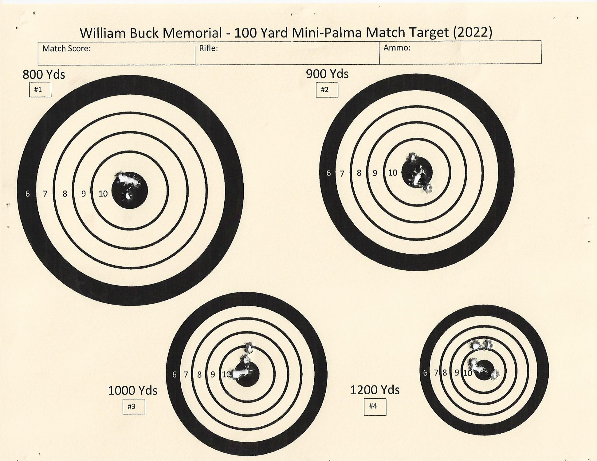

I think I already know what the rifle can do based on this target I shot the same day I shot the 50 at 100
the 800yd. target has a 3/4" dot and is the biggest of the 4 the smallest dot being around 3/8"
the other target with the groundhog silhouette was shot same rifle same lot of CX in 2019.
But this is the game I like and play 1 shot per bull no walking in the POI yes, it is only at 50-yds. with a completely different lot of CX think it is easy?
Lee

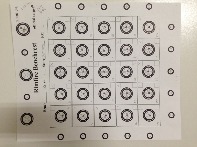

Nope, I don't Lee.
The Grid is a one shot - one dot target and it kicks my butt.
The reason being is it's not groups and you have to hit what you aim at.
The 3/4 inch dots are not about groups, you end up with groups,
but the true objective is to hit what you aim at.
No excuses, so far both methods indicate I need much better ammo
and much more work with judging hold off and wind.

I forgot about the grid. yes, ammo is one of the key parts of the equation. here is another is the rifle really in tune?

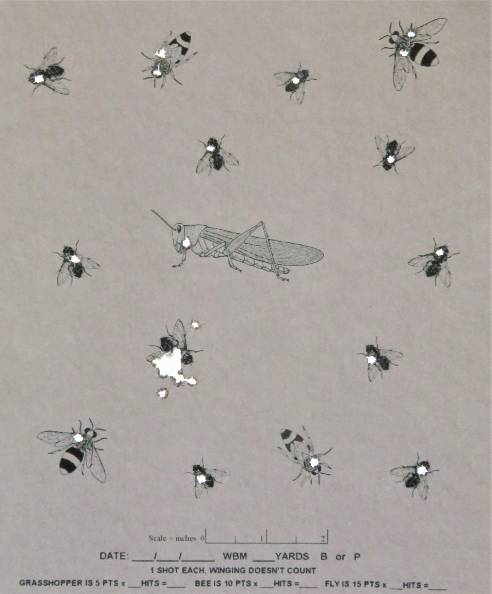

Exactly . . . "hit what you aim at." That's why I enjoy and get a kick out of shooting like this (trying to get head shots @ 50 yds.) :LOL: :
But straight, look at all that wasted ink!
You could accomplish the same thing with a Grid,
then save on target purchases or printer supplies. ;)
