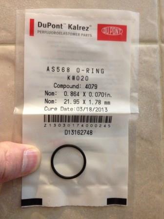

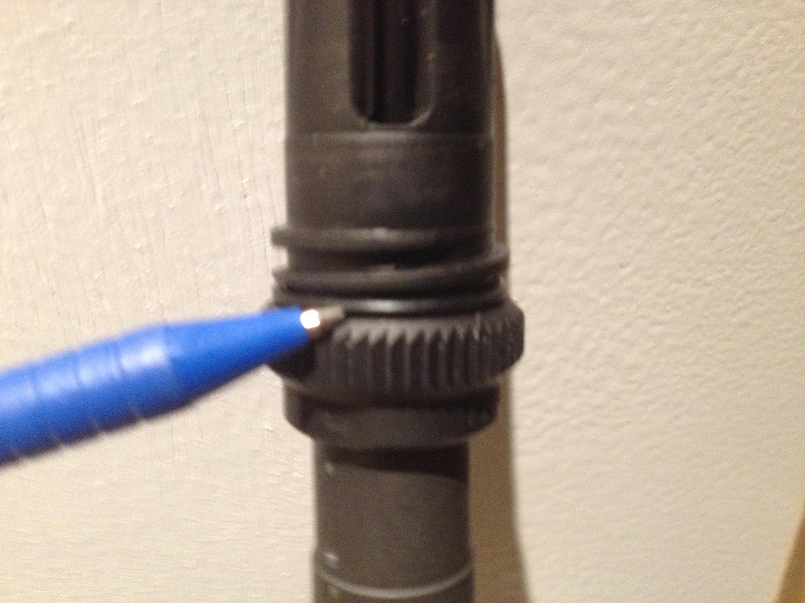

Here's what I'm using now...with some pictures included.
020 Kalrez Perfluoroelastomer O-Ring, 4079 Compound, 75A Durometer, Round, Black, 7/8" ID, 1" OD, 1/16" Width (Pack of 1) $40.73 on Amazon

Holy crap, $40 for a single o-ring? How long does it last before needing to be replaced?
That o-ring should work great if you're firing it on a bolt gun. I might pick one up.
However I'd avoid it on a rig with a high rate of fire. Dupont only tested the material to 600*F. It can withstand higher temperatures in short bursts (although it did not define what temp that is or how long those bursts are) but cans usually maintain their heat for a long time. Still, a slow fire bolt gun in a .308 caliber shouldn't get much hotter than 600 degrees (at least not for very long)
http://www2.dupont.com/Kalrez/en_US/pfo/assets/downloads/Kalrez 4079AMS.pdf

Interesting using the O ring, but I rather polish the mount a little bit to get it to the next lockup tooth. What I would worry about with the O ring is melting point temperature and lockup vs recoil wiggle.
Plus fine sandpaper vs a $40 O ring.. sandpaper is cheaper.
View attachment 30216View attachment 30217View attachment 30218
Don't know how I missed this. I do my best to sh*t all over most any post about AAC cans - esp. the POS SDN7.62-SD - whenever I can.
THIS looks promising. 600 degrees F is 50% higher than Viton (400 degrees F).
Interestingly, AAC uses Viton seals on the Evolution-9 can. I got mine without seals and ordered a bunch from their recommended source.
No one answered the phone or emails for me for this one either.
What DID happen is I sent the 7.62 can back, they gutted it, fitted a new QD mount to the back and internals (there were baffle strikes) and sent it back with a dozen different flash hiders. I've found ONE that works - marginally - I usually get 2-3 rounds on target 1/2 MOA and then POI shifts and it's like a long-range shotgun 2-3 MOA dispersion.
What the hell, in for a penny, in for a pound, $40 won't kill me and it might make this can more useful.

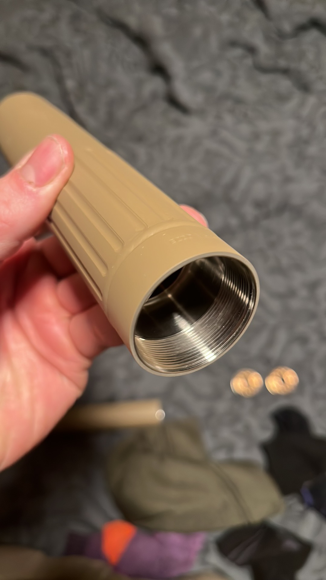

I know I’m a little (A LOT) late to this conversation. But I know exactly what you’re talking about. I had the same problem for a whole year when I first got mine. And for most of that year, I didn’t even know it was happening. (Luckily I had no baffle strikes) so the fix is simpler then you’d think. So I got some muscle on me, and I grabbed the Can and twisted with everything I had. It took a couple tries. But it finally clicked to the last tooth. And now when ever I twist it on, I just give it a lil extra Emph! Then BAM! on all the way
Send to Ecco and save yourself the hassle
Kinda frustrating to take your brand new can and mount to a dowel and drill with sand paper to make it work.
As mentioned above prior to just getting it corrected.
I sanded down the surface it locks onto to allow it to snap over the next tooth.. eventually the lockup lever snapped on mine.

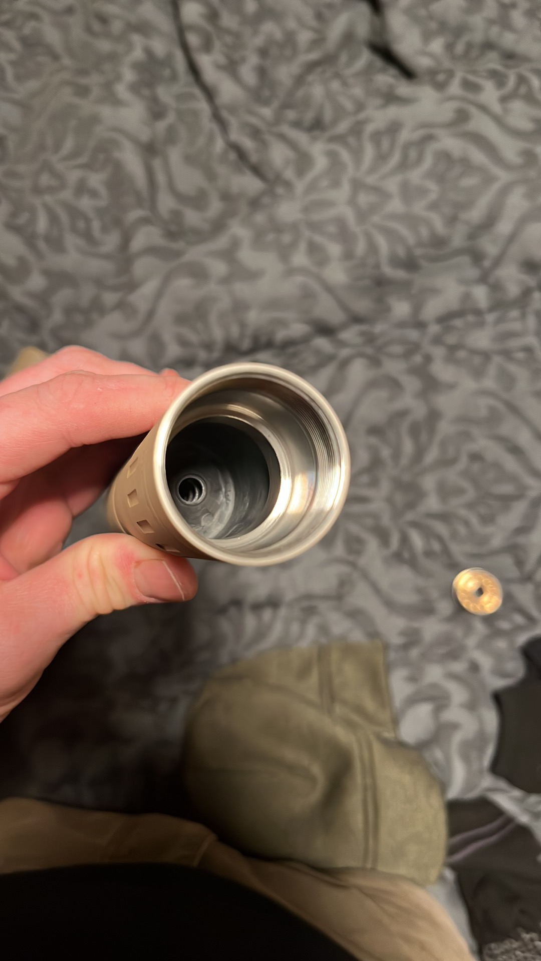

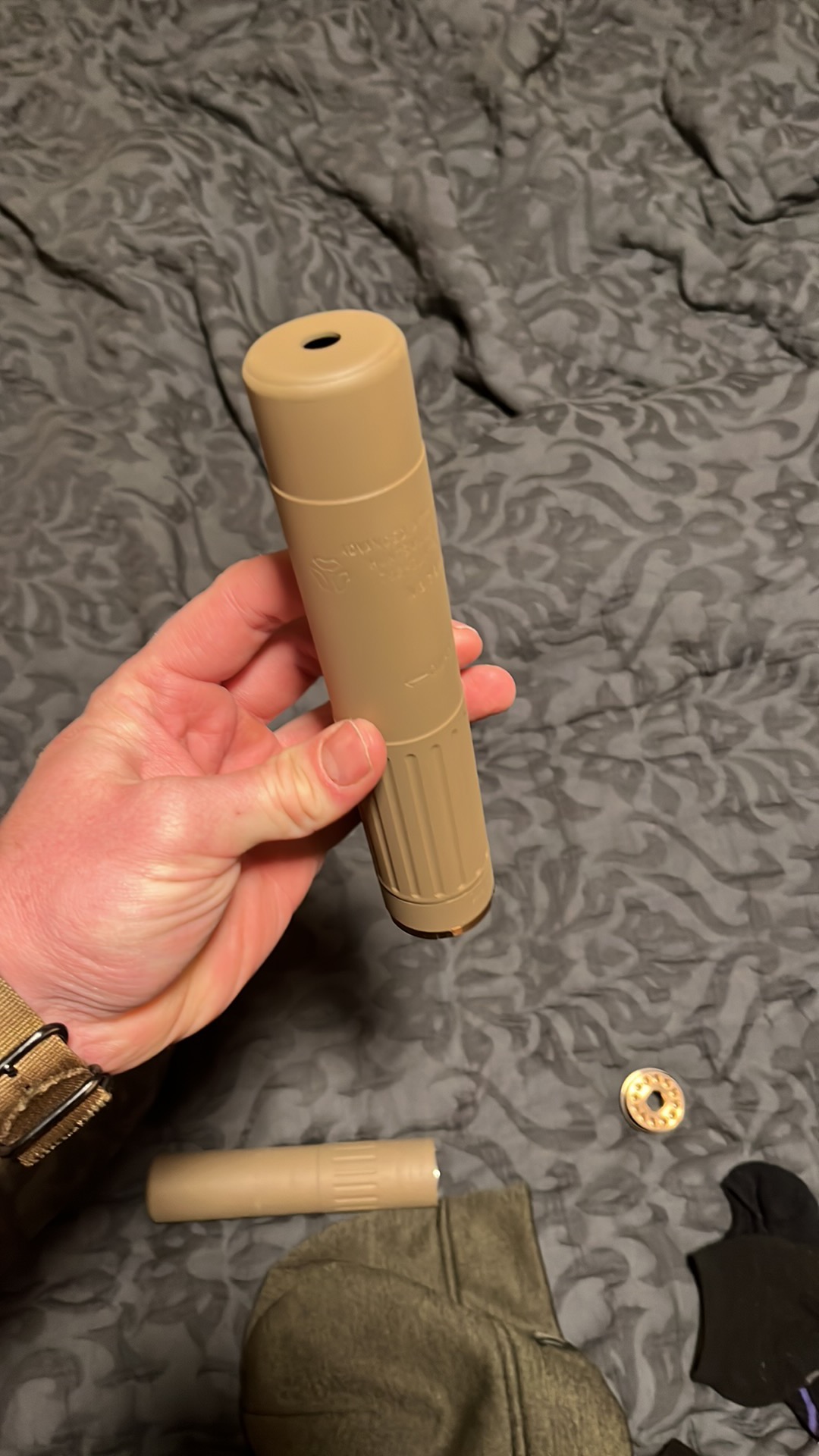

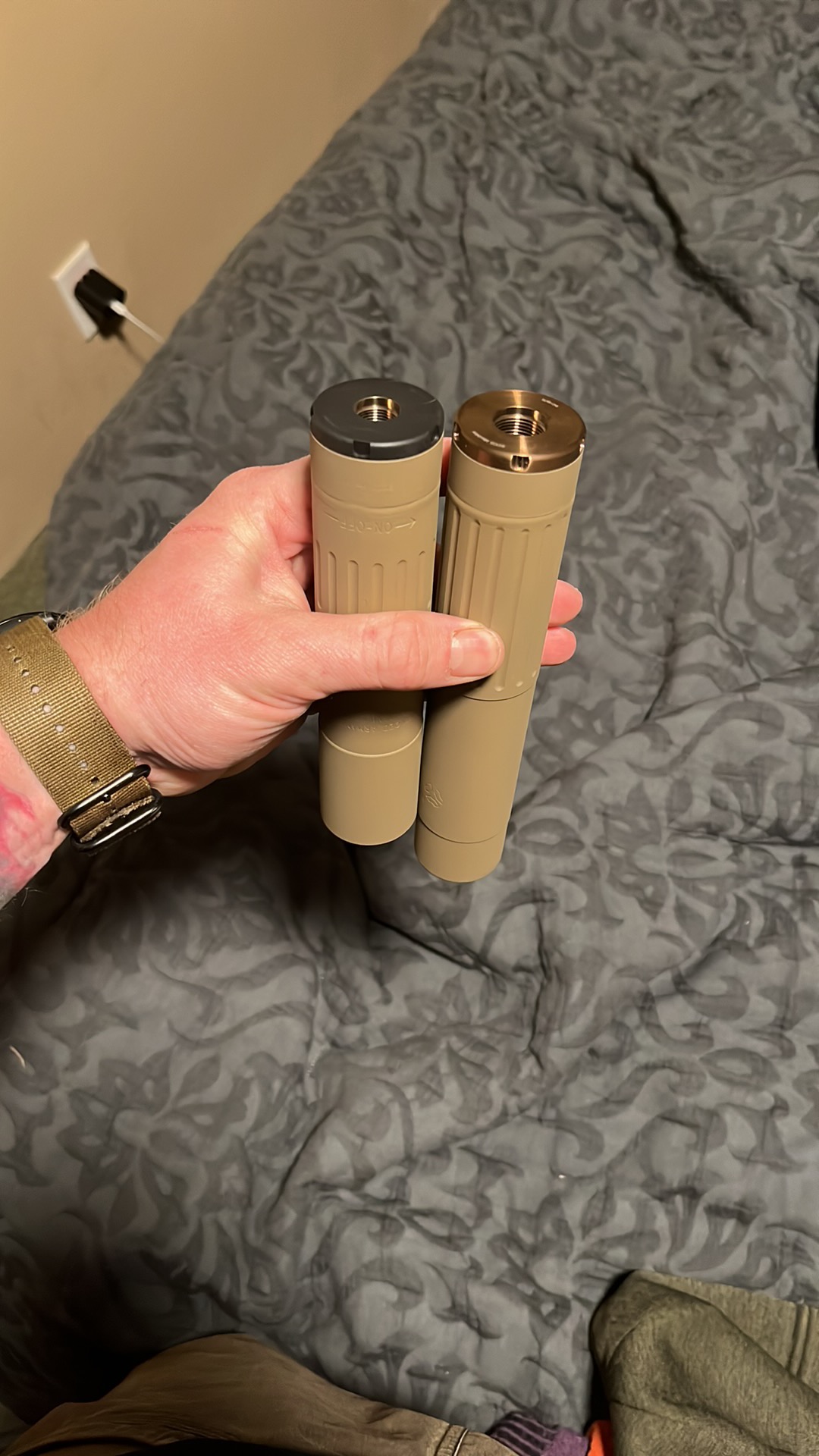

I put my 556 on with a strap Wrench and was sick of having it solely on one rifle. They had to cut it off with the mount on. As it was in there so tight it unscrewed the muzzle device.
