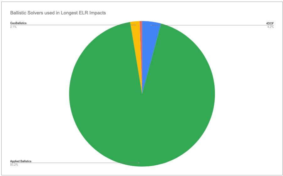

If you'd like to see what ELR competitors are using, check out the stats that Brian Wink maintains in the "Safety First Tactical ELR" group on Facebook. Shows all gear including ballistic solver used for longest shots in competition. Lots of useful data points there.
