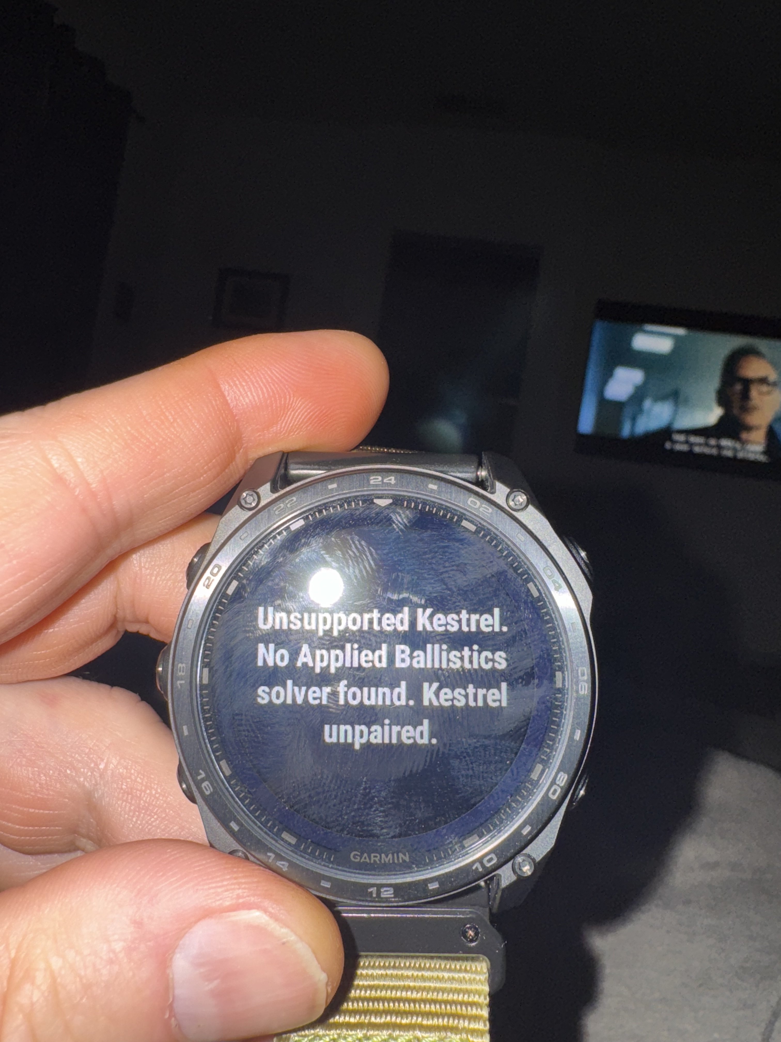

The issue I am facing now is I cannot get any live wind data from the Kestrel.
I tried pairing the Kestrel directly with the watch, but I could not add it as an AB device under “Connectivity->Sensors->Applied Ballistics”.
I tried using both “PC Mobile” and “Device Connect” on the Kestrel but they both result in “ No Sensor detected”. However I could add it as just a generic sensor.
But after I did that I didn’t get any wind info and after a few minutes, AB booted the Kestrel! Details in the pic, but my Kestrel 5700X Elite has an AB Elite license. Not sure what is going on there with the solver error.
I was able to pair the Kestrel with my phone in AB Q, but even when it’s active I cannot get any wind data directly in AB Quantum.
This is the last hurdle, hopefully someone knows why I am not getting the wind data in AB Q, or knows how to properly pair the Kestrel with AB directly on the watch?

You may need to reboot the kestrel, full battery removal and stuff. I saw this issue in ABQ before, rebooting the kestrel fixed it and let me push the button in ABQ to get data live.

I was having similar intermittent and weird connection issues with my Kestrel 5700 Elite a few years ago. After troubleshooting online and over the phone with Kestrel support, they had me send it in and they determined the Bluetooth was defective. Then they wanted me to pay full price for a new one. I gently declined and eventually after some back and forth, they replaced it free of charge. Maybe reach out to Kestrel directly.
I’m getting wind and environmental data in ABQ now, thanks to @sidetoss20 recommendation.
I pulled the battery out of the Kestrel and let it sit for a few minutes and put it back in. Viola! WIND DATA!! Thanks man!
Also AB Support responded on the error about the watch and Kestrel pairing and is directing me to contact Kestrel on that one.

It’s possible the battery reset fixed the Garmin connectivity as well. Make sure you follow these instructions specifically: https://support.garmin.com/en-US/?faq=jz6wciNu303lc9nSPiyUs9
