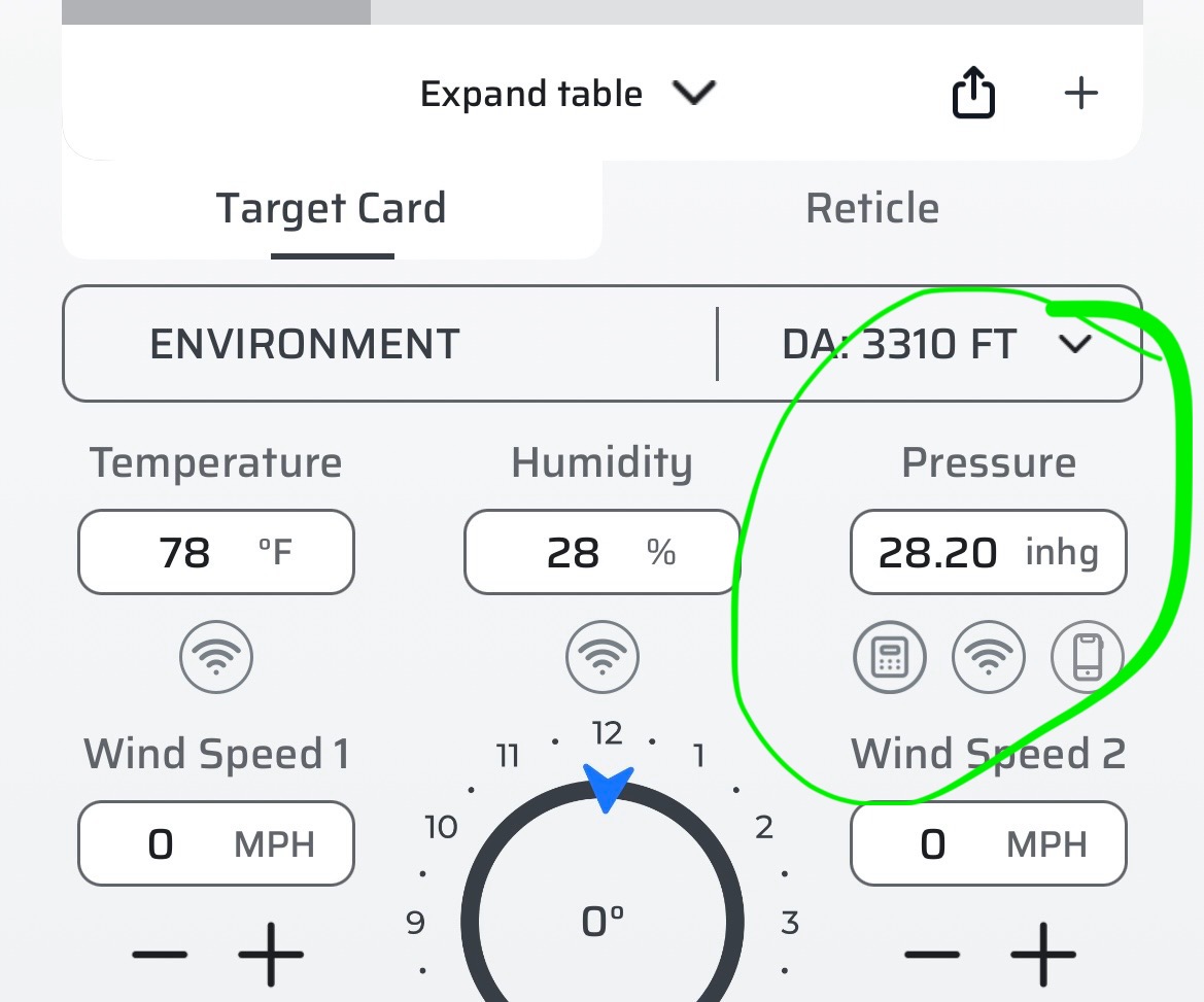

Pressure.
Im a little confused. Maybe a lot confused. Between my phone weather app, couple websites, and what i can populate in ABQ, pressure vary quite a bit. Its easy to always hit the button in the ballistic app. But why does the info vary from 28.2 to 29.67 on these different sources? Is it station pressure vs adjusted pressure for sea level?
I live at around 1300 feet elevation in idaho. Shoot between 1200 and 3200 feel elevation.
I understand that regardless of the other apps, if ABQ always pulls consistent numbers i should be fine, and disregard the others. Right?
Maybe there is a good resource to watch or read that would help me understand?

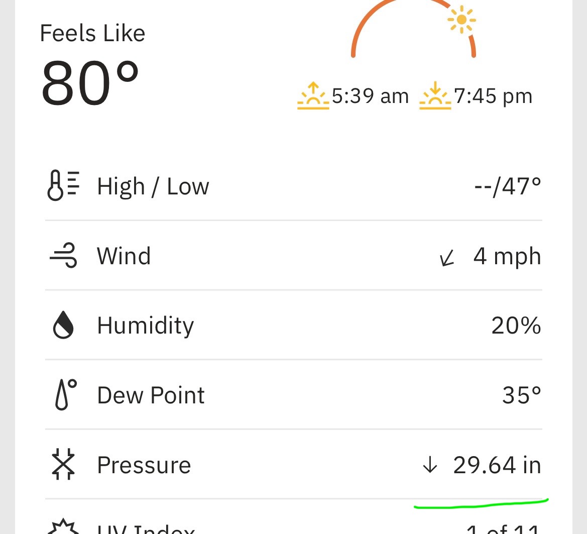

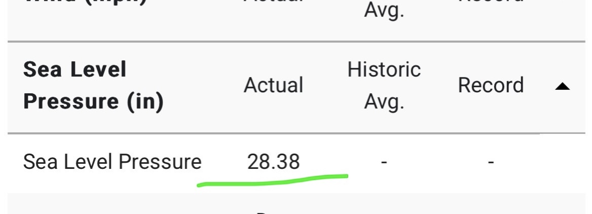

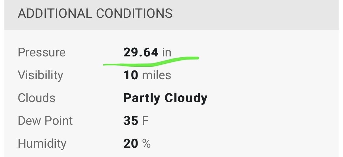

Here are the results from locally this afternoon.
ABQ
Weather underground
Iphone weather app
Another website
The weather channel website
Thanks.
Pressure.
ABQ
Weather underground
Iphone weather app
Another website
Thanks.
Some of these are Barometric Pressure, some of them are Station Pressure. Something to consider is that Barometric Pressure is calibrated for the location of the sensor. So it is location specific. If your physical elevation is different from theirs, then their is a variance to account for (but most outputs or readings are not going to do this). Our app can take your GPS location, the Barometric Pressure of the weather station, and back convert it proper for ballistics.
Ok. So ABQ is pulling the station pressure from somewhere?
Combined with temp, and humidity for the density altitude.
Thanks!
Thanks!
If the weather station reports in barometric pressure, the app will convert it. If the weather station reports its using station pressure the app will leave it untouched. Their are rare cases where a weather station is programmed incorrectly or reporting incorrectly. Also, when doing the conversion for barometric pressure, their is going to be some error potentially. Since barometric pressure is calibrated to the exact altitude of the weather station which may or may not report its current elevation, but none the less. If your elevation is different from the weather station elevation their can be some noise.
That makes sense. Thank you!

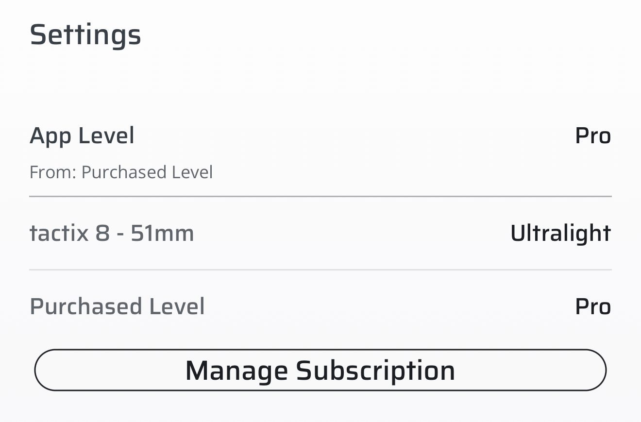

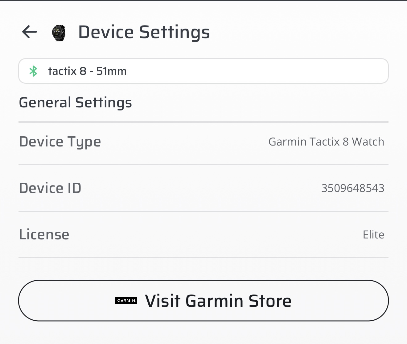

Using a Tactix 8 Solar Elite, isn't that supposed to include the Elite AB license? In ABQ it is showing that my App Level is Pro and the tactix 8 - 51mm is Ultralight. So I can only sync 5 profiles.
ETA : Even more annoying. The watch shows as having the Elite license on the devices screen but in the app settings screen it shows Ultralight.
Added pics.
Added pics.
This depends on the watch, but your app level is Pro so their is nothing to upgrade. Some Tactix 8s are Ultralite, and some are Elite. If this one is the Elite SKU PART NUMBER010-03407-10 then use the in app support function so we can see the logs and what the watch itself is reporting as.
The Devices tab shows it as Elite. I'll put in an in app support ticket.

You need to login to cloud sync in the settings. Once logged in, restart your phone. Check to see if it updates. If it does not, send in a support ticket through the app with as much detail as possible.

Just tried all that:
- Logged in for Cloud sync using the same Google account as used for Play Store
- Checked the app, "Subscription level: Ultralight"
- Restarted the device
- Checked the app, Cloud sync logged in, subscription level is still "Ultralight"
- Completely removed the app
- Reinstalled the app
- Logged in again with the same account
- Still the same: Cloud sync logged in, subscription level "Ultralight"
I will fill in a support request by e-mail to [email protected], with all technical details.
