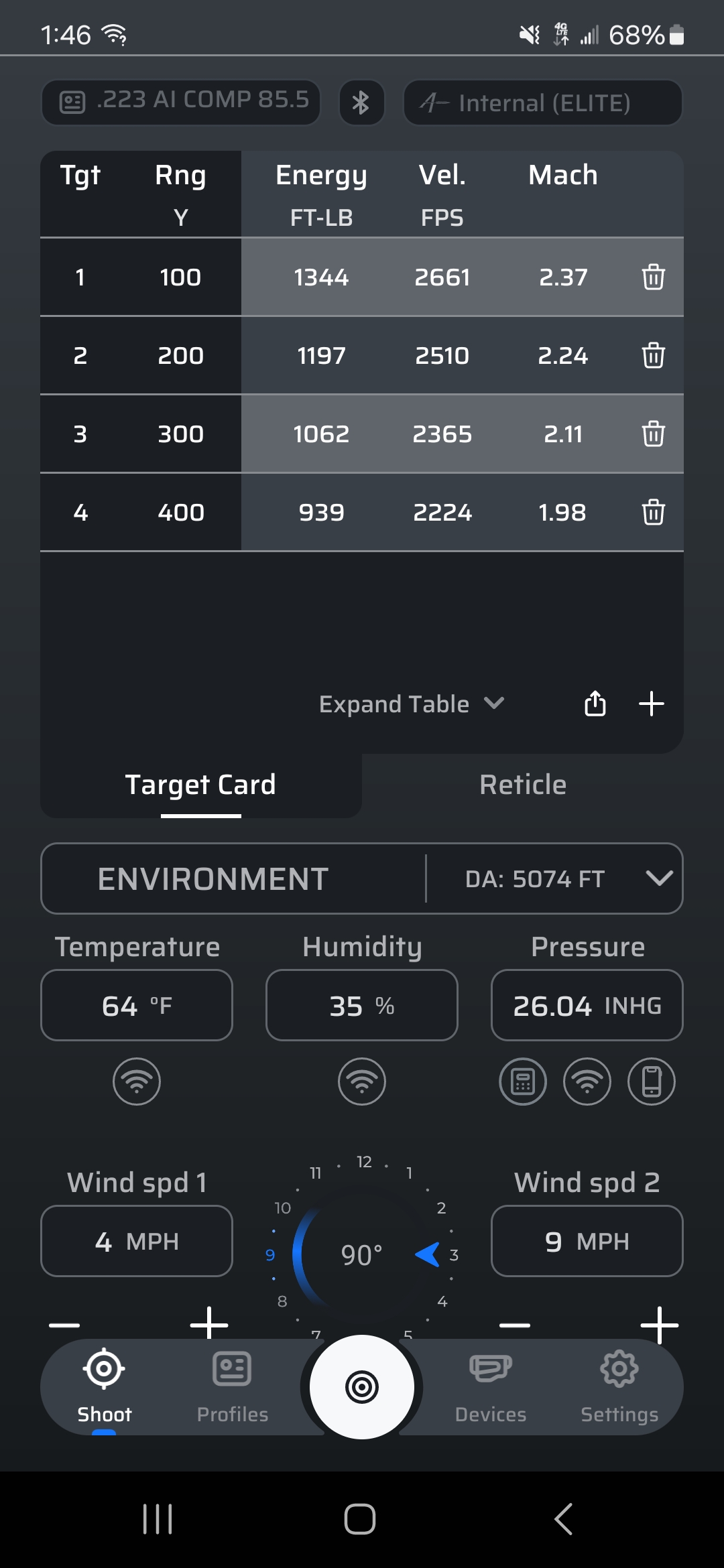

I want to follow up on this. It seems that once a "target specific" wind set has been entered for a target, it will not update with the rest of the card when you deselect it and try to update the whole card. I'm not sure if this is how it's designed to work or if it is a bug.
I was at a match today and noticed that my wind wasn't making sense for a couple of targets. I must have fat fingered and edited a wind value before deselecting the individual target and updating what I thought was the whole card.
If this is a feature then I think some sort of visual indicator that the target is de-linked from the rest of the card would be handy. From how i read your post though, it sounds like this isn't how it should be working.
Messing with it further before hitting post. Pretty sure this isn't functioning as it should.
If I set up 4 targets, and deselect them before modifying wind values they will all update together.
if I select a single target and change the wind angle 180 then deselect to update card, the other 3 targets will update but the modfied one will not.
if i change a 2nd target to have a 180 wind value and then deselect and change wind speeds it will only adjust the wind speed on the target i just modified and no other.

1) The target card is designed to work like this. If you individualized an input on the target card, it should not delete that input when you input general data unless you delete/reset that.
2) Their is an indicator on the target card, scroll to the right. Icons will light up for each of them. We have a video coming out on this, this week.
3) It is working as intended. We do not want to overwrite custom target values.
4) You can always scroll to the right, tap on the ENV, TGT, or WEZ button if they are lit up, and remove custom values.

Scroll to the far right on the Target Card. It says ENV, TGT, and WEZ. When those are lit up, the data for that target is individualized.
This is as far right as i can get on the target card.
Good chance im looking in the wrong place?

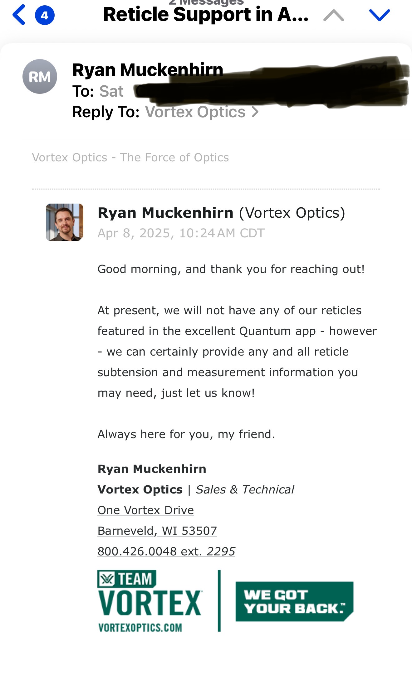

Heads-Up for Vortex Users: No Reticles Coming to AB Quantum (For Now)
I reached out to Ryan Muckenhirn at Vortex Optics regarding support for their reticles in the Applied Ballistics Quantum app. Unfortunately, Vortex currently has no plans to make their reticles available in Quantum.
Ryan was helpful and mentioned they’re happy to provide any subtension and measurement info if needed, but as of now, Vortex users won’t find their reticles in the app’s library.
If you’re a Vortex user and would like to see their reticles included in AB Quantum, I strongly encourage you to shoot them an email and make your voice heard. The more folks that ask, the more likely they are to consider it. Please see attached email from Vortex. Regards
